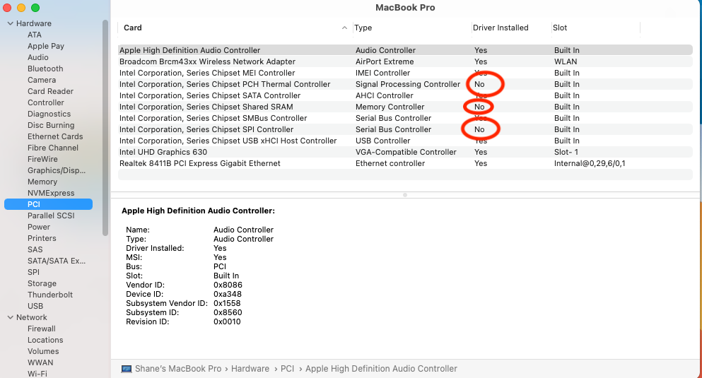

SavageAUS Posted August 6, 2020 Share Posted August 6, 2020 (edited) Hi all, I am hoping someone can help me out and give me an idea on why sleep is not working on my laptop. Apple menu sleep and lid sleep both are not working. I believe i have CPU power management correct and display brightness works. This behaviour happens on both Catalina and Big Sur so it must be a config / ACPI problem. Edited August 13, 2020 by SavageAUS Link to comment https://www.insanelymac.com/forum/topic/344770-laptop-will-not-sleep/ Share on other sites More sharing options...

d5aqoep Posted August 13, 2020 Share Posted August 13, 2020 (edited) 1 hour ago, SavageAUS said: Booting windows isnt an issue without a DSDT but with it i can't. New files atached. I had to change the scope of the SSDT. Still no AppleBusPowerController in ioreg for Big Sur Still no sleep. Send me Shanes-MacBook-Pro.zip Sleep issue 100% means your SSDT-USBX-EC.aml was not correct for your system when you did USB Map. So even your generated USBPort.kext might be faulty as well. For SSDT-SBUS-MCHC.aml you still want to follow this guide to make sure it's correct. https://dortania.github.io/Getting-Started-With-ACPI/Universal/smbus-methods/manual.html#edits-to-the-sample-ssdt All your issues revolve around having the correct SSDT-USBX-EC.aml. Search google for your laptop's chipset hackintosh guides and use their ready made ssdt. Then use USBInjectAll.kext and enable Port Limit patch and start again. Use hackintool to make sure all ports show as XHC and not XHC1 or XHCI. Otherwise use those respective ACPI renames to change them to XHC. Last but not least: Try making a new USBPorts.kext in Hackintool with current SSDT-USBX-EC. Make sure you tag USB3 ports, USB 2 ports and USB-C+sw accurately. Delete non-required ports. Keep Bluetooth like Broadcom as internal instead of USB 2 as people have documented sleep issues otherwise. Edited August 13, 2020 by d5aqoep Link to comment https://www.insanelymac.com/forum/topic/344770-laptop-will-not-sleep/#findComment-2734086 Share on other sites More sharing options...
