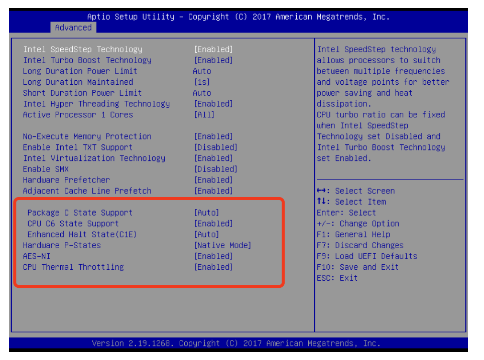

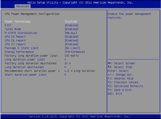

yapan4 Posted August 1, 2020 Share Posted August 1, 2020 (edited) Hi, @MacXZ Do your BIOS has option "EIST Coordination" or "P-State Coordination" or "P-State Control" or something similar(please see in CPU --> CPU Power Management) ? For example "P-STATE Coordination" on attached picture Spoiler Edited August 1, 2020 by yapan4 Link to comment Share on other sites More sharing options...
MacXZ Posted August 2, 2020 Author Share Posted August 2, 2020 (edited) 10 hours ago, yapan4 said: Hi, @MacXZ Do your BIOS has option "EIST Coordination" or "P-State Coordination" or "P-State Control" or something similar(please see in CPU --> CPU Power Management) ? For example "P-STATE Coordination" on attached picture Reveal hidden contents Yes! Did u mean hardware P-states? Quote Hardware P-States Disable: Hardware chooses a P-state based on OS Request (Legacy P-States) Native Mode: Hardware chooses a P-state based on OS guidance Out of Band Mode: Hardware autonomously chooses a P-state (no OS guidance) A panic log with stack info.https://pastebin.com/qpyBjZnC Edited August 2, 2020 by MacXZ Link to comment Share on other sites More sharing options...
yapan4 Posted August 2, 2020 Share Posted August 2, 2020 (edited) @MacXZ First of all, I want to explain: I am the same user who has the same or a similar problem. I don't know the solution and I'm just trying to make the discussion of this problem more active. The same or similar KP noticed on ASUS C422 https://www.insanelymac.com/forum/topic/335193-help-installing-mojave-on-xeon-w-2175-and-asus-ws-c422-mobo/ , ASUS C621 https://www.insanelymac.com/forum/topic/344144-xeon-w-3275-and-c621-installation/ and now on your ASrock. Motherboards Supermicro do not have this problem. Experts are still silent, so I try to find some solutions on our own. I think the reason lies in the missing BIOS settings on ASUS/ASrock motherboards. The required options can be hidden and simply have default values that are not suitable for macOS. The AppleIntelInfo report dumped from the original McPro 2019 is taken as a sample. I'm not sure about your BIOS settings(probably are the same as yours), but have you tried different options Hardware P-States? Always KP? Something is changing in AppleIntelInfo report, in particular 1AA MSR? AppleIntelInfoMP71.txt AppleIntelInfoASUS_C422.rtf Edited August 2, 2020 by yapan4 Link to comment Share on other sites More sharing options...

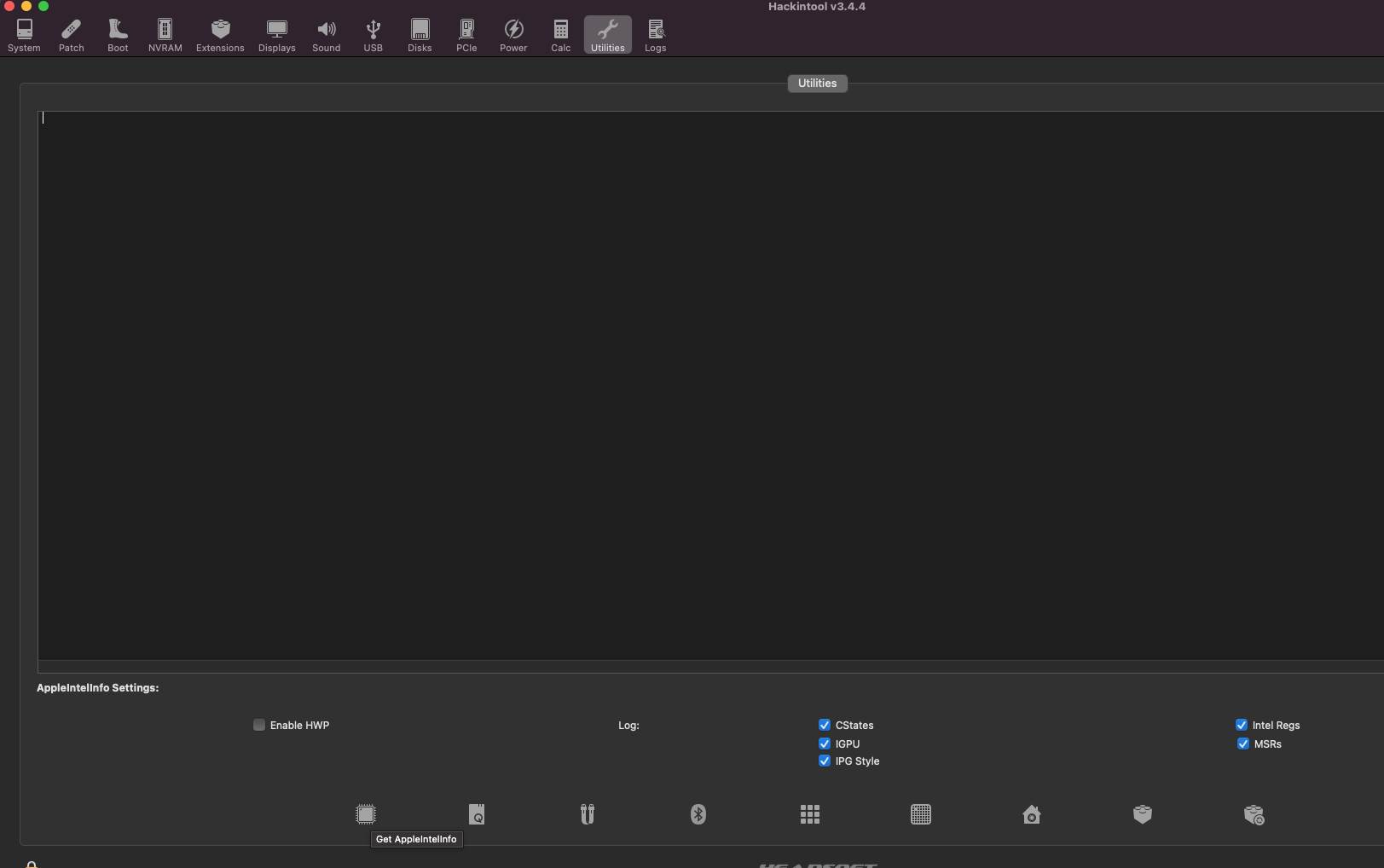

yapan4 Posted August 2, 2020 Share Posted August 2, 2020 (edited) Please post your AppleIntelInfo (Hackintool.app-->Utilities-->AppleIntelInfo) Spoiler Edited August 2, 2020 by yapan4 Link to comment Share on other sites More sharing options...
MacXZ Posted August 2, 2020 Author Share Posted August 2, 2020 22 minutes ago, yapan4 said: In Open Core Quirk AppleXcpmExtraMsrs must be until your BIOS has locked MSR 0x1AA. Otherwise you will not be able to boot macOS at all. I have patched BIOS with unlocked MSR 0x1AA so I do not need this Quirk in OC or analogical kernel patch for Clover. But you're right - KP during wake from sleep is somehow related to this patch. Okay... How to unlock MSR 0x1AA? I think I need a BIOS patch first. 12 minutes ago, yapan4 said: Please post your AppleIntelInfo (Hackintool.app-->Utilities-->AppleIntelInfo) Reveal hidden contents I have tried hackintosh, but nothing happened. Maybe I need disable SIP first. Then I use AppleIntelInfo.kext directly, but an panic occured. https://pastebin.com/P81CCb0G Link to comment Share on other sites More sharing options...
yapan4 Posted August 2, 2020 Share Posted August 2, 2020 Yes, SIP must be disabled. Link to comment Share on other sites More sharing options...
