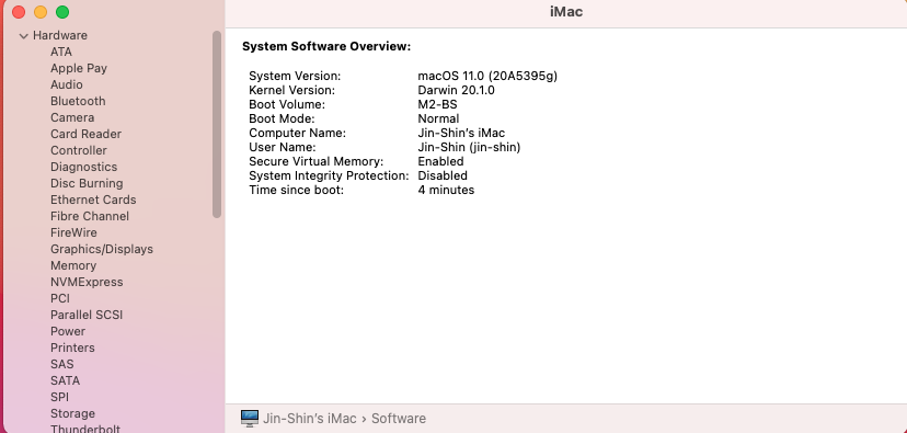

jsl2000 Posted August 28, 2020 Share Posted August 28, 2020 (edited) 11 hours ago, Franziska1993 said: Hello jsl2000, I got it, I can boot from USB Stick into Big Sur Beta 1 with my Nvidia GT710. I also have downloaded Public Beta 4, I will report. Then I will try to install Beta 1 first on separat SSD. Greeting from Germany..... Congratulations for your success because my AMD hackintosh FX-6300 can not boot with GT 710 or GT 730 to desktop. If you did it, maybe I need your settings for comparison to fix it. In my other Intel CPU hackintosh GT 710 or 730 can work with SMBIOS iMac19,1 or iMac15,1, but FX-6300 seems only working with iMacPro1,1. What SMBIOS are you using now ? Edited August 28, 2020 by jsl2000 Link to comment https://www.insanelymac.com/forum/topic/344335-amd-experimental-patches-macos-big-sur/page/2/#findComment-2735610 Share on other sites More sharing options...
Franziska1993 Posted August 28, 2020 Share Posted August 28, 2020 9 hours ago, jsl2000 said: Congratulations for your success because my AMD hackintosh FX-6300 can not boot with GT 710 or GT 730 to desktop. If you did it, maybe I need your settings for comparison to fix it. In my other Intel CPU hackintosh GT 710 or 730 can work with SMBIOS iMac19,1 or iMac15,1, but FX-6300 seems only working with iMacPro1,1. What SMBIOS are you using now ? I'm using iMacPro1,1 , but I will try iMac19,1 and iMac15,1. On Catalina I used iMac14,2 because I use NVIDIA GT710. I get to the Installer. But after I start the Installer, after 2 Minutes it crashes with a Error Message, then it showes a Shutdown Message like when you make a normal shutdown. This happens in Beta 1 and Public Beta. By the way, what do you have for a Motherboard for your FX 6300 exactly? Is it the asus m5a78l-m, -LX, _LX3 or the Mobos with UEFI BIOS like M5a97 r 2.0? I'm asking, because I'm thinking about an AMD GPU like RX 560. But I'm not sure if it works my ASRock or ASUS M5A78L-M LX(3) both with legacy BIOS. Now back to the Topic: I will try an other SMBIOS like iMac19,1 and iMac15,1 or with later "nv_disable=1". When you start your Installer USB Stick, do you start with enabled SIP? Link to comment https://www.insanelymac.com/forum/topic/344335-amd-experimental-patches-macos-big-sur/page/2/#findComment-2735663 Share on other sites More sharing options...

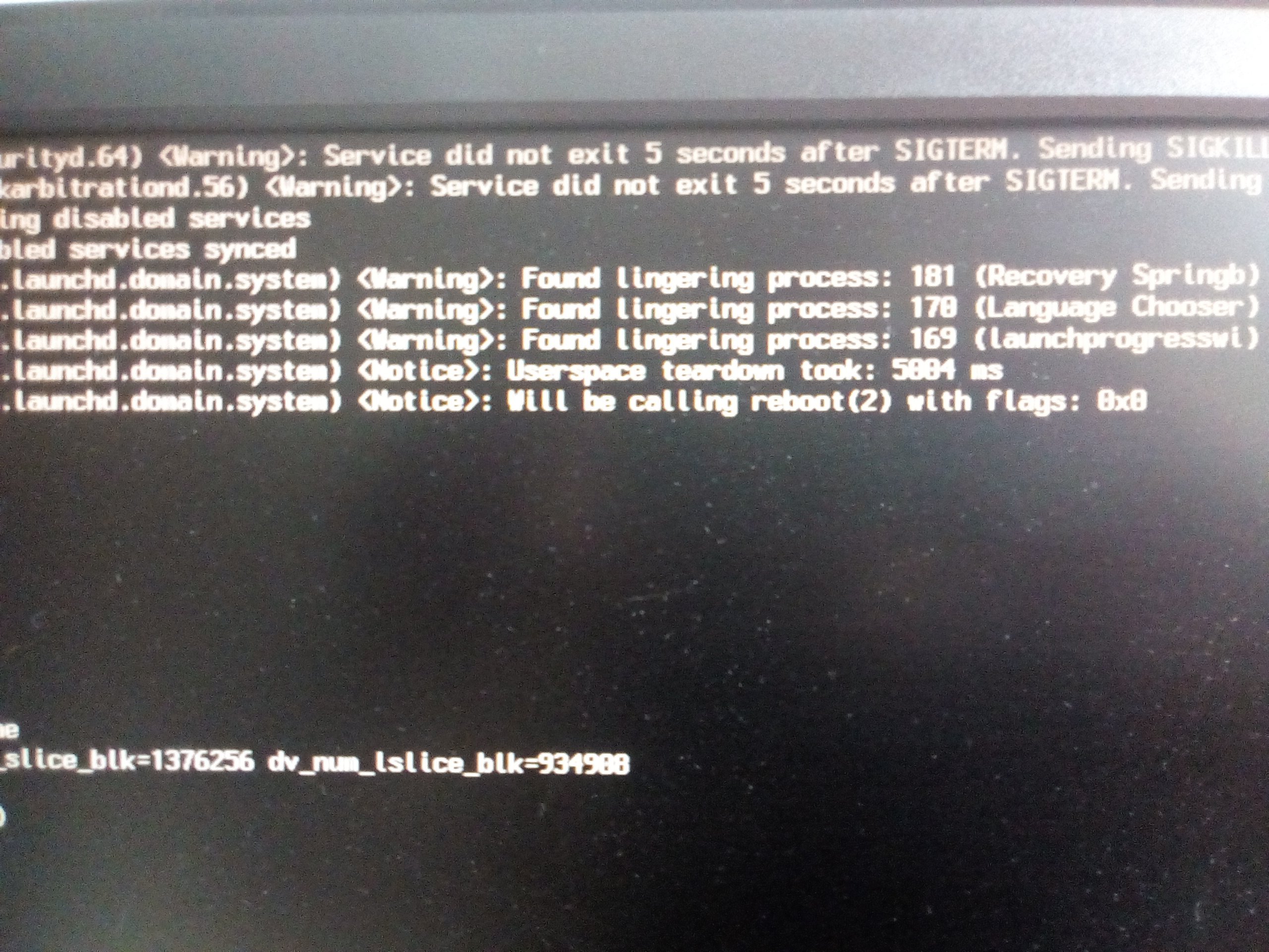

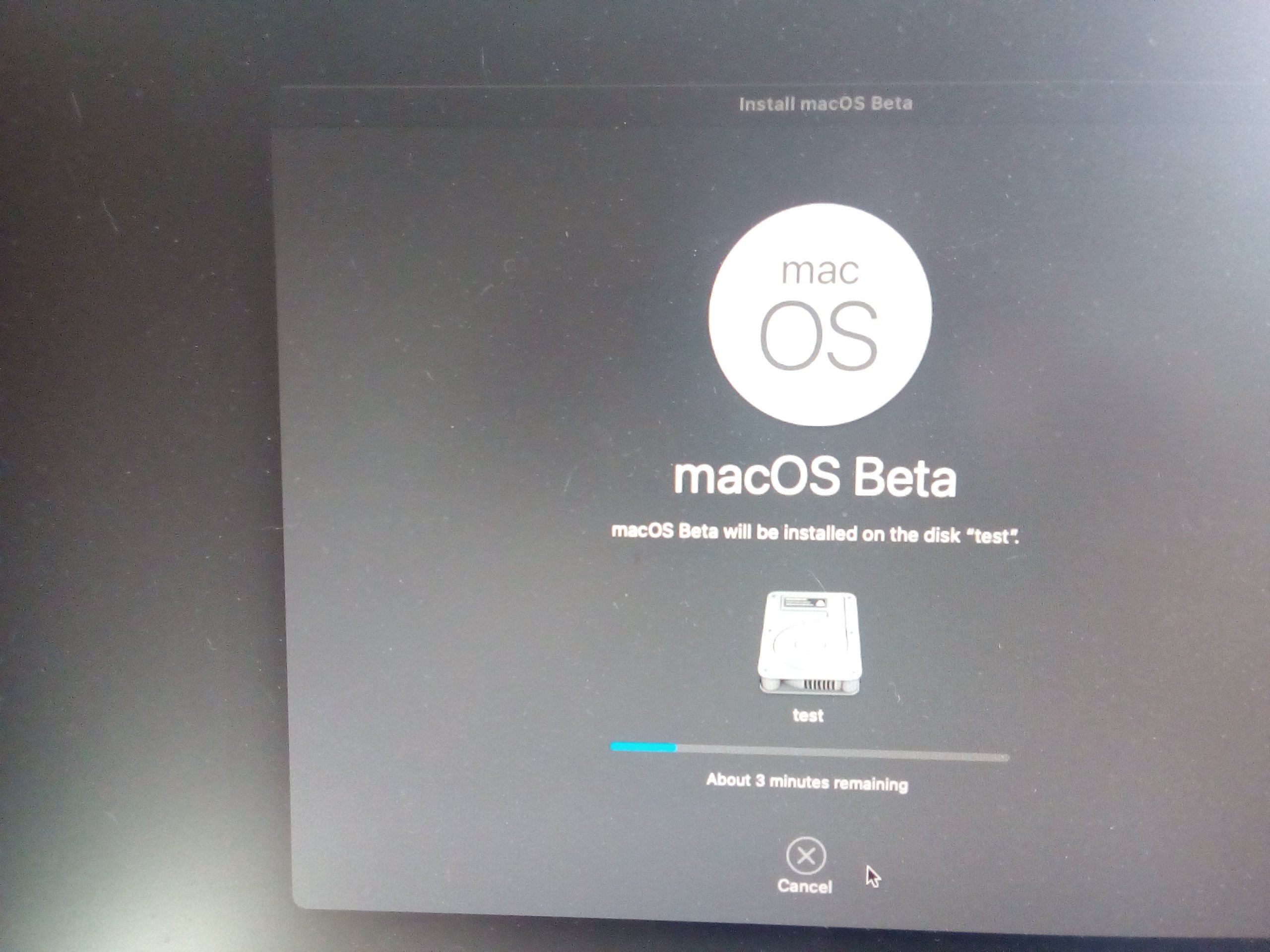

jsl2000 Posted August 28, 2020 Share Posted August 28, 2020 1 hour ago, Franziska1993 said: I'm using iMacPro1,1 , but I will try iMac19,1 and iMac15,1. On Catalina I used iMac14,2 because I use NVIDIA GT710. I get to the Installer. But after I start the Installer, after 2 Minutes it crashes with a Error Message, then it showes a Shutdown Message like when you make a normal shutdown. This happens in Beta 1 and Public Beta. By the way, what do you have for a Motherboard for your FX 6300 exactly? Is it the asus m5a78l-m, -LX, _LX3 or the Mobos with UEFI BIOS like M5a97 r 2.0? I'm asking, because I'm thinking about an AMD GPU like RX 560. But I'm not sure if it works my ASRock or ASUS M5A78L-M LX(3) both with legacy BIOS. Now back to the Topic: I will try an other SMBIOS like iMac19,1 and iMac15,1 or with later "nv_disable=1". When you start your Installer USB Stick, do you start with enabled SIP? My FX-6300 was in Asus M5A78L-M/USB3 mainboard which only provide Legacy Booting of OpenCore. Its internal GPU is ATI Radeon HD 3000 which was NOT supported by Mac OS X at all. Using GT 710 or GT 730 always got freeze during booting after PCI Configuration appeared with SMBIOS of iMacPro1,1. If iMac19,1 or iMac15,1 can not work with GT 710 or 730 means we are in the same boat ! RX-560/570/580 is the best dGPU in FX-6300 or Ryzen Hackintosh according to my test. Link to comment https://www.insanelymac.com/forum/topic/344335-amd-experimental-patches-macos-big-sur/page/2/#findComment-2735673 Share on other sites More sharing options...

Franziska1993 Posted August 28, 2020 Share Posted August 28, 2020 As I thought, on my ASUS Mobo the GT710 made it to the Installer without freezing, but with the same crash after 2 Minutes. After testing I got an Error Messages about that SIP was enabled, so I disabled it by the next booting. But then I had an other Error. That's a meant, these little mistakes in the OpenCore setting can cause serious problems. Link to comment https://www.insanelymac.com/forum/topic/344335-amd-experimental-patches-macos-big-sur/page/2/#findComment-2735706 Share on other sites More sharing options...

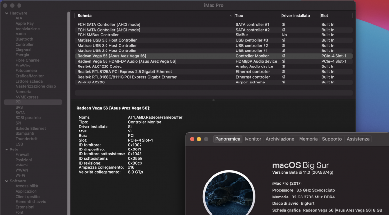

iCanaro Posted September 20, 2020 Share Posted September 20, 2020 OC 062 experimental patch https://github.com/AMD-OSX/AMD_Vanilla/tree/experimental-opencore T-RyZo Link to comment https://www.insanelymac.com/forum/topic/344335-amd-experimental-patches-macos-big-sur/page/2/#findComment-2737839 Share on other sites More sharing options...

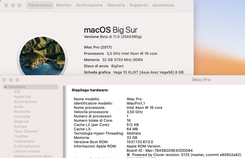

iCanaro Posted October 21, 2020 Share Posted October 21, 2020 on the T-RyZo I could not update with Clover, the first phase went well; the last part of the installation if it goes, I couldn't find a way to get it going, I finished with OC 062 stable then BS beta 10 starts well with Clover 5125, but not with all 5125. see here for KernelToPatch 17h for Clover 1 Link to comment https://www.insanelymac.com/forum/topic/344335-amd-experimental-patches-macos-big-sur/page/2/#findComment-2741591 Share on other sites More sharing options...
jsl2000 Posted October 21, 2020 Share Posted October 21, 2020 (edited) 11 hours ago, iCanaro said: on the T-RyZo I could not update with Clover, the first phase went well; the last part of the installation if it goes, I couldn't find a way to get it going, I finished with OC 062 stable then BS beta 10 starts well with Clover 5125, but not with all 5125. see here for KernelToPatch 17h for Clover Thanks, but with these new Clover and your patches still hang at "Previous shutdown cause: 5" in my Ryzen 1700X hackintosh. [Solved] I need delete SMCHelper.efi and add several SSDT-*.aml to fit my hardware and Clover bootloader. Edited October 21, 2020 by jsl2000 Link to comment https://www.insanelymac.com/forum/topic/344335-amd-experimental-patches-macos-big-sur/page/2/#findComment-2741610 Share on other sites More sharing options...
