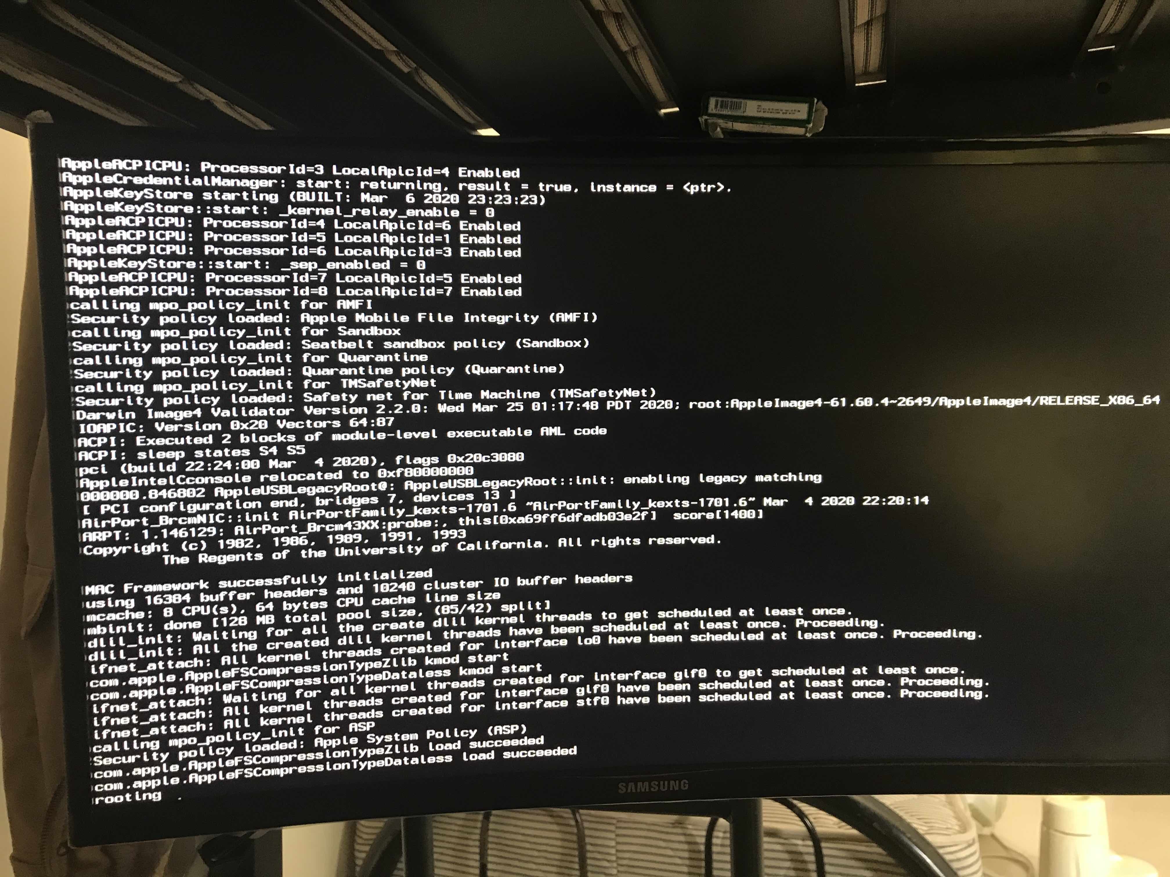

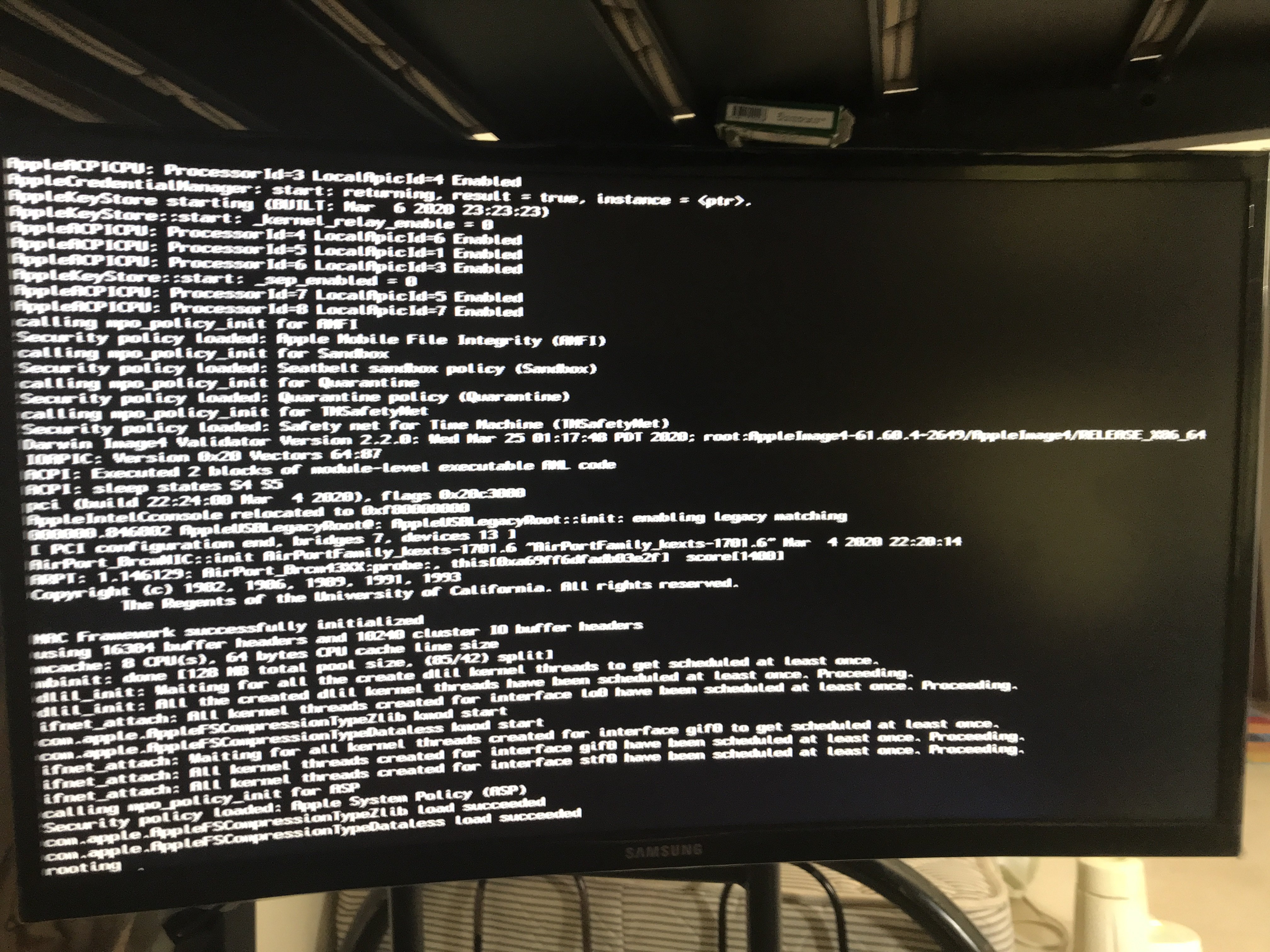

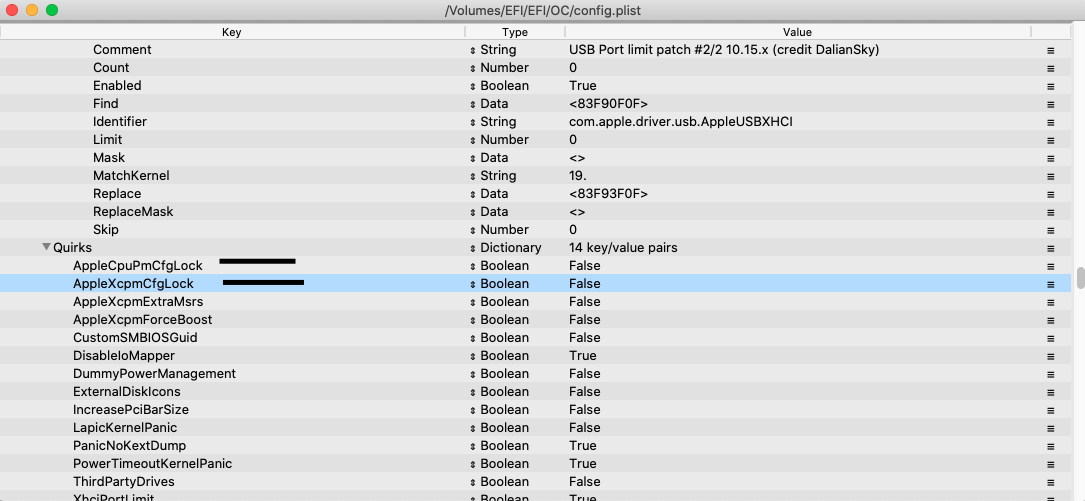

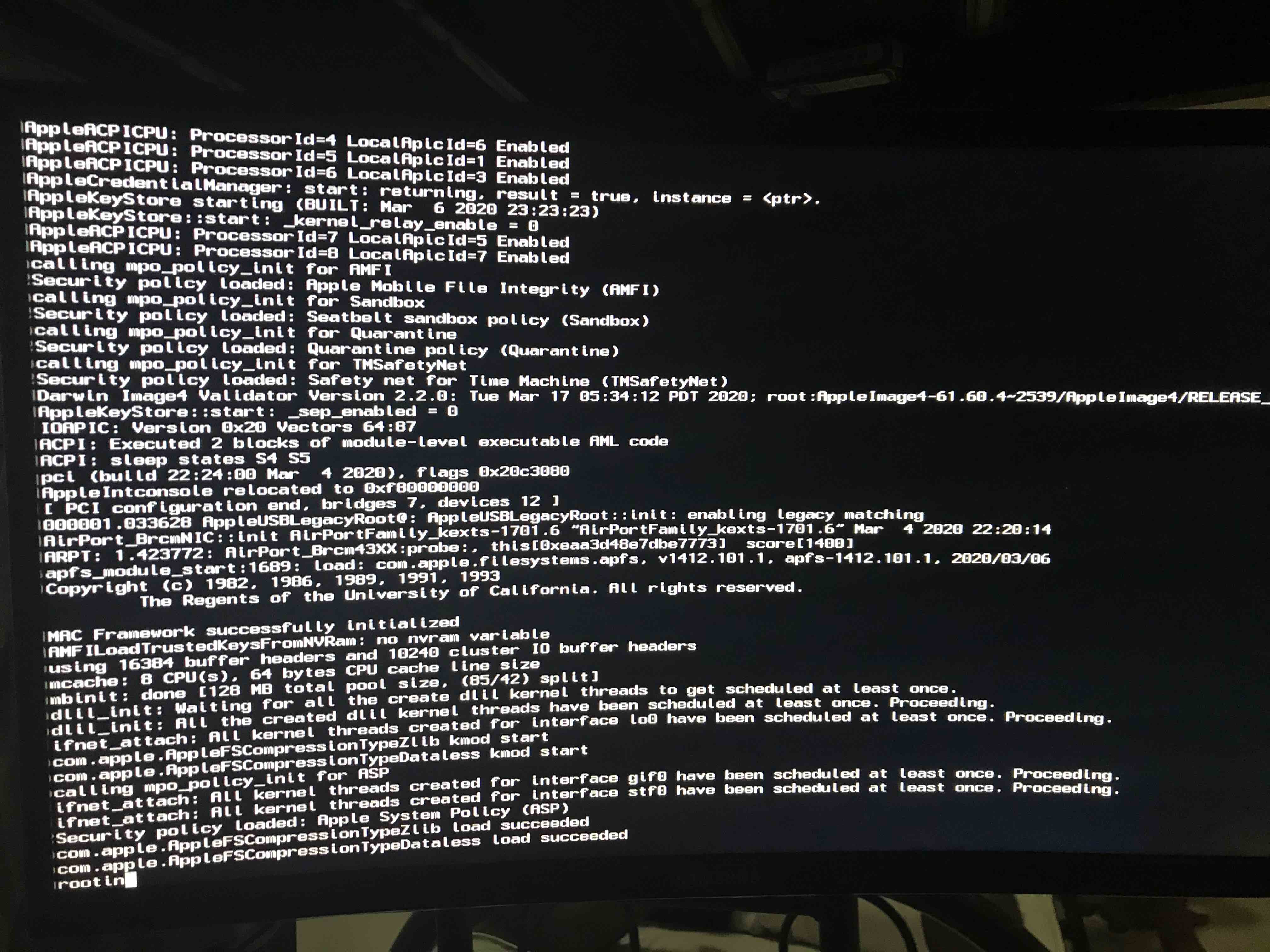

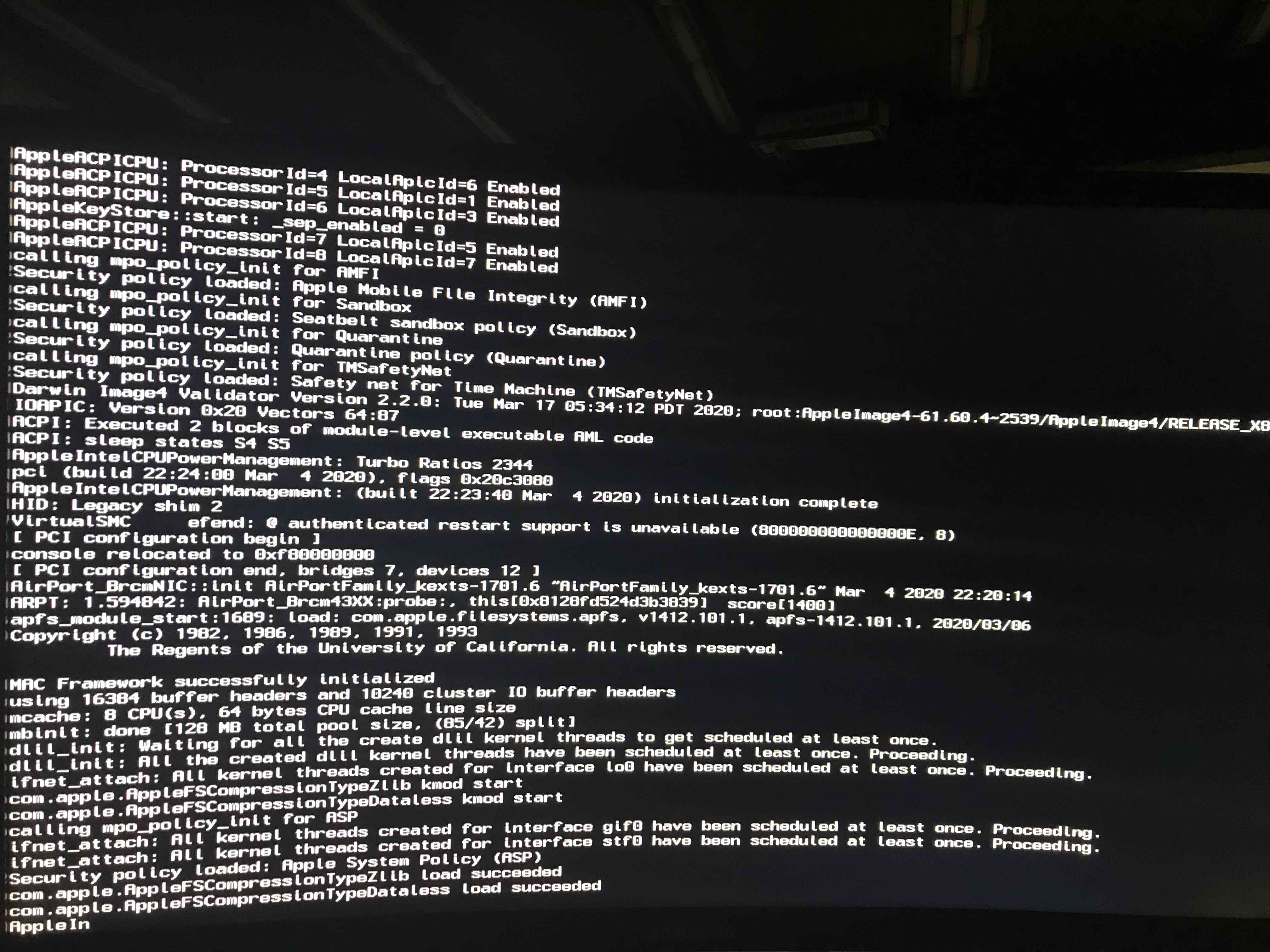

Apple Hunter Posted April 10, 2020 Share Posted April 10, 2020 1st i started Opencore 0.5.6. try many tricks. followed instruction on opencore.one but cant fix this issues. 2nd time try with 0.5.7. something improvement. pass previous ^ and freeze here. sometime show like this.. if i change settings like here i mentioned (change to false) then shows like this.. Here i have attached my efi. please help me how to fix it... EFI(4).zip Link to comment Share on other sites More sharing options...

Simonej Posted April 11, 2020 Share Posted April 11, 2020 Hi @Apple Hunter, have you tried with IgnoreInvalidFlexRatio = true? Link to comment Share on other sites More sharing options...

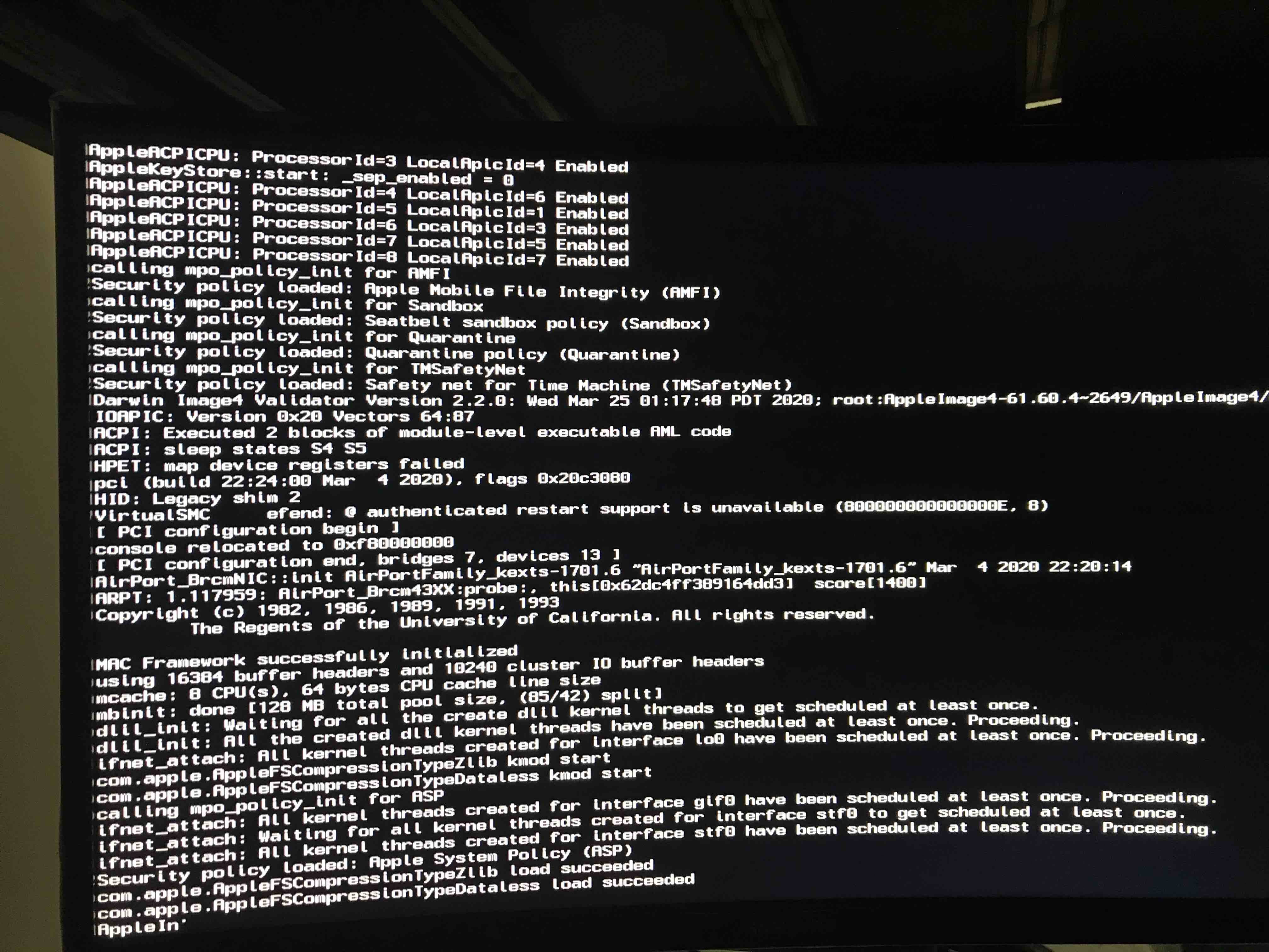

Apple Hunter Posted April 21, 2020 Author Share Posted April 21, 2020 On 4/11/2020 at 9:30 PM, Simonej said: Hi @Apple Hunter, have you tried with IgnoreInvalidFlexRatio = true? if i change to false boot like this... change to true... boot like this then freeze here. freeze num lock, caps lock, then need to press direct reset button. Link to comment Share on other sites More sharing options...
Simonej Posted April 22, 2020 Share Posted April 22, 2020 I have no experience with Biostar motherboards and Catalina, but here is my config for OC 0.5.7 with Gigabyte Z77N-WiFi + i5 3750K, other than serial you should probably add/remove some SSDT and kexts, AppleCpuPmCfgLock=True: https://pastebin.com/upjtKhX1 If you have Clover working on your machine maybe it will be useful if you share your config. Link to comment Share on other sites More sharing options...

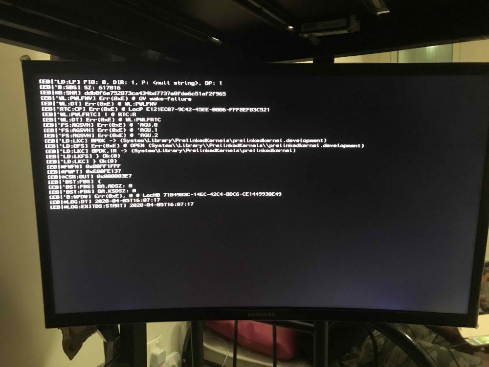

Apple Hunter Posted April 23, 2020 Author Share Posted April 23, 2020 19 hours ago, Simonej said: There are some DSDT fixes and SSDT, other than add/remove those also in OC, I suggest to extract patched DSDT from Clover GUI with F5. After adding dsdt.aml which generated on clover shows like this. if i add this dsdt on clover it works fine. Link to comment Share on other sites More sharing options...
