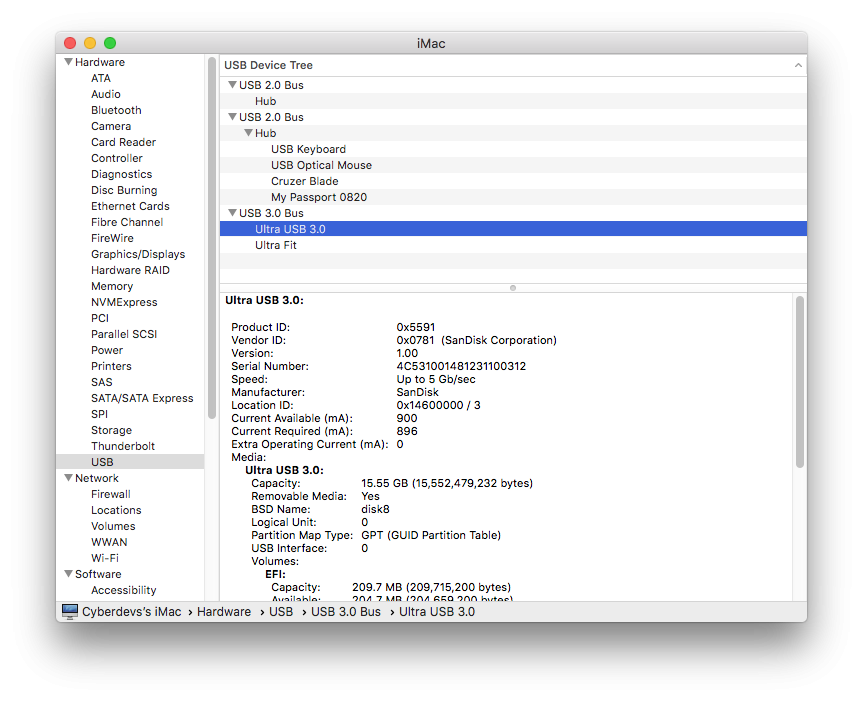

Cyberdevs Posted January 5, 2020 Share Posted January 5, 2020 @bgrau Sorry for the delay on reply, you have way too many unnecessary and duplicate kexts in your EFI folder. Here the revised version of your EFI folder which works OK on my rig Ethernet and the USB 3.0's also work on High Sierra, as a matter of fact I even clean installed it using a USB 3.0 port. EFI.zip 1 Link to comment Share on other sites More sharing options...

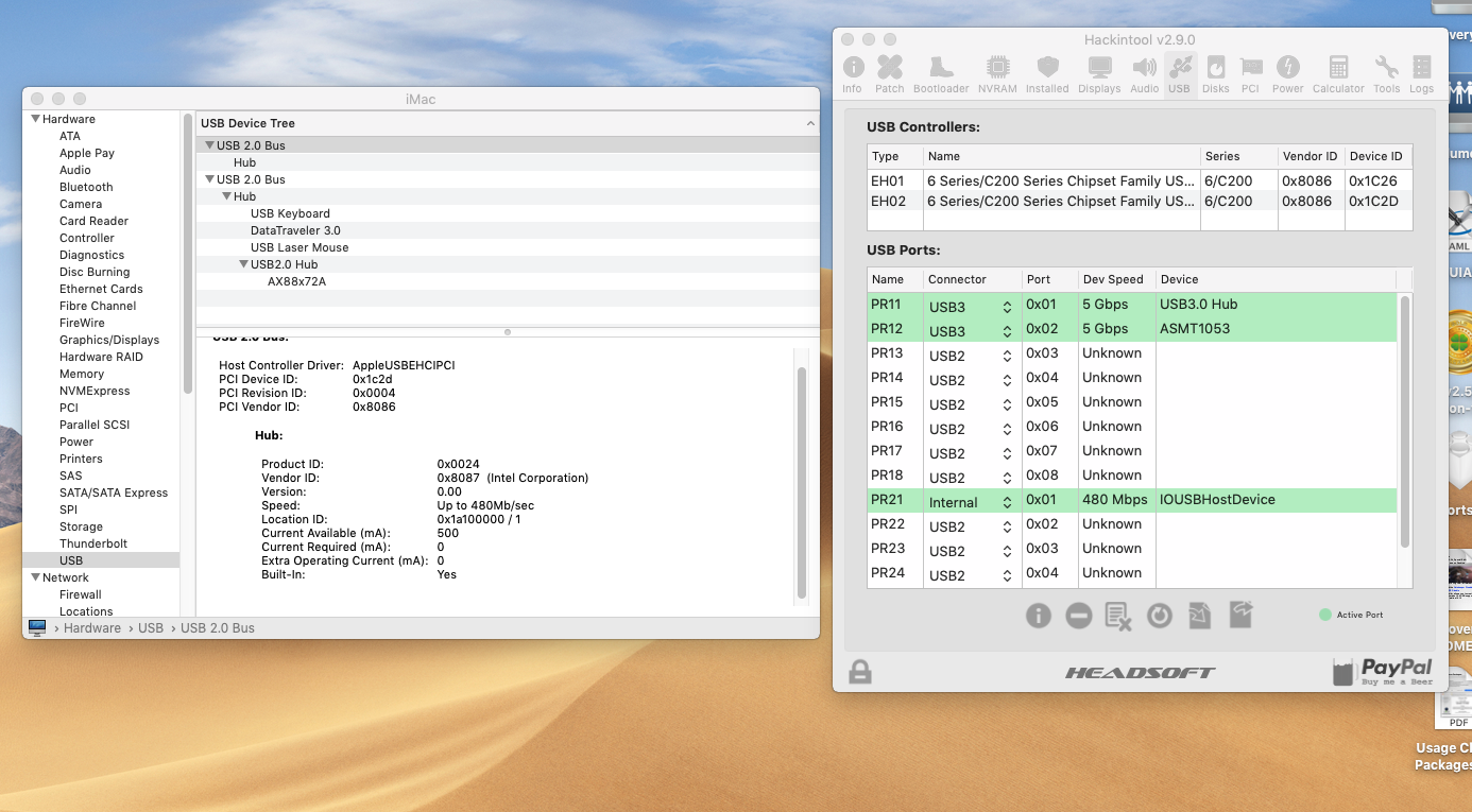

bgrau Posted January 5, 2020 Author Share Posted January 5, 2020 (edited) 8 hours ago, bgrau said: Cool - I will test it very soon @cyberdevs Tested it just now on Mojave - it will not boot if the DSDT is not in the EFI ACPI patch folder. When I put DSDT in the patch folder, it's same as before, so it has to do with my Asus motherboard which is not exactly like yours. It might be cosmetics as hackintool detects the 2 X 5 GBs USB 3.0 ports, but the system profiler does not record them as USB 3.0 Probably will get same old result with high sierra too (I tried it cannot boot too with no DSDT in patch folder). There might be need for a mod for the DSDT too, but I don't know which one... Edited January 5, 2020 by bgrau Link to comment Share on other sites More sharing options...
bgrau Posted January 6, 2020 Author Share Posted January 6, 2020 @cyberdevs Thanks again for helping on this. For High Sierra, i had to do an in place upgrade to get USB 3.0 & Ethernet activated, however USB 3.0 still does not register on Apple System Profiler, only USB 2.0 does as in the pix I posted earlier. So this must have to do with the motherboard, it seems yours is more compatible than mine, or I need a better patched DSDT.aml - USB 3.0 works, it just does not register as USB 3.0, also does not boot, but accessing the speed is what I am interested in, no more. Link to comment Share on other sites More sharing options...

Cyberdevs Posted January 7, 2020 Share Posted January 7, 2020 If you get USB 3.0 speed on USB 3.0 ports then what system profiler doesn't matter so it's gonna be cosmetics, however you can fix it by editing the SSDT-UIAC.aml. 1 Link to comment Share on other sites More sharing options...
bgrau Posted January 8, 2020 Author Share Posted January 8, 2020 (edited) On 1/7/2020 at 8:19 PM, Cyberdevs said: If you get USB 3.0 speed on USB 3.0 ports then what system profiler doesn't matter so it's gonna be cosmetics, however you can fix it by editing the SSDT-UIAC.aml. According to RehabMan usb 3.0 renesas cannot be fixed for hackintosh, though I find it odd, & encouraging that hackintool registers the ports speeds as 5 GB/s. I am now researching how to modify the DSDT to get USB 3.0 to appear in Apple System Profiler as per these links: https://www.travelertechie.com/2019/02/create-ssdt-to-fix-usb-rehabmans-way.html Why InsanelyMac does not support tonymacx86 but I am not in a hurry, am pausing as I have health issues to deal with Edited January 8, 2020 by Cyberdevs Links were removed. 1 Link to comment Share on other sites More sharing options...
