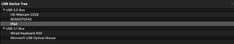

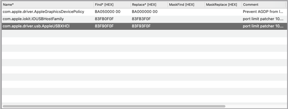

arsradu Posted December 12, 2019 Author Share Posted December 12, 2019 (edited) On 12/11/2019 at 10:56 PM, gengik84 said: i don't know if yours usb are mapped or you use port limit patch if yours usb are mapped, is possible that: 1) one usb work only on 2.0 2) one usb work only in 3.0 Well, it would be possible, if it would also occur on a new installation. But it doesn't. Same drive works fine with both ports there. Update: Ok, so the USB 3.0 device now works with both ports (did a kext cache rebuild, and looks like that fixed it). However, the USB 2.0 devices (such as an iPad connected via Lightning cable) only gets recognised in one of the two ports. By the way, the motherboard is a Z170 Gaming K3, so not the one in my sig. Clearly the ports work, and they're both USB 3.0 (at least on the outside). I tried every renaming in the book (EHC1-EH01/EHC2->EH02). USBInjectALL is also present. I added limit patchers. I don't know what else to try. Looks like it's just that port that doesn't wanna work with USB 2.0 devices. Also, in System Report -> USB, I only get "USB 3.0 Bus" and "USB 3.1 Bus". No mention of any 2.0. However, 2.0 devices DO seem to work (such as the iPad in the other 3.0 port). And it's listed as "USB 3.0". This is all super confusing to me. Edited December 13, 2019 by arsradu Link to comment Share on other sites More sharing options...
