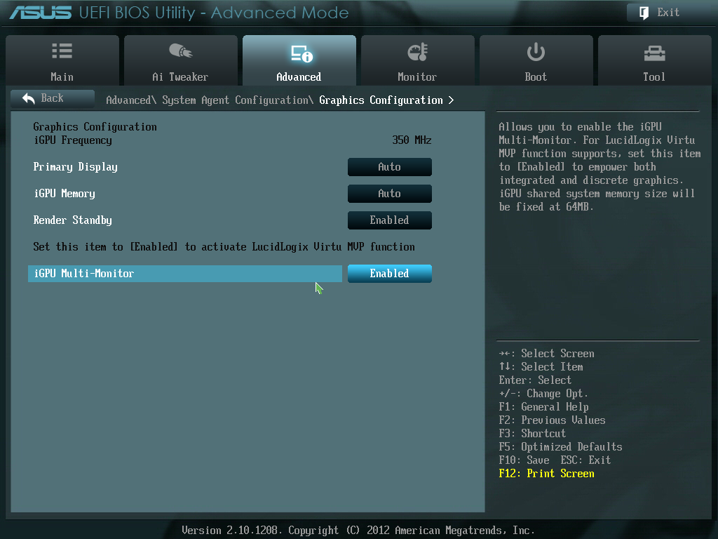

iCore Posted September 20, 2019 Author Share Posted September 20, 2019 (edited) On 9/19/2019 at 7:52 PM, Cyberdevs said: The config seems fine, is IGPU enabled in BIOS? Well, I did not find any clear "enable iGPU" option. Should it be enabled or disabled ? Edit: It looks like it is always enabled. Some google searches show up people asking how to disable it, which seems possible in earlier version of the bios (of course I have the latest :/ ) I had the iGPU MultiMonitor option disabled, I enabled it (see screenshot) but no change Edited September 21, 2019 by iCore PNG image instead of BMP Link to comment https://www.insanelymac.com/forum/topic/340334-issue-with-dispayport-with-rx580/#findComment-2690801 Share on other sites More sharing options...
