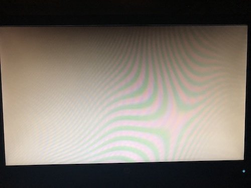

telepati Posted August 27, 2019 Share Posted August 27, 2019 (edited) Hi, guys, I don't know what is going on but I am losing my screen randomly sometimes turn whitish-grey while working and making force restart from the case but know it turns like a chessboard and flickering glitch look. I am using lastest WEG and I also test with without WEG. IMG_0106.mp4 Edited August 27, 2019 by telepati Link to comment https://www.insanelymac.com/forum/topic/340050-screen-turns-like-chessboard-and-flickering/ Share on other sites More sharing options...

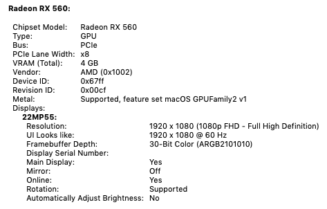

C.Frio Posted August 28, 2019 Share Posted August 28, 2019 hi... any chance to try the video card on windows? or another video card? and this is my video settings.no lilu and no weg c.frio 1 Link to comment https://www.insanelymac.com/forum/topic/340050-screen-turns-like-chessboard-and-flickering/#findComment-2687674 Share on other sites More sharing options...

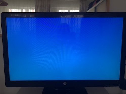

telepati Posted August 29, 2019 Author Share Posted August 29, 2019 (edited) On 8/28/2019 at 8:19 PM, C.Frio said: hi... any chance to try the video card on windows? or another video card? and this is my video settings.no lilu and no weg c.frio 5 hours ago, marvelloard said: Definitely try Windows, it might be a hw issue. Could be bad VRam. Sorry guys, I am writing a late response to your suggestion as you know this is not a permanent problem, it is happening randomly. Cause I don't know when will happen. Windows also installed on my system and boot with the windows and I used a couple of days with it. I didn't get Chessboard type problem but I loss my screen again. While using the screen turned whitish-grey or just my background color again no icons or cursor fully unavailable. I just made force restart from the case. Anyway, I decided to send the graphics card to the service. I open an RMA today we will see what will happen after service. BTW, in the meantime, I will use my system with HD630, if this problem still continues with the HD630 that's mean the problem is a totally different part of my system. This the look when turns the screen; Generally, I am getting the first one very long time I didn't get a blue one. I also get light green but I didn't take a picture when it happens. Edited August 29, 2019 by telepati 2 Link to comment https://www.insanelymac.com/forum/topic/340050-screen-turns-like-chessboard-and-flickering/#findComment-2687778 Share on other sites More sharing options...
