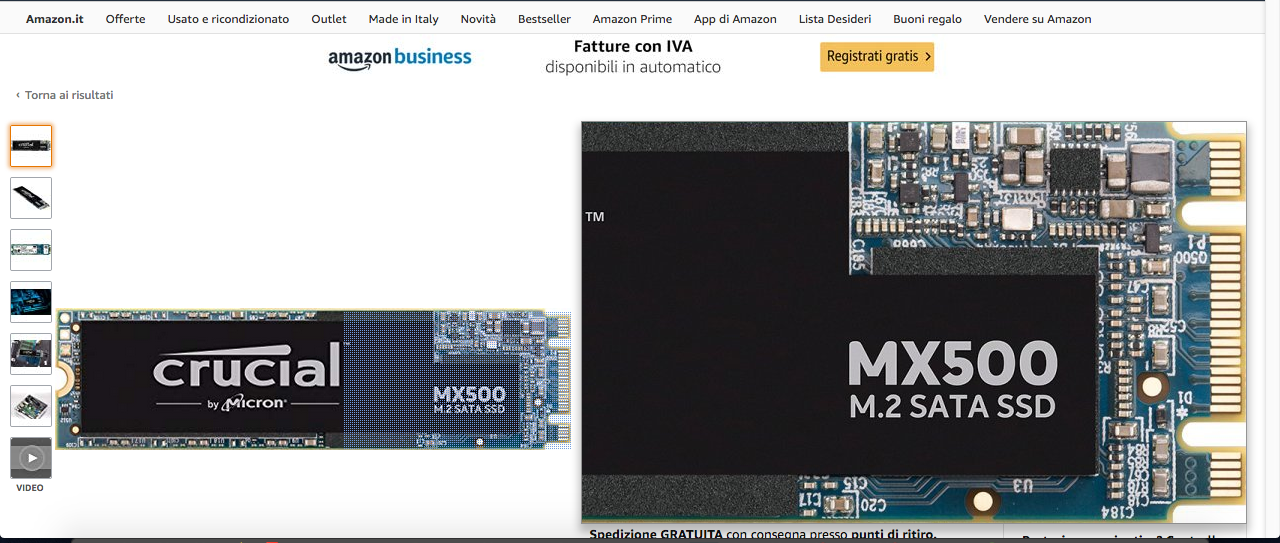

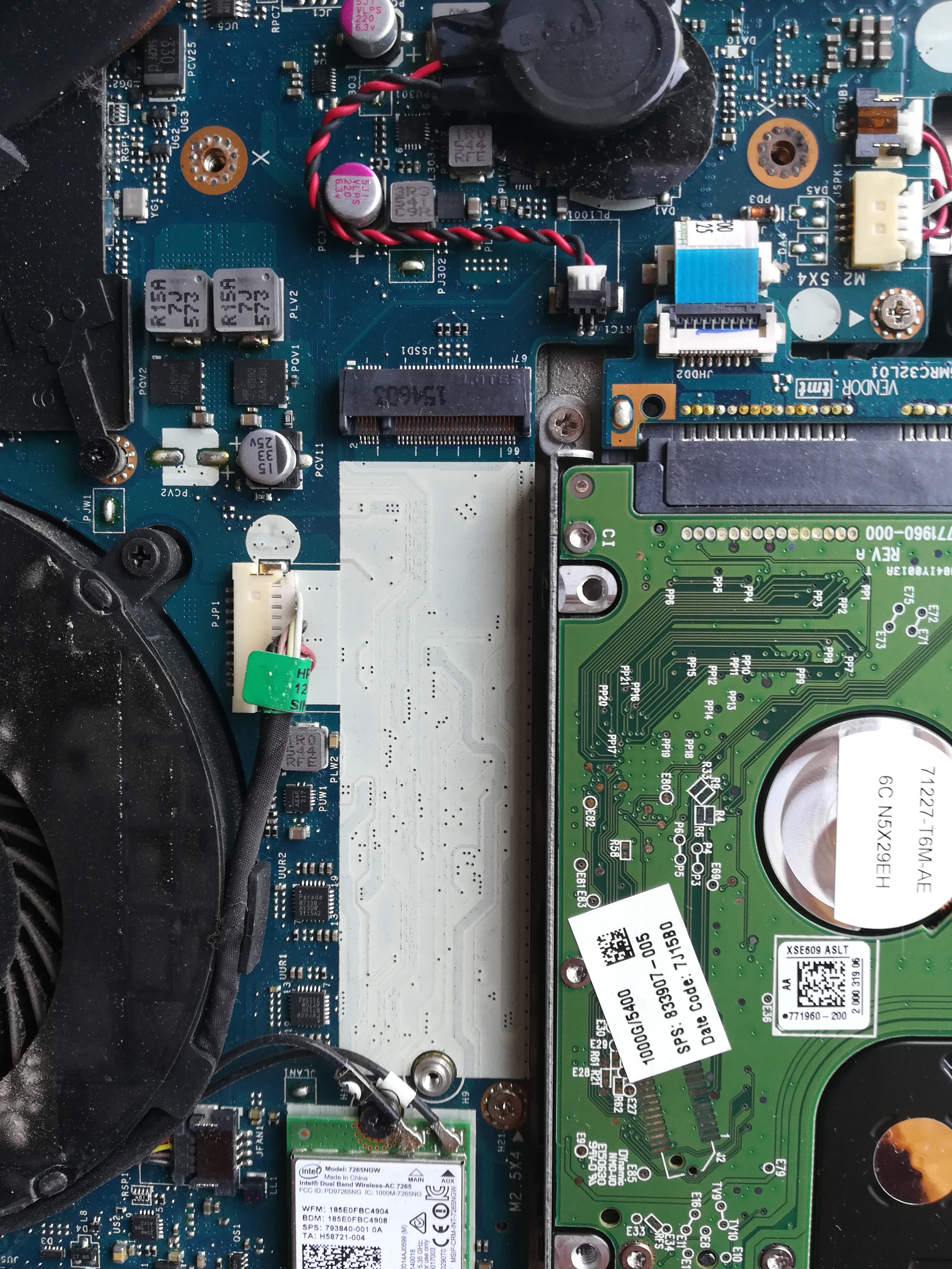

RichieKotzen Posted August 26, 2019 Share Posted August 26, 2019 Sono un pò confuso x questo chiedo a voi,che socket è questo in foto? Quale SSD devo prendere? Avevo visto questo su Amazon Link to comment Share on other sites More sharing options...
gengik84 Posted August 26, 2019 Share Posted August 26, 2019 Ciao... un M2 Link to comment Share on other sites More sharing options...
RichieKotzen Posted August 26, 2019 Author Share Posted August 26, 2019 3 minutes ago, gengik84 said: Ciao... un M2 Il crucial su Amazon quello in foto va bene? il socket sembra diverso Link to comment Share on other sites More sharing options...
iCanaro Posted August 26, 2019 Share Posted August 26, 2019 scusa ma sul sito del produttore del modello tuo notebook... che riporta??? Da vedere sembra un M2 ma se hai dubbi, prenditi un SSD normale da mettere al posto del disco meccanico Link to comment Share on other sites More sharing options...
RichieKotzen Posted August 31, 2019 Author Share Posted August 31, 2019 On 8/26/2019 at 3:43 PM, Hervé said: M.2 length = 2280 ! M.2 Slot = key/socket B, 6-pin (SSD key B / SSD key B+M = Ok). M.2 PCIe lanes = 2 (key B ) -> SSD NVME (PCIe) = Ok -> SSD SATA = Ok Crucial MX500 SATA SSD = M.2 2280, Key B+M -> Ok Example: thanks Link to comment Share on other sites More sharing options...
