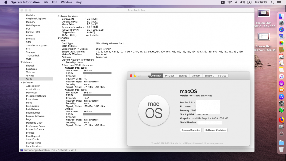

alpha.delta Posted June 21, 2019 Share Posted June 21, 2019 (edited) I installed macOS 10.15 Catalina on my Lappy. Everything work fine but only DW1510 BCM94322HM8L wont work. DW1510 BCM94322HM8L work OOB on 10.14.x but not on 10.15. I need help. -------------------------------------------------------------------------------------- Solved By put IO80211Family.kext from macOs 10.14.5 to Clover/Kexts/10.15 Edited June 22, 2019 by alpha.delta 2 Link to comment Share on other sites More sharing options...

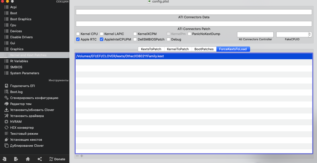

idle0502 Posted May 28, 2020 Share Posted May 28, 2020 On 10/12/2019 at 11:19 PM, saadsmh said: Adding kext Clover/Kexts/10.15 didn't worked for me . need set some settings in clover?? Yes! Add path to IO80211Family.kext in "ForceToKextToLoad" section in Clover configurator! /Volumes/EFI/EFI/CLOVER/kexts/Other/IO80211Family.kext Link to comment Share on other sites More sharing options...
