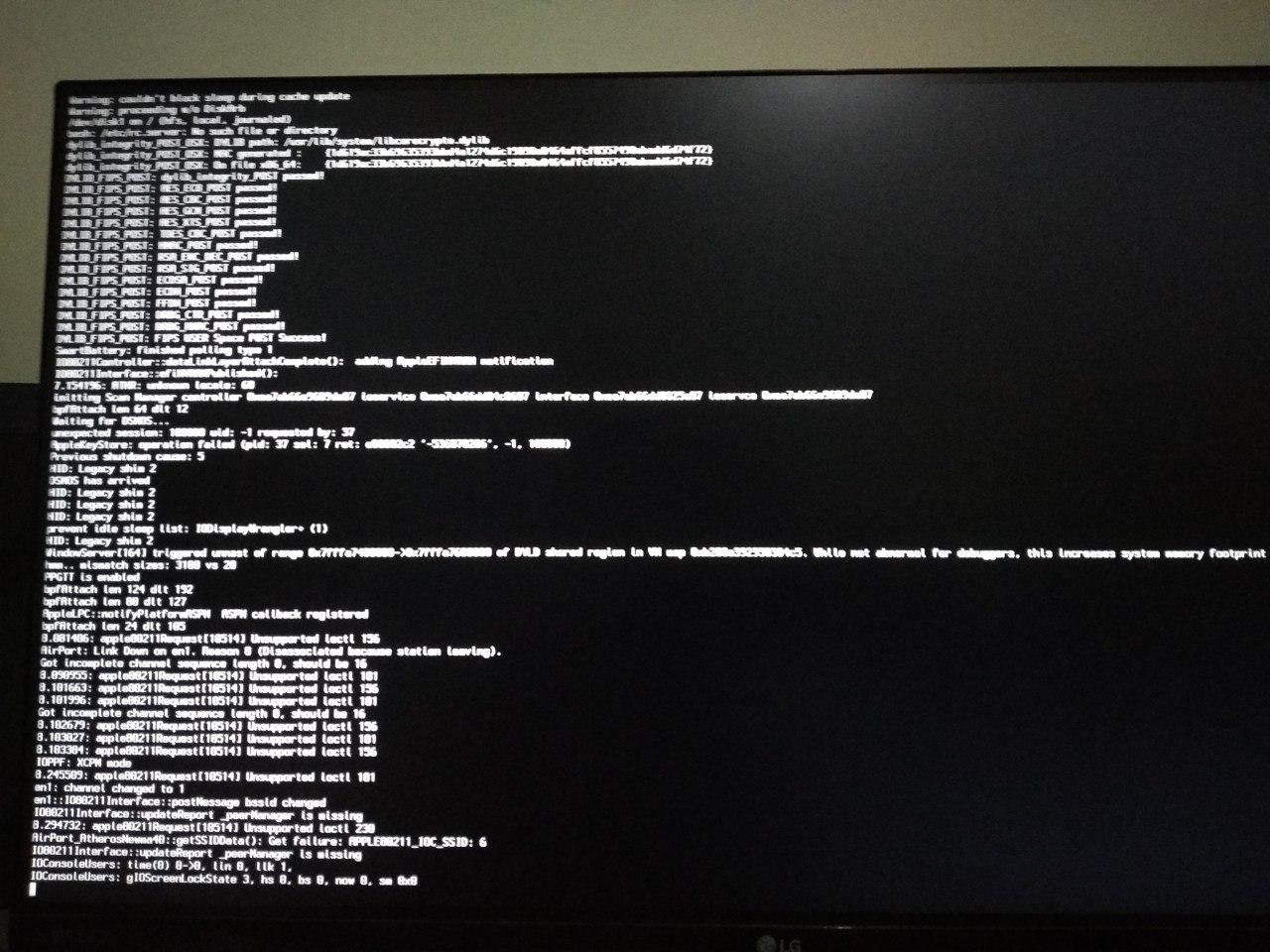

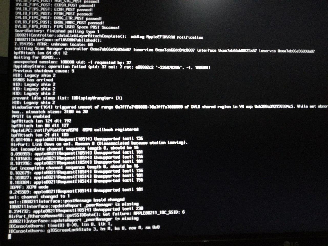

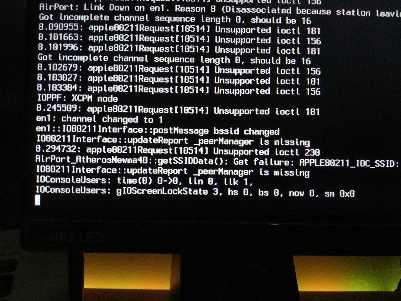

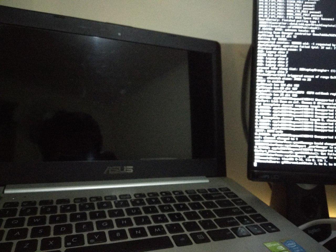

alfalus Posted March 30, 2019 Share Posted March 30, 2019 (edited) This is the only problem that I have not been able to finish since playing hackintosh. The problem is that my laptop can't go to the desktop when it is connected to HDMI when before booting. But the problem was not encountered when plugging HDMI when it was on the desktop. At first I thought that this was a matter of HDMI cable. I tried booting by plugging in HDMI before booting on my Dell laptop which only has single graphics Intel HD. And it turned out that the Clover GUI didn't move to my 2nd monitor. Which means it can go to the desktop without any problems. But on my Asus, when HDMI was connected before boot and trying to boot then the clover GUI screen was moved to 2nd monitor screen. Anyway, log when I stick hdmi before booting stops at "IOConsoleUser: gIOScreenLockState 3" you can take a look at the picture below.. My laptop specification is: Asus Vivobook S451LB 1. Processor: Intel Core i3-4010U @ 1.7GHz 2. RAM: 8GB (4GBx2) 1600 MHz DDR3 3. Storage: - Main SSD storage for Samsung Evo 850 256GB - Secondary storage HDD (Caddy) HGST 1TB 4. GPU: Intel HD 4400 (Integrated) + GT740M (Discrete) 5. Audio codec: ALC233 6. LAN: Realtek RTL8168 7. Wifi: Combo AR9285 BT 8. Touchpad: ELAN with PS2 Interface \ * Running on Sierra 10.12.6 If anyone can help me, it would be appreciated.. Edited March 30, 2019 by alfalus Link to comment https://www.insanelymac.com/forum/topic/338117-cant-go-desktop-when-hdmi-is-connected-at-the-first-boot/ Share on other sites More sharing options...

alfalus Posted March 30, 2019 Author Share Posted March 30, 2019 Of course, when i've reached the desktop. The nvidia has disabled Link to comment https://www.insanelymac.com/forum/topic/338117-cant-go-desktop-when-hdmi-is-connected-at-the-first-boot/#findComment-2668513 Share on other sites More sharing options...

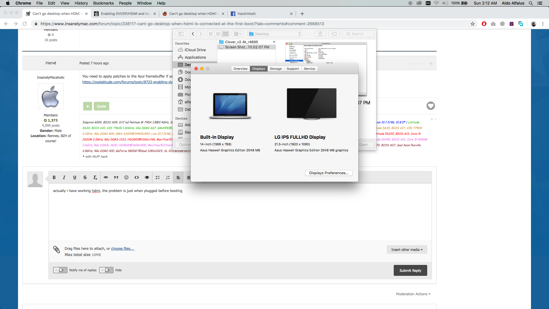

alfalus Posted March 30, 2019 Author Share Posted March 30, 2019 actually i have working hdmi, the problem is just when plugged before booting Link to comment https://www.insanelymac.com/forum/topic/338117-cant-go-desktop-when-hdmi-is-connected-at-the-first-boot/#findComment-2668599 Share on other sites More sharing options...
