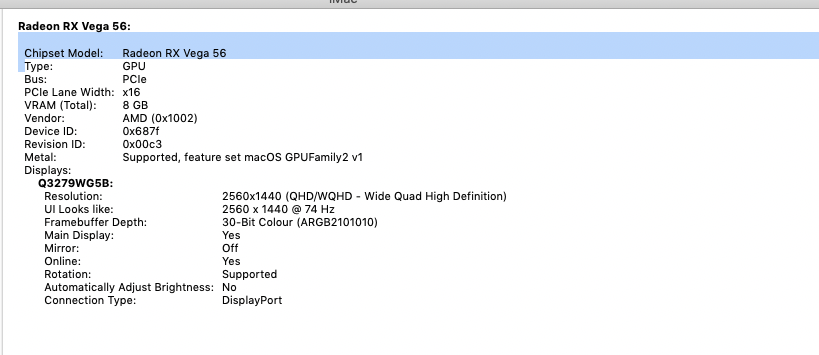

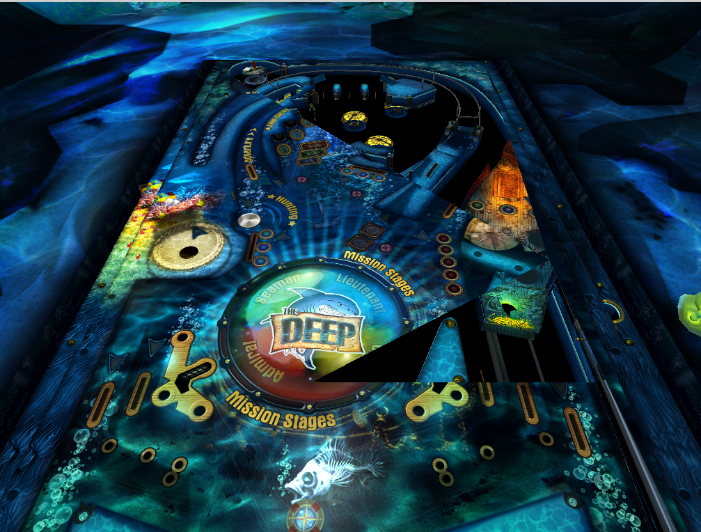

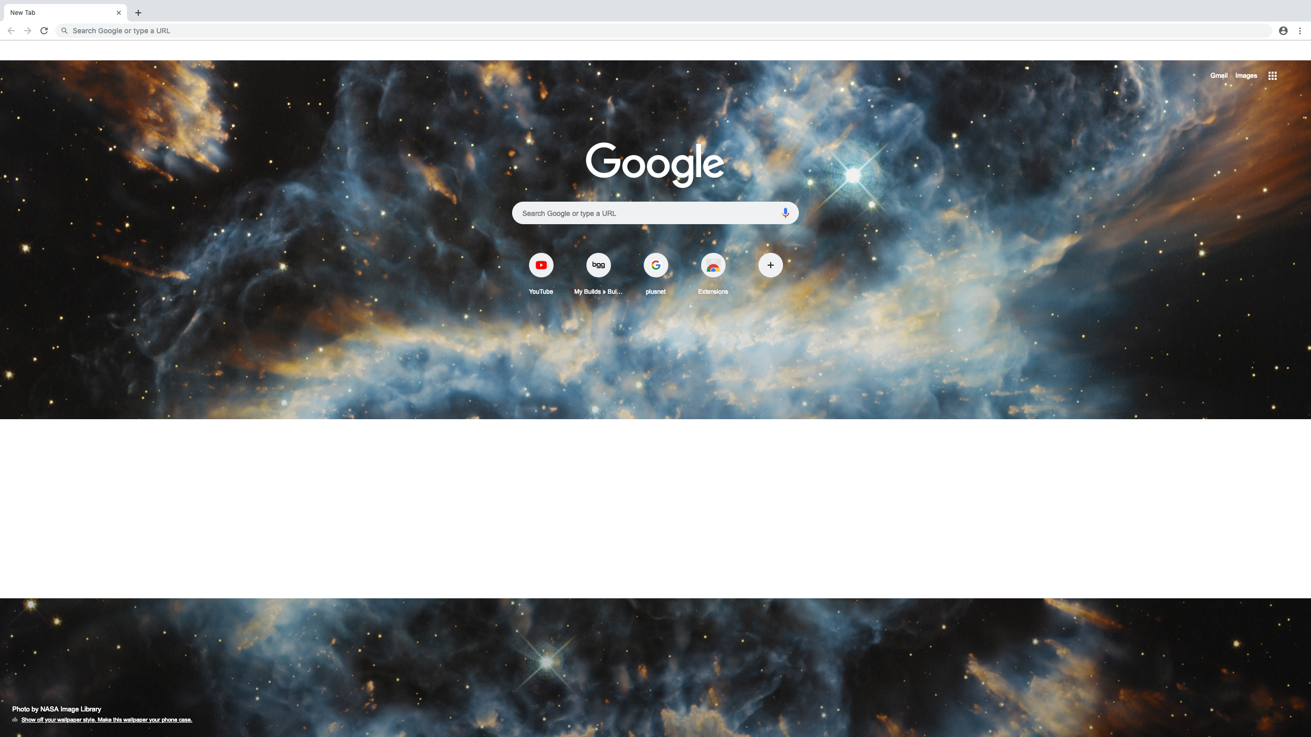

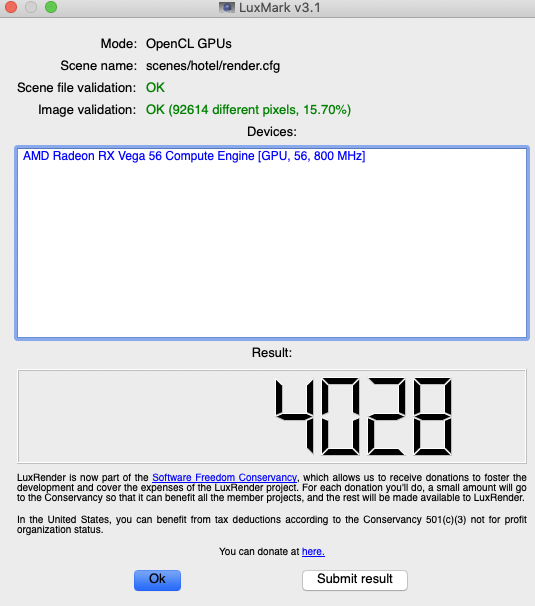

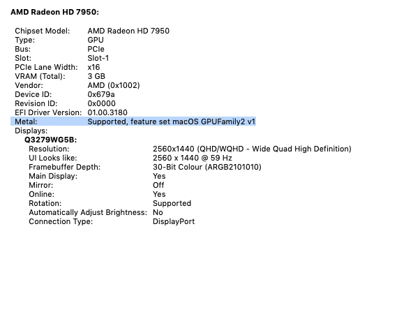

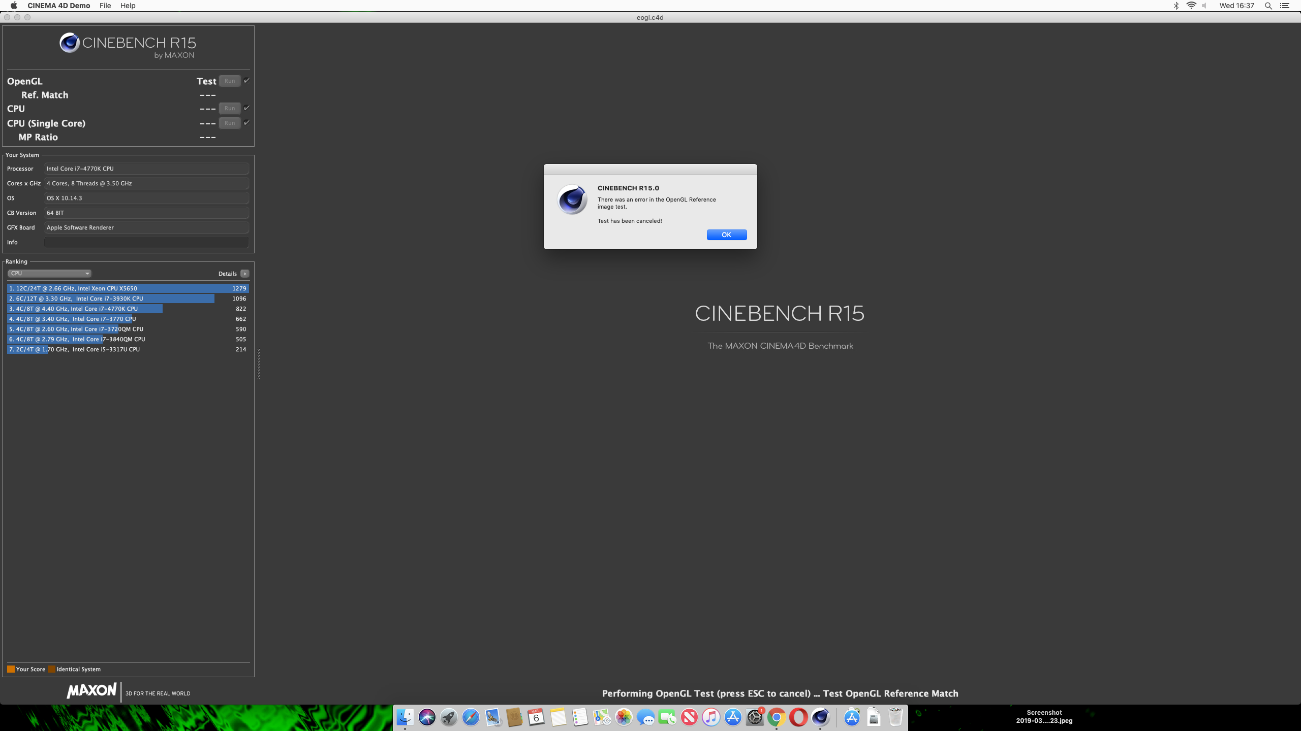

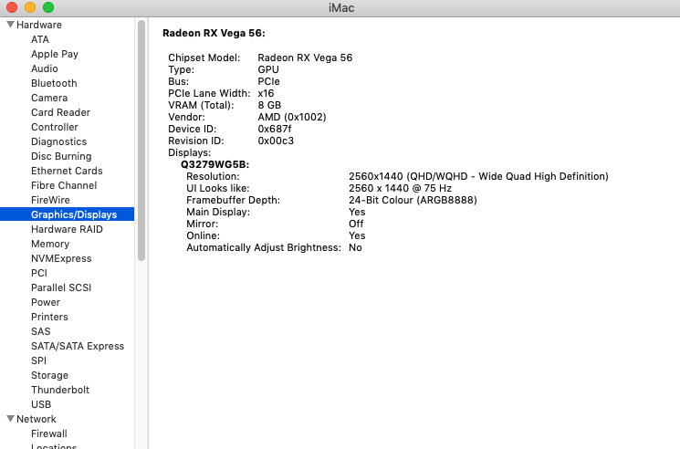

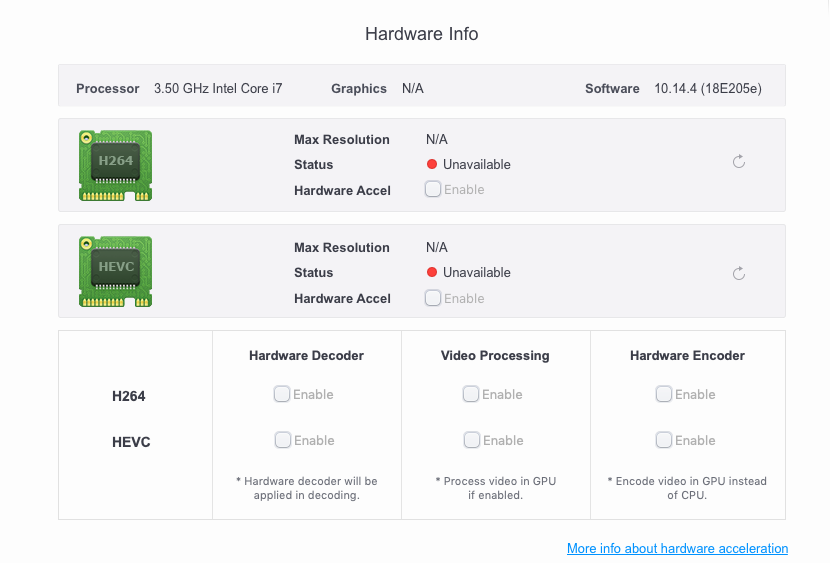

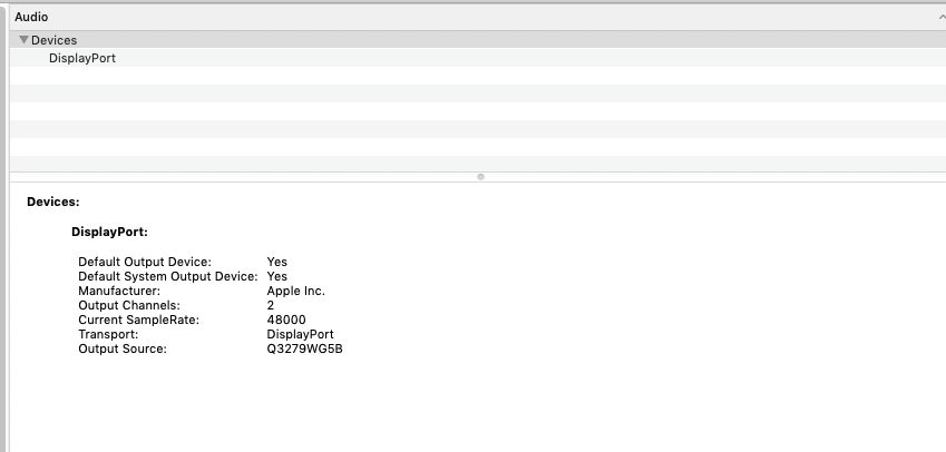

BALDY_MAN Posted March 6, 2019 Share Posted March 6, 2019 (edited) I have just bought a Msi Radeon Vega 56, And I can't get it to work properly I think Open GL is not working or Hardware Acceleration as I can't run cine bench or open Valley benchmark tool or a pin ball game parts are missing and google acting strange could someone help me fix my problem please I can't work it out myself it seems to support metal. but I have looked in the Ati10000 Controller and the device id is in the personality on the kext plist. IT Look like my Msi Vega 56 is not supported by Metal unlike my old AMD RADEON HD 7950 OK THE UPDATE on my problem I R.M.A ed the card and got a new one to day and it works with Metal support. and i get sound though Desplayport. the fan would slowly wind up to full speed. but i used theVGTab-en tool to build a kext to slow it down. added some screen shots Edited March 20, 2019 by BALDY_MAN Link to comment https://www.insanelymac.com/forum/topic/337840-update-for-msi-radeon-vega-56-oc-edition-hardware-acceleration-not-working-propley-help-me-fix-it-please-solved/ Share on other sites More sharing options...
Gigamaxx Posted March 7, 2019 Share Posted March 7, 2019 9 hours ago, BALDY_MAN said: I have just bought a Msi Radeon Vega 56, And I can't get it to work properly I think Open GL is not working or Hardware Acceleration as I can't run cine bench or open Valley benchmark tool or a pin ball game parts are missing and google acting strange could someone help me fix my problem please I can't work it out myself it seems to support metal. but I have looked in the Ati10000 Controller and the device id is in the personality on the kext plist. IT Look like my Msi Vega 56 is not supported by Metal unlike my old AMD RADEON HD 7950 What software version are you in? do you have whatevergreen and lilu Kexts? Any SSDT or DSDT from the old card? Link to comment https://www.insanelymac.com/forum/topic/337840-update-for-msi-radeon-vega-56-oc-edition-hardware-acceleration-not-working-propley-help-me-fix-it-please-solved/#findComment-2666213 Share on other sites More sharing options...
BALDY_MAN Posted March 7, 2019 Author Share Posted March 7, 2019 (edited) I have evergreen and I had a modded bios with a patched dsdt. lilu. in EFI Folder.10.14.4 Beta (18E205e) os Edited March 7, 2019 by BALDY_MAN Link to comment https://www.insanelymac.com/forum/topic/337840-update-for-msi-radeon-vega-56-oc-edition-hardware-acceleration-not-working-propley-help-me-fix-it-please-solved/#findComment-2666246 Share on other sites More sharing options...
hardcorehenry Posted March 7, 2019 Share Posted March 7, 2019 17 hours ago, BALDY_MAN said: I have just bought a Msi Radeon Vega 56, And I can't get it to work properly I think Open GL is not working or Hardware Acceleration as I can't run cine bench or open Valley benchmark tool or a pin ball game parts are missing and google acting strange could someone help me fix my problem please I can't work it out myself it seems to support metal. but I have looked in the Ati10000 Controller and the device id is in the personality on the kext plist. IT Look like my Msi Vega 56 is not supported by Metal unlike my old AMD RADEON HD 7950 If your dsdt doesn't contain Radeon injection, I would try custom ssdt by this thread https://github.com/acidanthera/WhateverGreen/blob/master/Manual/Sample.dsl Sorry my bad english. Link to comment https://www.insanelymac.com/forum/topic/337840-update-for-msi-radeon-vega-56-oc-edition-hardware-acceleration-not-working-propley-help-me-fix-it-please-solved/#findComment-2666252 Share on other sites More sharing options...
BALDY_MAN Posted March 7, 2019 Author Share Posted March 7, 2019 @hardcorehenry thank you for your reply. I have a fun patched dsdt in the bios. I have also tried a newly made bios with a unpatched dsdt. and it is still the same . not loading the Metal acceleration. for the moment I'm back with the old HD 7950. and sending the vega56 back Link to comment https://www.insanelymac.com/forum/topic/337840-update-for-msi-radeon-vega-56-oc-edition-hardware-acceleration-not-working-propley-help-me-fix-it-please-solved/#findComment-2666281 Share on other sites More sharing options...
