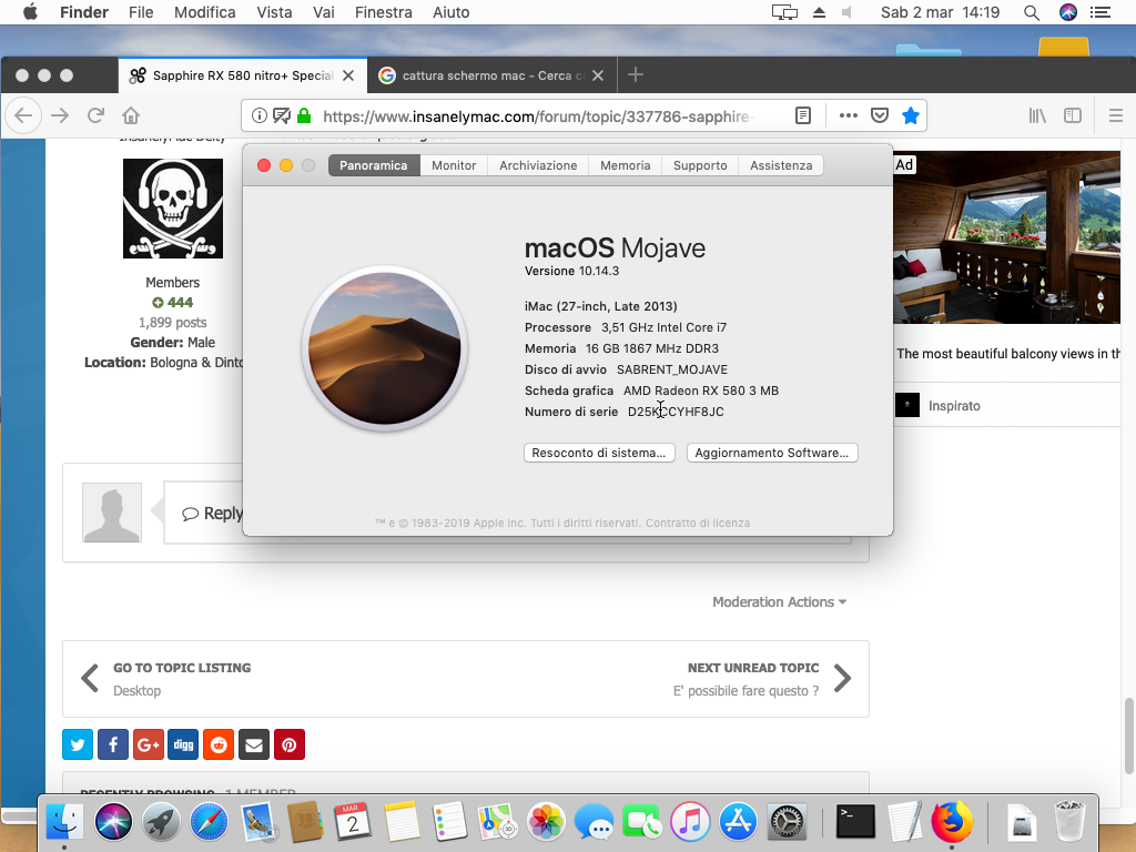

luciuxx63 Posted February 28, 2019 Share Posted February 28, 2019 Hello everyone, I have a video card in description on Mojave but I only see 1024x768 .... just putting a little hands I was successful, first black screen. Do you have any idea to make it work well? Thank you. Link to comment Share on other sites More sharing options...

luciuxx63 Posted March 2, 2019 Author Share Posted March 2, 2019 (edited) Come sempre un grazie e'dovuto.. ma ..... screen.. grazie ancora Edited March 2, 2019 by luciuxx63 Link to comment Share on other sites More sharing options...

luciuxx63 Posted March 4, 2019 Author Share Posted March 4, 2019 Intanto grazie per la risposta. No vedo a 3 MB(!!!) come sopra riportato nello screenshoot (o foto :-)) Proverò anche iltuo Clover.... Link to comment Share on other sites More sharing options...

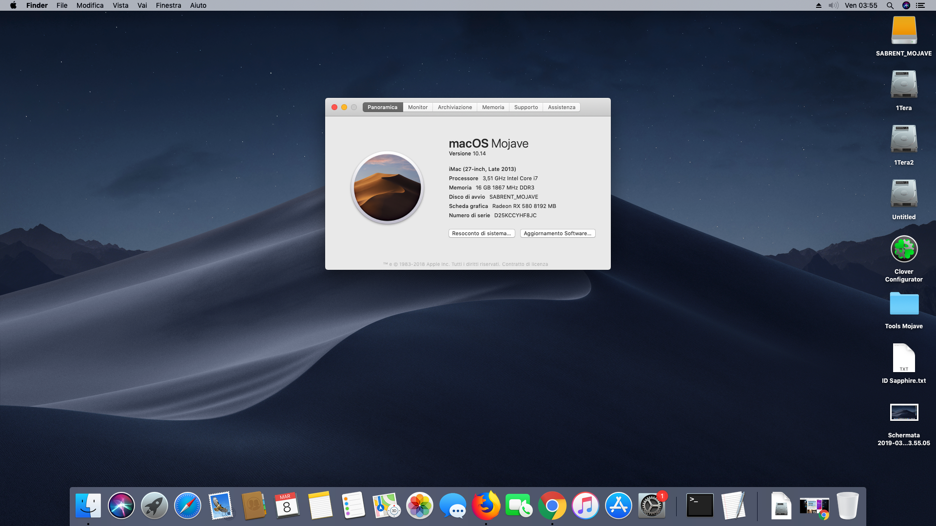

luciuxx63 Posted March 8, 2019 Author Share Posted March 8, 2019 (edited) Beh... alla fine ce l'ho fatta ... allora: inserito ID della scheda viedo tramite Clover Config. (1200 e 67DF) in Config.plist. Acquistato adattatore HDMI - Dieplay Port, tolto Kext_dev_mode, opla'!!! Che guerra!!! Edited March 8, 2019 by luciuxx63 1 Link to comment Share on other sites More sharing options...
