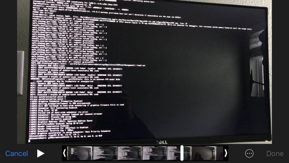

TheAngryYeti Posted February 11, 2019 Share Posted February 11, 2019 So after a gazillion tries with High Sierra, i gave up and decided to try Mojave. I had nothing to lose, afterall. I started from scratch. I reformatted my thumb drive. Made it bootable from the Mojave [url="http://www.insanelymac.com/forum/topic/279450-why-insanelymac-does-not-support-tonymacx86/"]#####[/url]. Booted with it. Selected my language. It installed a little bit. Rebooted. I Booted from the SSD. Installed a bit more. Rebooted. I Booted from the SSD again and it finished the installation. I went through the basic setup and got to the desktop. I ran [url="http://www.insanelymac.com/forum/topic/279450-why-insanelymac-does-not-support-tonymacx86/"]#####[/url] and selected my options and "built" it. Thinking i was a-ok, i decided to reboot, just to make sure all was well. After about 1min, i lose display. I thought i had messed something up in [url="http://www.insanelymac.com/forum/topic/279450-why-insanelymac-does-not-support-tonymacx86/"]#####[/url], so i decided to go back to my mac mini, redo the thumb drive all over again. I go to boot from the thumb drive and when i get to the language selection screen, i lose all USB usage, so i cant even get in to wipe the SSD and start over. So, Mojave is still on the SSD, but i cant get to it because i lose display. Im attaching a screenshot of Verbose mode right before i lose display. I would greatly appreciate any help to get back into it or at least help getting it re-installed!! -Sin Link to comment Share on other sites More sharing options...
Gigamaxx Posted February 13, 2019 Share Posted February 13, 2019 Graphics, what card are you using if any? USB issue try using USBInjectallkext or GenericHXCIUSBkext to get through the install. Place in Clover/Kexts/Other folder. Link to comment Share on other sites More sharing options...
TheAngryYeti Posted February 14, 2019 Author Share Posted February 14, 2019 13 hours ago, Gigamaxx said: Graphics, what card are you using if any? USB issue try using USBInjectallkext or GenericHXCIUSBkext to get through the install. Place in Clover/Kexts/Other folder. No card. Using onboard graphics. I think it’s actually coming from the i5 8400 cpu I’m using, technically. i tried a DP cable today instead of hdmi, but that didn’t help. Same result. Now I’m getting beep codes relating to my onboard graphics. Ugh... my roommate has a few video cards lying around not being used. I’m gonna see if those are supported in my build. -Sin Link to comment Share on other sites More sharing options...
Gigamaxx Posted February 14, 2019 Share Posted February 14, 2019 For the IGPU (cpu graphics) you will need to use a ig platform ID. This can be tested by using the Clover boot menu. use cursor arrows at the clover screen and go to Options tab. Then go to Graphics and set ig platform ID 0x59120000, or other that works for your graphics setup. And also set Inject Intel. Link to comment Share on other sites More sharing options...
TheAngryYeti Posted February 15, 2019 Author Share Posted February 15, 2019 It worked!!! Thanks!!!!!! still have a few issues however. Dunno if you can help... -Sin Link to comment Share on other sites More sharing options...
