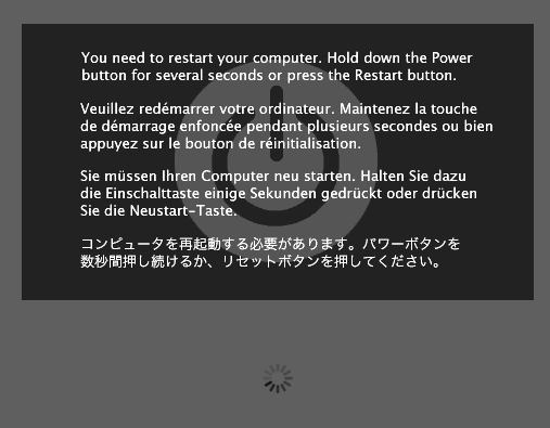

watons Posted November 20, 2006 Share Posted November 20, 2006 My notebook is T60. T2500(2GHz), 1GB RAM, 100GB 5400rpm HD, 14.1in 1400x1050 LCD, 128MB ATI Radeon X1400, CDRW/DVDRW, Intel 802.11abg wireless, Bluetooth/Modem, 1Gb Ethernet Last time I try to install 10.4.8,after installtion then reboot I just see this, So this time I want to install successfully, who can tell me how to do it? which patches should be choose? Link to comment https://www.insanelymac.com/forum/topic/33707-how-to-install-1048-on-t60/ Share on other sites More sharing options...

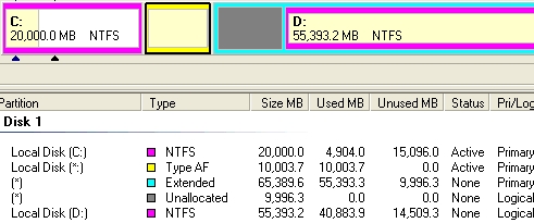

watons Posted November 20, 2006 Author Share Posted November 20, 2006 this is my HD Link to comment https://www.insanelymac.com/forum/topic/33707-how-to-install-1048-on-t60/#findComment-238444 Share on other sites More sharing options...
weichen Posted November 20, 2006 Share Posted November 20, 2006 As for T60, that is a kernel panic ,cased by the IOPCCard.kext. You need to remove it. Since you can't boot with the -s, you need to remove it in the xp. So install the app macdriver. Link to comment https://www.insanelymac.com/forum/topic/33707-how-to-install-1048-on-t60/#findComment-238491 Share on other sites More sharing options...

Menno Posted November 20, 2006 Share Posted November 20, 2006 After -S do, Mount -uw / rm -R /System/Library/Extensions/IOPCCard.kext rm /System/Library/Extensions.mkext rm /System/Library/Extensions.kextcache diskutil repairpermissions / reboot , that should do the trick Link to comment https://www.insanelymac.com/forum/topic/33707-how-to-install-1048-on-t60/#findComment-238531 Share on other sites More sharing options...
