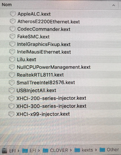

weskos69 Posted December 16, 2018 Share Posted December 16, 2018 Hi, I’m installing my first Hackintosh with following components : Gigabyte H370 HD3 (ALC887 audio) i7 8700 RX 580 I created my Clover bootable USB key with Mojave 10.14.2 I retrieved from a tutorial a « pre-packaged » EFI included some kexts not all usefull (and maybe incompatible ?). All components works very well except motherboard audio. On audio devices panel I can see my DisplayPort screen but not my motherboard audio. I have AppleALC et Lilu Kexts in other directory of my EFI, and I tested to inject recommended layout values for ALC887, audio still not working…. Please find in attachment my kexts content and my config.plist Thank you guys for your help ! config.plist Link to comment https://www.insanelymac.com/forum/topic/336917-gigabyte-h370-hd3-audio-doesnt-work-mojave-10142/ Share on other sites More sharing options...
SavageAUS Posted December 18, 2018 Share Posted December 18, 2018 (edited) On 12/17/2018 at 6:57 AM, weskos69 said: Hi, I’m installing my first Hackintosh with following components : Gigabyte H370 HD3 (ALC887 audio) i7 8700 RX 580 I created my Clover bootable USB key with Mojave 10.14.2 I retrieved from a tutorial a « pre-packaged » EFI included some kexts not all usefull (and maybe incompatible ?). All components works very well except motherboard audio. On audio devices panel I can see my DisplayPort screen but not my motherboard audio. I have AppleALC et Lilu Kexts in other directory of my EFI, and I tested to inject recommended layout values for ALC887, audio still not working…. Please find in attachment my kexts content and my config.plist Thank you guys for your help ! config.plist Why so many network kexts? Work out which ones you need and get rid of the rest. Get rid of intelgraphicsfixup and replace with latest Lilu and Whatevergreen. Grab the latest AppleALC and replace the old one. Try the config attached, backup yours first. Also check out Intel Framebuffer patching using WhateverGreen for audio injection and iGPU. Sent from my iPhone using Tapatalk config.plist Edited December 18, 2018 by SavageAUS Link to comment https://www.insanelymac.com/forum/topic/336917-gigabyte-h370-hd3-audio-doesnt-work-mojave-10142/#findComment-2654324 Share on other sites More sharing options...
weskos69 Posted December 25, 2018 Author Share Posted December 25, 2018 Hi, I followed all your recommendations : I got ride useless kexts, I installed Whatevergreen and I used your config.plist Now everything work perfectly Thank you so much ! 1 Link to comment https://www.insanelymac.com/forum/topic/336917-gigabyte-h370-hd3-audio-doesnt-work-mojave-10142/#findComment-2655455 Share on other sites More sharing options...
