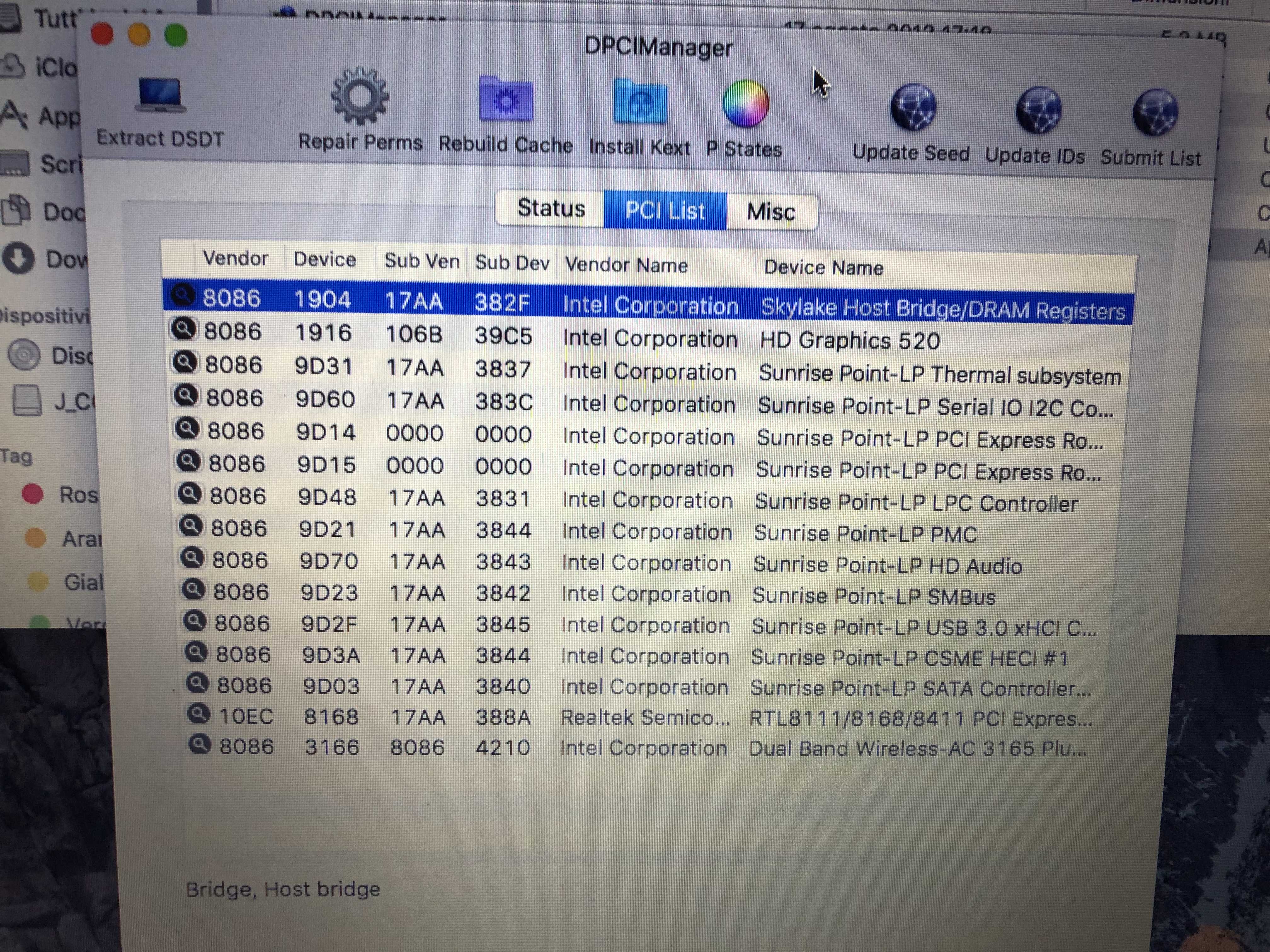

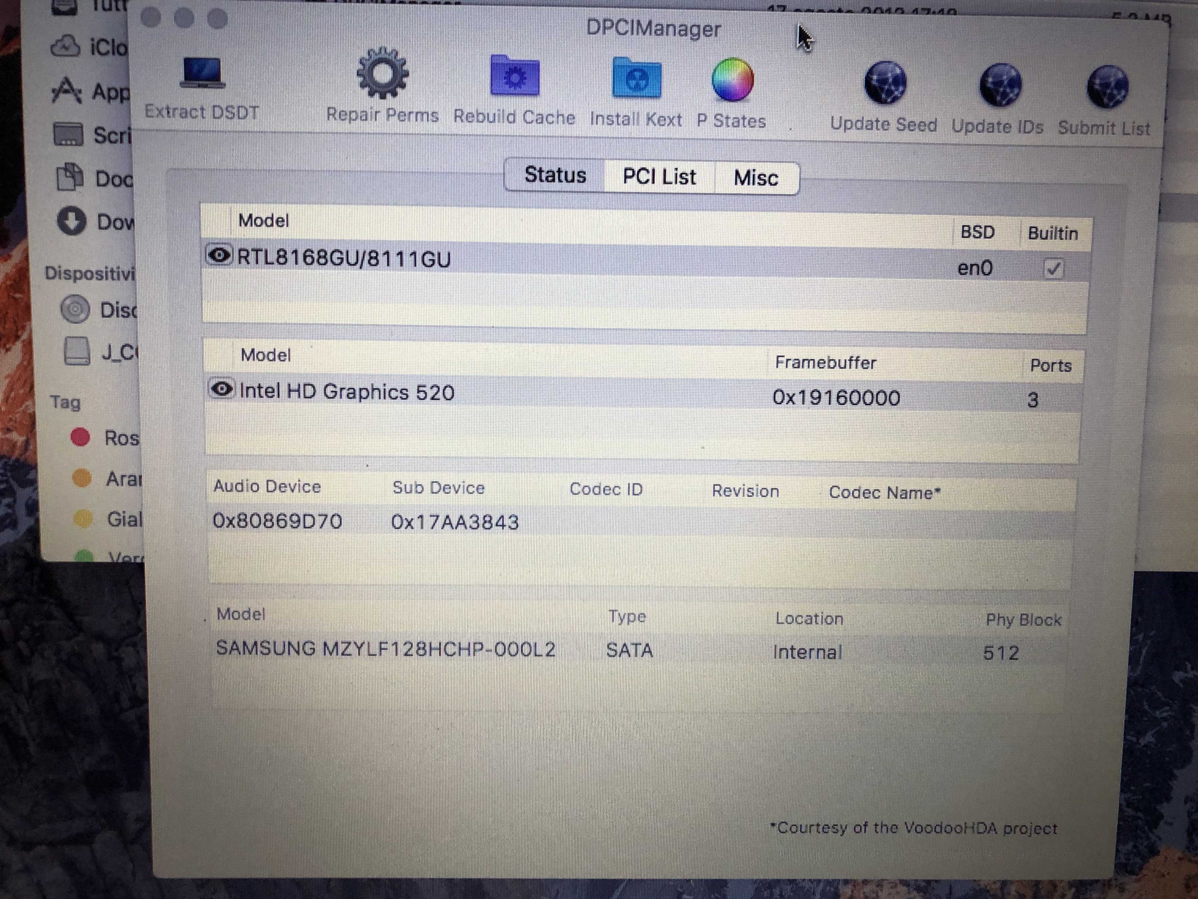

ricblade Posted December 4, 2018 Author Share Posted December 4, 2018 Perfetto, grazie! Scheda video riconosciuta correttamente, c'è da fixare la luminosità. Per il mouse ed eventualmente il wi-fi sai dirmi qualcosa? 1 Link to comment https://www.insanelymac.com/forum/topic/336726-installazione-lenovo-ideapad-v320/page/2/#findComment-2651862 Share on other sites More sharing options...
gengik84 Posted December 4, 2018 Share Posted December 4, 2018 vai al post n2 della mia guida, posta tutto il materiale Link to comment https://www.insanelymac.com/forum/topic/336726-installazione-lenovo-ideapad-v320/page/2/#findComment-2651863 Share on other sites More sharing options...
ricblade Posted December 4, 2018 Author Share Posted December 4, 2018 MacBook Pro di Galadriel.ioreg HackInfo_Report.zip Link to comment https://www.insanelymac.com/forum/topic/336726-installazione-lenovo-ideapad-v320/page/2/#findComment-2651866 Share on other sites More sharing options...
gengik84 Posted December 4, 2018 Share Posted December 4, 2018 kext ethernet da mettere i EFI wifi intel e quindi non compatibile poi prima di riavvia esegui questo fix Fix_en0.zip Poi nella gui di clover, premi F4 attendi 30 secondi e poi avvia normalmente allega poi la cartella clover Link to comment https://www.insanelymac.com/forum/topic/336726-installazione-lenovo-ideapad-v320/page/2/#findComment-2651867 Share on other sites More sharing options...

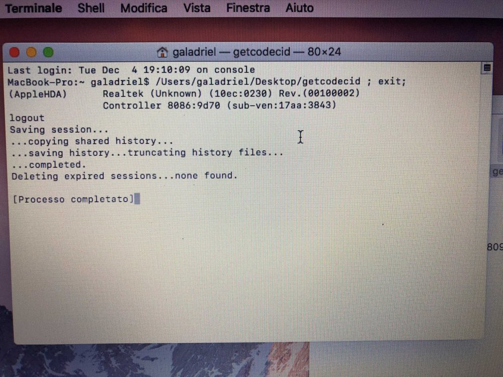

ricblade Posted December 4, 2018 Author Share Posted December 4, 2018 come vedo il codec? Link to comment https://www.insanelymac.com/forum/topic/336726-installazione-lenovo-ideapad-v320/page/2/#findComment-2651957 Share on other sites More sharing options...
gengik84 Posted December 4, 2018 Share Posted December 4, 2018 Esegui questo allegato posta il risultato, vediamo se da qualche info getcodecid (Andy.V).zip Link to comment https://www.insanelymac.com/forum/topic/336726-installazione-lenovo-ideapad-v320/page/2/#findComment-2651959 Share on other sites More sharing options...

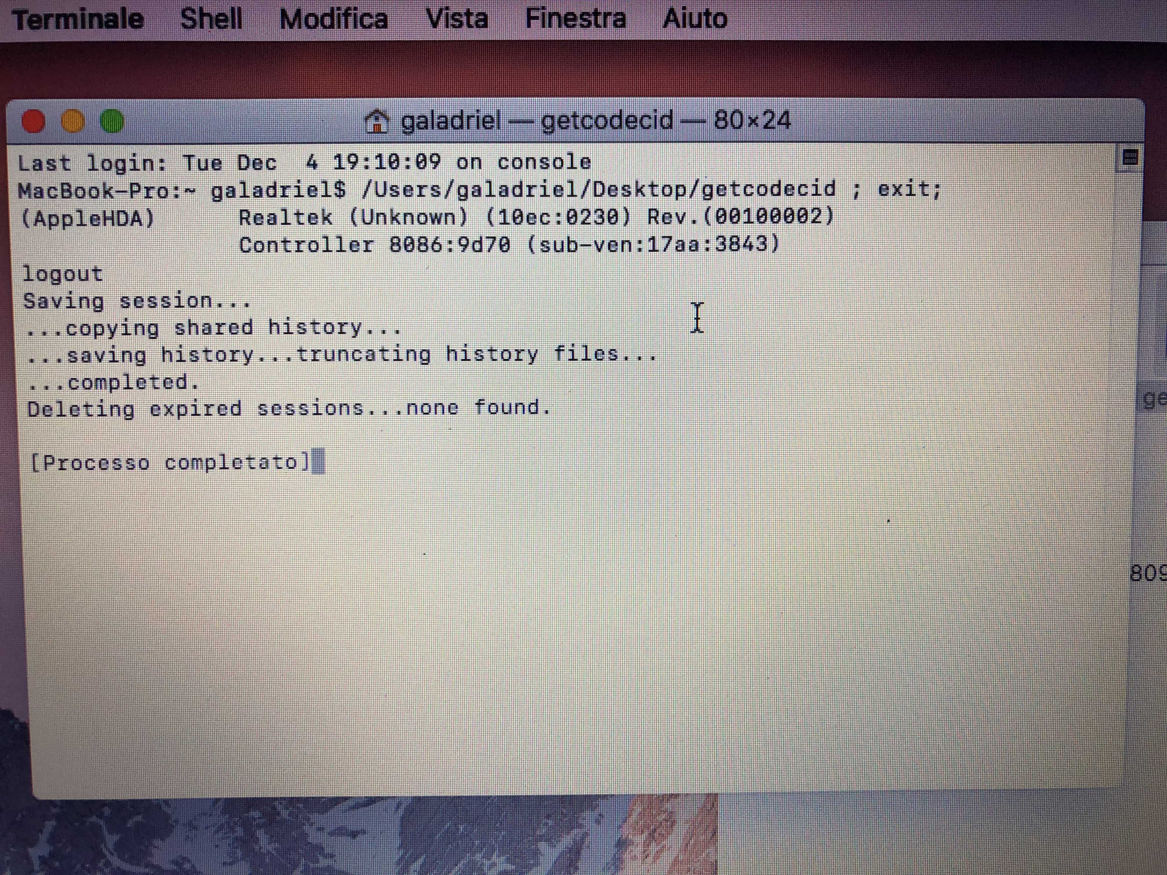

ricblade Posted December 4, 2018 Author Share Posted December 4, 2018 Link to comment https://www.insanelymac.com/forum/topic/336726-installazione-lenovo-ideapad-v320/page/2/#findComment-2651961 Share on other sites More sharing options...
gengik84 Posted December 4, 2018 Share Posted December 4, 2018 sul config, nella parte devices/audio/inject scrivi 13 salva,riavvia vai in preferenze di sistema/audio/uscita e controlla Link to comment https://www.insanelymac.com/forum/topic/336726-installazione-lenovo-ideapad-v320/page/2/#findComment-2651963 Share on other sites More sharing options...
ricblade Posted December 4, 2018 Author Share Posted December 4, 2018 No, non la vede nemmeno così Link to comment https://www.insanelymac.com/forum/topic/336726-installazione-lenovo-ideapad-v320/page/2/#findComment-2651966 Share on other sites More sharing options...
gengik84 Posted December 4, 2018 Share Posted December 4, 2018 se è ALC230 l'unico layout è quello hai windows installato? nel caso, per conferma cerca info a riguardo Link to comment https://www.insanelymac.com/forum/topic/336726-installazione-lenovo-ideapad-v320/page/2/#findComment-2651970 Share on other sites More sharing options...
ricblade Posted December 4, 2018 Author Share Posted December 4, 2018 no, non ho windows. Vediamo se riesco a trovare altre info. Link to comment https://www.insanelymac.com/forum/topic/336726-installazione-lenovo-ideapad-v320/page/2/#findComment-2651978 Share on other sites More sharing options...
gengik84 Posted December 4, 2018 Share Posted December 4, 2018 Altrimenti rimane voodooHDA te l'allego, colloca i kext in EFI e rimuovi AppleALC Archivio.zip Link to comment https://www.insanelymac.com/forum/topic/336726-installazione-lenovo-ideapad-v320/page/2/#findComment-2651980 Share on other sites More sharing options...
ricblade Posted December 4, 2018 Author Share Posted December 4, 2018 Ho risolto sostituendo AppleALC con l'ultima versione, adesso l'audio va. Rimane solo un ultimo problema, cioè lo sleep. Quando torna dallo sleep si riavvia. In ogni caso non so come ringraziarti, sei stato preziosissimo, attento e paziente. Grazie di cuore, davvero. Link to comment https://www.insanelymac.com/forum/topic/336726-installazione-lenovo-ideapad-v320/page/2/#findComment-2651984 Share on other sites More sharing options...
