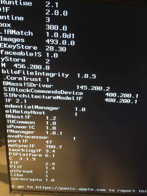

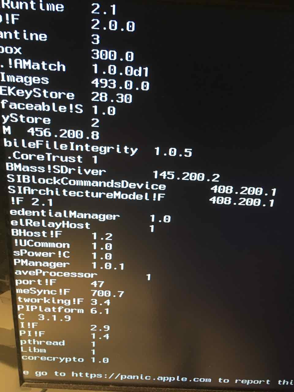

shmn Posted October 30, 2018 Share Posted October 30, 2018 Hi, I have been trying to follow @RehabMan 's guide to disable my dGPU ( https://www.tonymacx86.com/threads/guide-disabling-discrete-graphics-in-dual-gpu-laptops.163772/ ) for two days now, but haven't found a way to disable my 1080 Ti on my desktop Clover hack. I have a dual-boot (Win/Mac) machine on a Z370 Aorus 7. Since there's no nvidia drivers for Mojave atm, I want to stick with the iGPU under Mac, but still use the 1080 Ti under Win. The hack boots just fine when I remove the 1080 Ti, if it's plugged in via PCIe I get a kernel panic. Please find attached my ACPI folder, my clover config.plist and the kernel panic details. Might there even be a less hacky way than patching these ACPI files? I appreciate any kind of support! Thanks! ACPI.zip config.plist systemReport.txt Link to comment Share on other sites More sharing options...

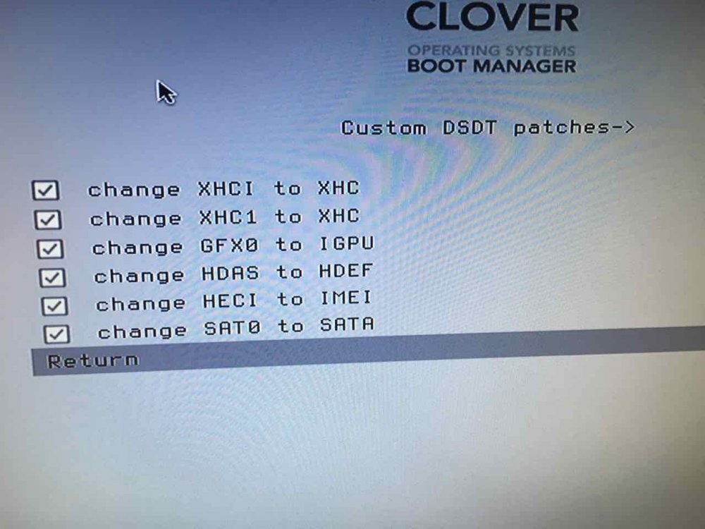

shmn Posted October 30, 2018 Author Share Posted October 30, 2018 6 hours ago, MaLd0n said: DSDT.aml.zip use change GFX0 to IGPU 47465830 49475055 change HDAS to HDEF 48444153 48444546 change HECI to IMEI 48454349 494d4549 change SAT0 to SATA 53415430 53415441 Sry, guess I was too euphoric, just changed my HDD configuration in the BIOS (removed RAID 1 since it's not supported). I then replaced the Strings you mentioned, but I can no longer boot into macOS :/ How can the two HDDs destroy the working patch? Attached is the new origin DSDT that Clover extracted. Would appreciate your help again, not sure what I'm doing wrong all the time... changedACPI.zip Link to comment Share on other sites More sharing options...
MaLd0n Posted October 30, 2018 Share Posted October 30, 2018 1 hour ago, shmn said: Sry, guess I was too euphoric, just changed my HDD configuration in the BIOS (removed RAID 1 since it's not supported). I then replaced the Strings you mentioned, but I can no longer boot into macOS :/ How can the two HDDs destroy the working patch? Attached is the new origin DSDT that Clover extracted. Would appreciate your help again, not sure what I'm doing wrong all the time... changedACPI.zip post a full dump for full solution RunMe.app Link to comment Share on other sites More sharing options...
shmn Posted October 30, 2018 Author Share Posted October 30, 2018 11 minutes ago, MaLd0n said: post a full dump for full solution RunMe.app Thanks, Log is attached. Please note that I had to REMOVE the 1080 Ti in order to be able to boot and run your app at all. The customPatches picture shows the patches I added in CloverConfigurator, I wasn't able to create a working DSDL.aml patch file myself. Definitely willing to donate if we can make this work :) Thx! Send me Simons-Hackintosh.zip NewestOrigin.zip Link to comment Share on other sites More sharing options...

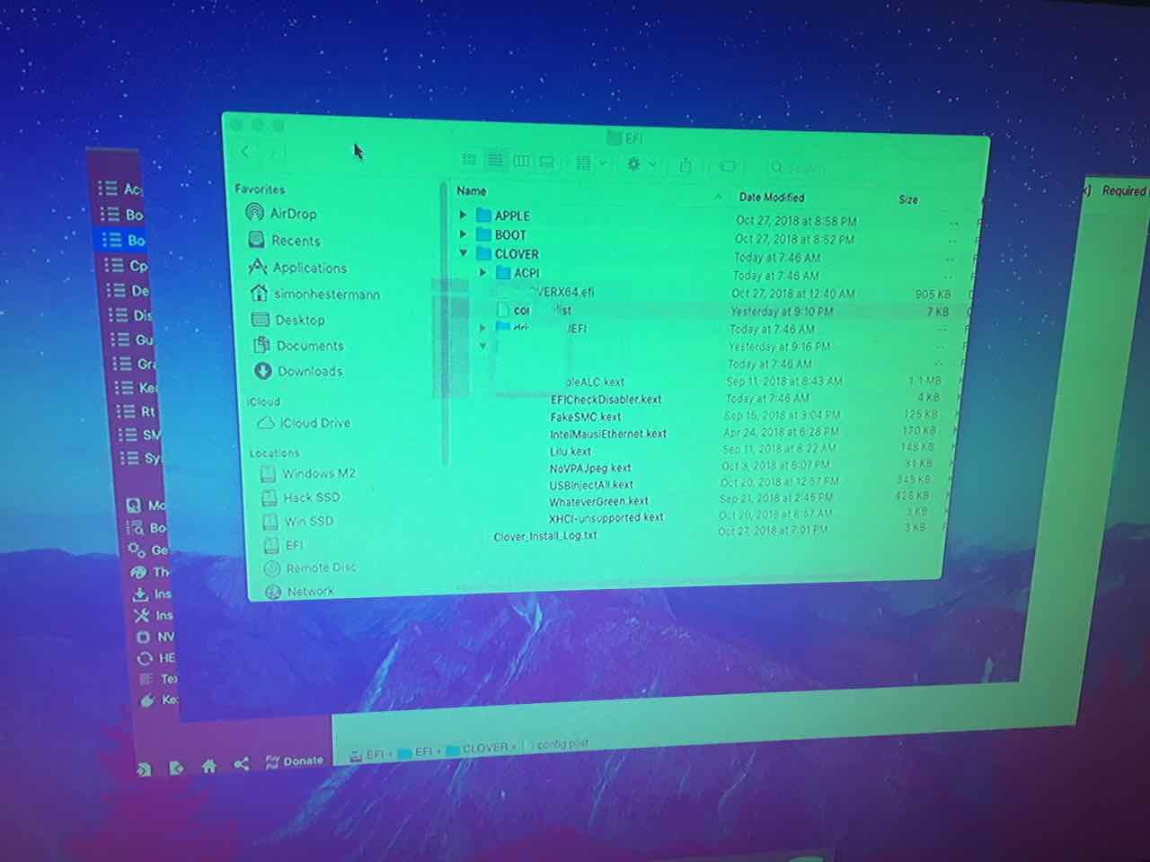

shmn Posted October 31, 2018 Author Share Posted October 31, 2018 (edited) 6 hours ago, MaLd0n said: CLOVER.zip use last clover version https://www8.zippyshare.com/d/X6W8osAv/2940/Clover_v2.4k_r4726.pkg.zip Thx, It's booting now and all hard drives show up, but I'm getting severe graphics glitches/jitter (plz see attached image). I updated Clover and replaced the Clover folder inside EFI. Something wrong with the kexts maybe? Edited October 31, 2018 by shmn Link to comment Share on other sites More sharing options...
MaLd0n Posted October 31, 2018 Share Posted October 31, 2018 5 hours ago, shmn said: Thx, It's booting now and all hard drives show up, but I'm getting severe graphics glitches/jitter (plz see attached image). I updated Clover and replaced the Clover folder inside EFI. Something wrong with the kexts maybe? extract new SEND_ME, i need check Link to comment Share on other sites More sharing options...
shmn Posted October 31, 2018 Author Share Posted October 31, 2018 6 minutes ago, MaLd0n said: extract new SEND_ME, i need check Here it is> Send me SimonsHckintosh2.zip Link to comment Share on other sites More sharing options...
MaLd0n Posted October 31, 2018 Share Posted October 31, 2018 3 minutes ago, shmn said: Here it is> Send me SimonsHckintosh2.zip i pout ur default video config check if work config.plist.zip Link to comment Share on other sites More sharing options...
shmn Posted October 31, 2018 Author Share Posted October 31, 2018 38 minutes ago, MaLd0n said: i pout ur default video config check if work config.plist.zip Unfortunately it doesn't boot with your new config... It gets stuck somewhere in the boot screen. Link to comment Share on other sites More sharing options...
MaLd0n Posted October 31, 2018 Share Posted October 31, 2018 u need add a correct video config, is just it my old config with pink screen i use IntelGFX 59128086 ig-platform-id 59120003 Check InjectIntel Link to comment Share on other sites More sharing options...

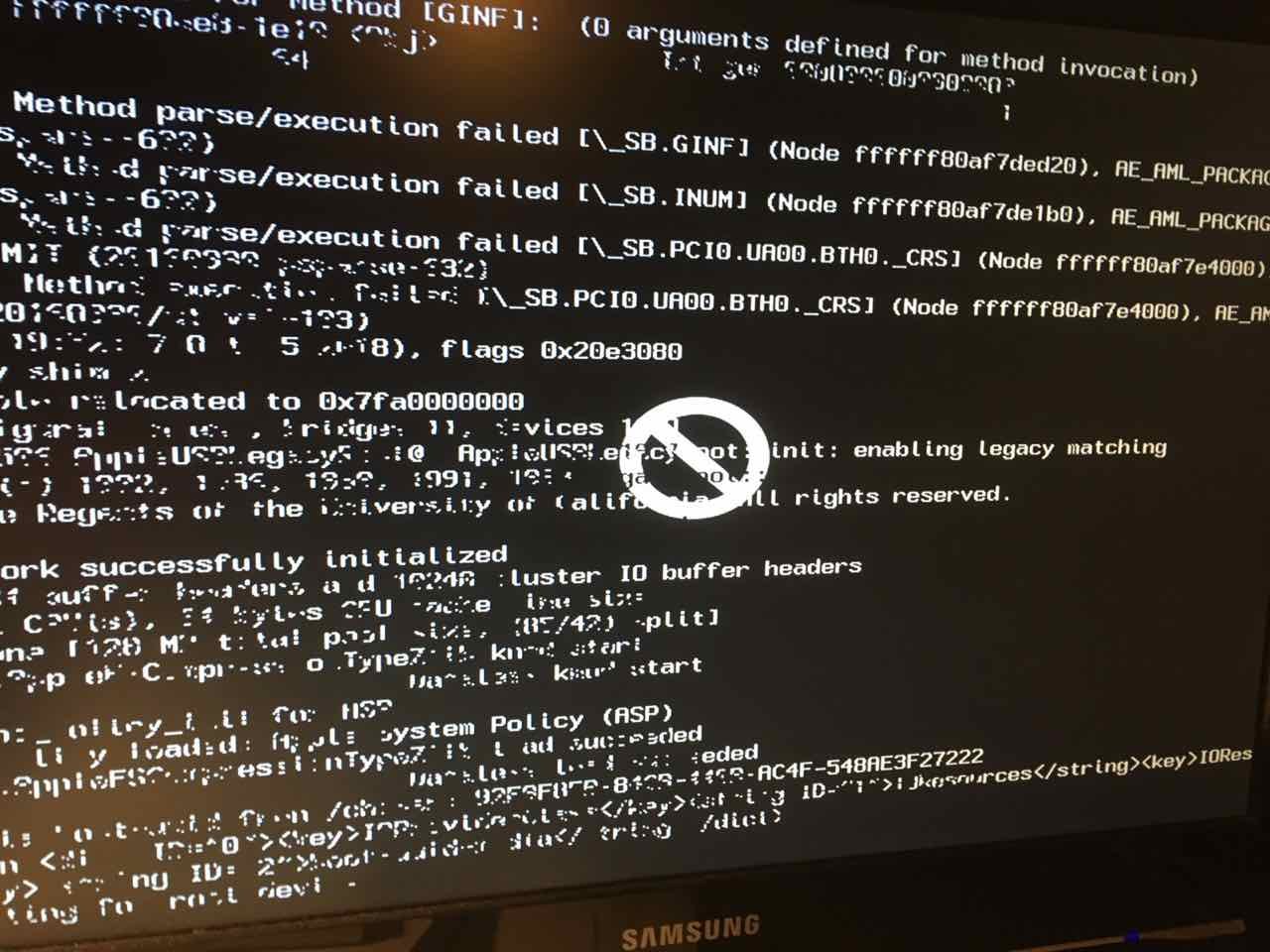

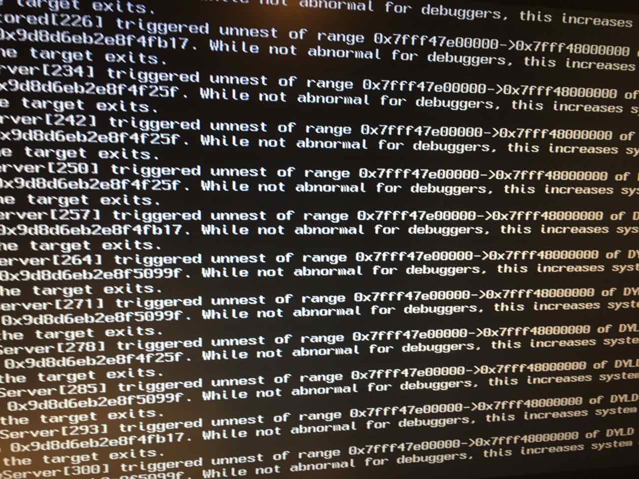

shmn Posted October 31, 2018 Author Share Posted October 31, 2018 2 hours ago, MaLd0n said: u need add a correct video config, is just it my old config with pink screen i use IntelGFX 59128086 ig-platform-id 59120003 Check InjectIntel I wasn't able to make it work with your clover package, so I simply used your DSDT.aml with my previous clover folder. It SUCCESSFULLY booted ONCE. I later rebooted and now I'm stuck at either of these two boot screens: Link to comment Share on other sites More sharing options...
