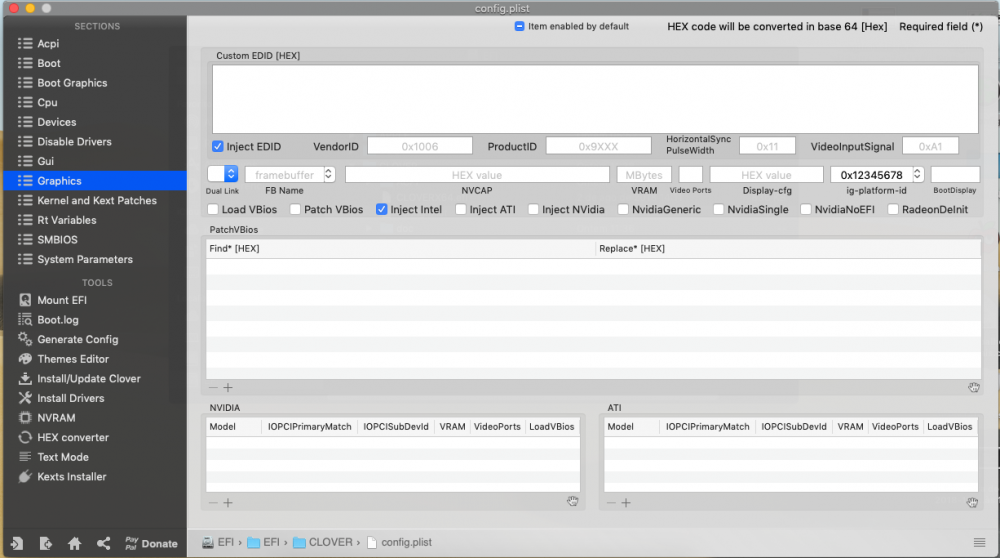

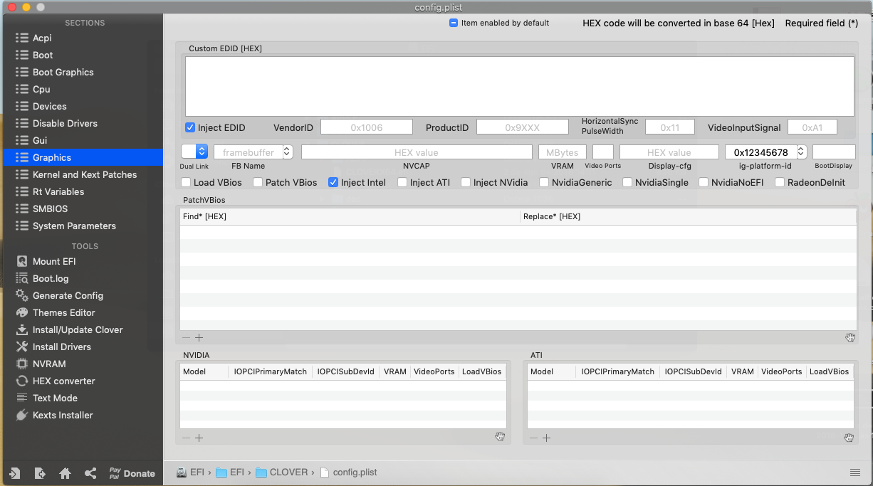

EduardoMenezes Posted October 23, 2018 Share Posted October 23, 2018 (edited) Good evening, friends of InsanelyMac. I have an Acer Aspire E5-571 notebook with Intel processor and Intel Graphics 5500 hd graphics card. When I was using the Sierra, the video card was recognized without problems. Now that I'm using Mojave I can not get the acceleration to work. I've been researching something about having to use Lilu.kext and whatevergreen.kext but I do not have enough knowledge to solve this problem. I need the help of someone who can explain to me how to solve this acceleration problem. I'm sure it will be of great value to other users like me. Thank you very much. Edited November 22, 2018 by EduardoMenezes Problem Solved Link to comment https://www.insanelymac.com/forum/topic/336114-acer-aspire-intel-hd-graphics-5500-with-mojave-solved-resolvido/ Share on other sites More sharing options...

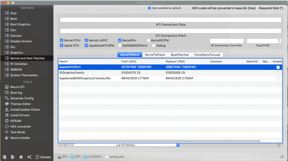

EduardoMenezes Posted October 23, 2018 Author Share Posted October 23, 2018 Good afternoon. Thank you for your interest in helping me. I am attaching my config.plist. config.plist Link to comment https://www.insanelymac.com/forum/topic/336114-acer-aspire-intel-hd-graphics-5500-with-mojave-solved-resolvido/#findComment-2642620 Share on other sites More sharing options...

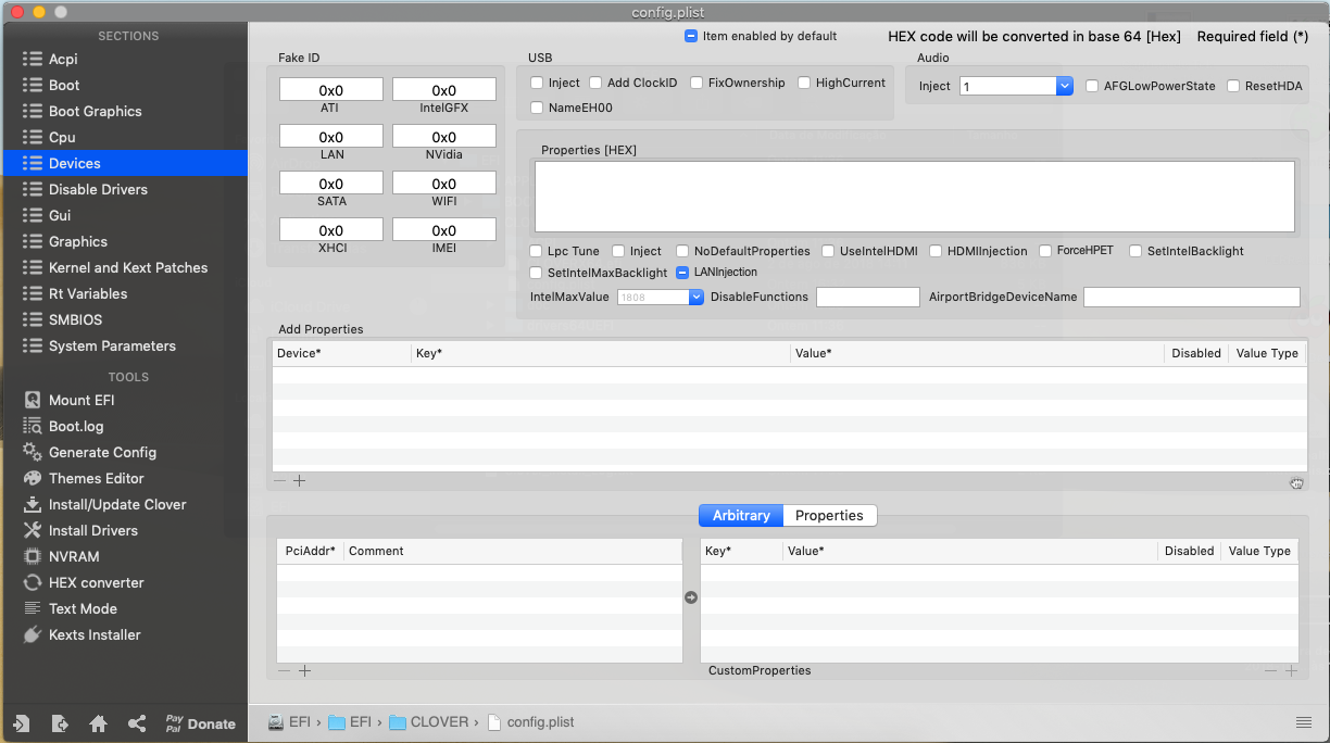

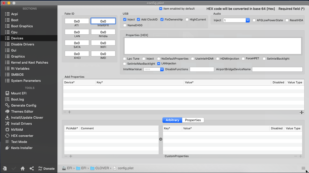

foskvs Posted October 23, 2018 Share Posted October 23, 2018 Remove fake-ids from Devices section. 1 Link to comment https://www.insanelymac.com/forum/topic/336114-acer-aspire-intel-hd-graphics-5500-with-mojave-solved-resolvido/#findComment-2642653 Share on other sites More sharing options...
EduardoMenezes Posted October 23, 2018 Author Share Posted October 23, 2018 Good night. Unfortunately it did not work out. Removing Fake-Id from Device Section, the notebook restarts at boot time. Link to comment https://www.insanelymac.com/forum/topic/336114-acer-aspire-intel-hd-graphics-5500-with-mojave-solved-resolvido/#findComment-2642704 Share on other sites More sharing options...

Andres ZeroCross Posted November 1, 2018 Share Posted November 1, 2018 On 10/31/2018 at 8:49 PM, EduardoMenezes said: Good Morning. Could anyone help me solve this problem with my video card? I can not get graphic acceleration. Nothing is right. Does anyone have a step-by-step? ig-platform-id for IHD 5500 is 0x16260006 not 0x12345678 Link to comment https://www.insanelymac.com/forum/topic/336114-acer-aspire-intel-hd-graphics-5500-with-mojave-solved-resolvido/#findComment-2644425 Share on other sites More sharing options...
EduardoMenezes Posted November 1, 2018 Author Share Posted November 1, 2018 (edited) Hello Hervé and Andres Zerocross. I fully agree that you should use ig-platform-id = 0x16260006. The problem is that with Intel Inject = on the notebook resets at boot time. I can only load if I turn off Inject Intel or if I use ig-platform-id = 0x12345678. This is missing some other configuration. Edited November 1, 2018 by EduardoMenezes Link to comment https://www.insanelymac.com/forum/topic/336114-acer-aspire-intel-hd-graphics-5500-with-mojave-solved-resolvido/#findComment-2644436 Share on other sites More sharing options...
Andres ZeroCross Posted November 2, 2018 Share Posted November 2, 2018 13 hours ago, EduardoMenezes said: Hello Hervé and Andres Zerocross. I fully agree that you should use ig-platform-id = 0x16260006. The problem is that with Intel Inject = on the notebook resets at boot time. I can only load if I turn off Inject Intel or if I use ig-platform-id = 0x12345678. This is missing some other configuration. Then you need to patch min stolen patch, just use latest Lilu.kext and Whatevergreen, and use patch of mem stolen at your config.plist Link to comment https://www.insanelymac.com/forum/topic/336114-acer-aspire-intel-hd-graphics-5500-with-mojave-solved-resolvido/#findComment-2644540 Share on other sites More sharing options...

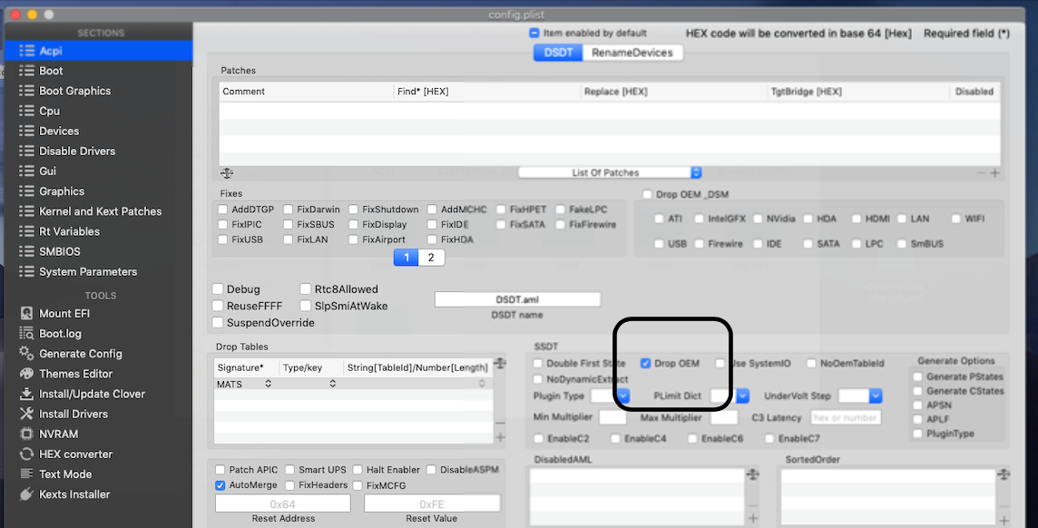

EduardoMenezes Posted November 4, 2018 Author Share Posted November 4, 2018 On 11/1/2018 at 5:59 PM, Hervé said: Try this one. config.plist Please post your patched tables or, better, your entire Clover EFI folder so that we know what you use... Good evening, Hervé. I'm attaching the zipped EFI folder with whatever you asked for. On the ACPI tab on SSDT I unchecked OEM Droop because the notebook resets during boot. It's not panic. It resets. Another friend Andres Zerocross commented on Lilu.kext and Whatever.Kext but I'm doubtful how to proceed. I already put it in the S/L/E folder without result. CLOVER.zip Link to comment https://www.insanelymac.com/forum/topic/336114-acer-aspire-intel-hd-graphics-5500-with-mojave-solved-resolvido/#findComment-2645426 Share on other sites More sharing options...
Andres ZeroCross Posted November 5, 2018 Share Posted November 5, 2018 Good evening, Hervé. I'm attaching the zipped EFI folder with whatever you asked for. On the ACPI tab on SSDT I unchecked OEM Droop because the notebook resets during boot. It's not panic. It resets. Another friend Andres Zerocross commented on Lilu.kext and Whatever.Kext but I'm doubtful how to proceed. I already put it in the S/L/E folder without result. CLOVER.zipAfter use lilu.kext and whatevergreen.kext then you still need to set fb-min stolen patch at your device properties inside config.plist. or whatevergeen won't work.Sent from my Mi Note 2 using Tapatalk Link to comment https://www.insanelymac.com/forum/topic/336114-acer-aspire-intel-hd-graphics-5500-with-mojave-solved-resolvido/#findComment-2645615 Share on other sites More sharing options...

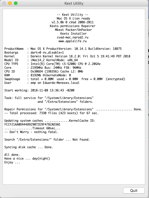

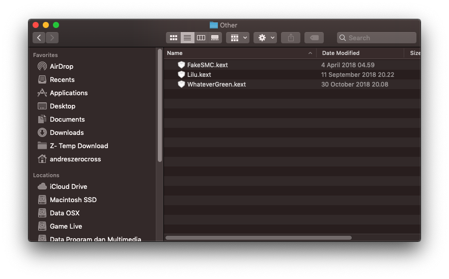

Andres ZeroCross Posted November 7, 2018 Share Posted November 7, 2018 1. Make sure you remove all 3rd party kext like FakeSMC.kext, Lilu.kext, WhateverGreen.kext and other add on kext from System/Library/Extensions or in Library/Extensions. After that rebuild Kext Cache with Kext Utility I repeat make sure there is no add on kext from S/L/E or L/E. Use this step to avoid duplicate kext and "unpredicted problems". 2. After that,, mount your EFI partition,, then Delete your Entire CLOVER folder inside EFI folder. And replace with mine (i upload the new Clover folder for your). The configuration include your DSDT and SSDT (brightness fix, minstolen patch fix, usb fix, ehc1 and ehc2 fix and many important patch for your system). I assume your device use RTL8168 Ethernet, so i use RTL8111.kext for your Ethernet. And i don't what is your wifi card (we can face it later). Try it and give report as soon as possible. CLOVER.zip Link to comment https://www.insanelymac.com/forum/topic/336114-acer-aspire-intel-hd-graphics-5500-with-mojave-solved-resolvido/#findComment-2646111 Share on other sites More sharing options...
EduardoMenezes Posted November 7, 2018 Author Share Posted November 7, 2018 2 hours ago, Andres ZeroCross said: 1. Make sure you remove all 3rd party kext like FakeSMC.kext, Lilu.kext, WhateverGreen.kext and other add on kext from System/Library/Extensions or in Library/Extensions. After that rebuild Kext Cache with Kext Utility I repeat make sure there is no add on kext from S/L/E or L/E. Use this step to avoid duplicate kext and "unpredicted problems". 2. After that,, mount your EFI partition,, then Delete your Entire CLOVER folder inside EFI folder. And replace with mine (i upload the new Clover folder for your). The configuration include your DSDT and SSDT (brightness fix, minstolen patch fix, usb fix, ehc1 and ehc2 fix and many important patch for your system). I assume your device use RTL8168 Ethernet, so i use RTL8111.kext for your Ethernet. And i don't what is your wifi card (we can face it later). Try it and give report as soon as possible. CLOVER.zip Good evening. Following his script and replacing my Clover folder with his own, he caused the notebook to restart during boot. I captured an image before resetting. So I returned to my Clover folder and I am attaching, as per your previous message. meu arquivo CLOVER.zip Link to comment https://www.insanelymac.com/forum/topic/336114-acer-aspire-intel-hd-graphics-5500-with-mojave-solved-resolvido/#findComment-2646174 Share on other sites More sharing options...

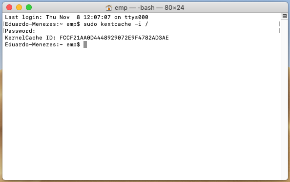

Andres ZeroCross Posted November 8, 2018 Share Posted November 8, 2018 Good evening. Following his script and replacing my Clover folder with his own, he caused the notebook to restart during boot. I captured an image before resetting. So I returned to my Clover folder and I am attaching, as per your previous message.meu arquivo CLOVER.zipOpen terminal and type "sudo kextcache -i /" and press enter, then input the pasword and press enter.Copy the log and paste it hereSent from my Mi Note 2 using Tapatalk Link to comment https://www.insanelymac.com/forum/topic/336114-acer-aspire-intel-hd-graphics-5500-with-mojave-solved-resolvido/#findComment-2646203 Share on other sites More sharing options...

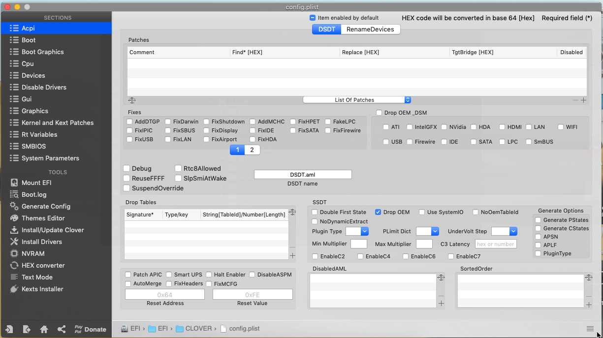

Andres ZeroCross Posted November 8, 2018 Share Posted November 8, 2018 (edited) Are you sure that you only use 3 add on kexts??? No VoodooPS2Controller.kext and another kexts??? Now DELETE all of your CLOVER folder,, and and use mine (i attached it), i make mistake before,, forgot to patch minstolen patch at ssdt-0.aml (sorry). Now try it again, and give me report as soon as possible. CLOVER.zip Edited November 8, 2018 by Andres ZeroCross Make it simple Link to comment https://www.insanelymac.com/forum/topic/336114-acer-aspire-intel-hd-graphics-5500-with-mojave-solved-resolvido/#findComment-2646205 Share on other sites More sharing options...
EduardoMenezes Posted November 8, 2018 Author Share Posted November 8, 2018 8 hours ago, Andres ZeroCross said: Are you sure that you only use 3 add on kexts??? No VoodooPS2Controller.kext and another kexts??? Now DELETE all of your CLOVER folder,, and and use mine (i attached it), i make mistake before,, forgot to patch minstolen patch at ssdt-0.aml (sorry). Now try it again, and give me report as soon as possible. CLOVER.zip Good Morning. I downloaded this last your Clover folder that you attached and I used the command "sudo kextcache -i /" in the terminal. Restart the notebook but it continues to reset during boot. I am attaching the command log "sudo kextcache -i /" to you as per request. I had to go back to my clover folder to use the notebook. If you want you can access the notebook remotely. After all if we can solve this, I can share the solution with other people in Brazil. Link to comment https://www.insanelymac.com/forum/topic/336114-acer-aspire-intel-hd-graphics-5500-with-mojave-solved-resolvido/#findComment-2646273 Share on other sites More sharing options...

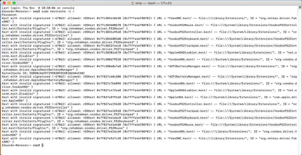

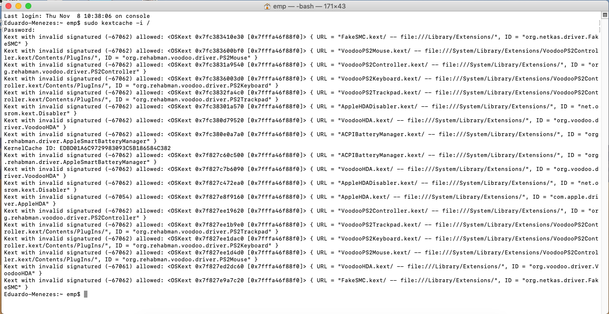

Andres ZeroCross Posted November 8, 2018 Share Posted November 8, 2018 (edited) 4 minutes ago, EduardoMenezes said: Good Morning. I downloaded this last your Clover folder that you attached and I used the command "sudo kextcache -i /" in the terminal. Restart the notebook but it continues to reset during boot. I am attaching the command log "sudo kextcache -i /" to you as per request. I had to go back to my clover folder to use the notebook. If you want you can access the notebook remotely. After all if we can solve this, I can share the solution with other people in Brazil. As you can see, you did wrong about my instructions. I already tell you "REMOVE ALL 3rd party kext from Library/Extensions and System/Library/Extensions". But as per log i can see FakeSMC. VoodooPS2Controller.kext, VoodooHDA.kext, AppleHDADisabler.kext, ACPIBatteryManager.kext are still at Library/Extensions and System/Library/Extensions. Did you read my comment above???? Edited November 8, 2018 by Andres ZeroCross Link to comment https://www.insanelymac.com/forum/topic/336114-acer-aspire-intel-hd-graphics-5500-with-mojave-solved-resolvido/#findComment-2646275 Share on other sites More sharing options...
EduardoMenezes Posted November 8, 2018 Author Share Posted November 8, 2018 2 minutes ago, Andres ZeroCross said: As you can see, you did wrong about my instructions. I already tell you "REMOVE ALL 3rd party kext from Library/Extensions and System/Library/Extensions". But as per log i can see FakeSMC. VoodooPS2Controller.kext, VoodooHDA.kext, AppleHDADisabler.kext, ACPIBatteryManager.kext are still at Library/Extensions and System/Library/Extensions. Did you read my comment above???? I understand. I'll redo and return information. Link to comment https://www.insanelymac.com/forum/topic/336114-acer-aspire-intel-hd-graphics-5500-with-mojave-solved-resolvido/#findComment-2646277 Share on other sites More sharing options...

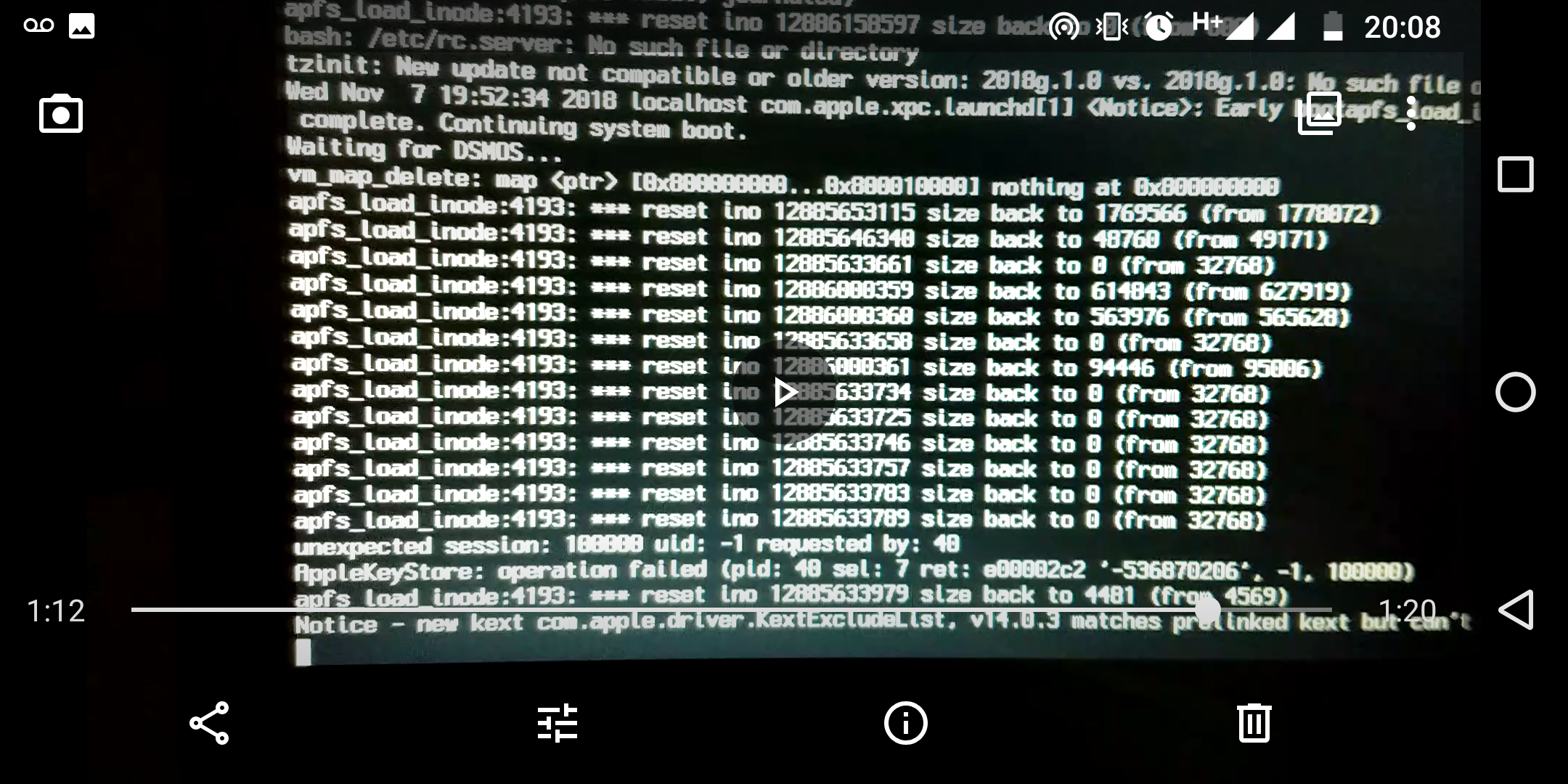

EduardoMenezes Posted November 8, 2018 Author Share Posted November 8, 2018 1 hour ago, Andres ZeroCross said: Correct, remove it. And use my Clover folder. If problem still persist, can you take video?? I need to see the log. Sent from my Mi Note 2 using Tapatalk Yes, I'm using your Clover folder. Follow the video link. https://drive.google.com/file/d/1UfXCdAalnHEE4-Xyih4hIbadAdJ60oCf/view?usp=sharing Link to comment https://www.insanelymac.com/forum/topic/336114-acer-aspire-intel-hd-graphics-5500-with-mojave-solved-resolvido/#findComment-2646303 Share on other sites More sharing options...
Andres ZeroCross Posted November 8, 2018 Share Posted November 8, 2018 (edited) 6 minutes ago, EduardoMenezes said: Yes, I'm using your Clover folder. Follow the video link. https://drive.google.com/file/d/1UfXCdAalnHEE4-Xyih4hIbadAdJ60oCf/view?usp=sharing It's still related to graphics. Can you fast response?? You take too long to reply Sent from my Mi Note 2 using Tapatalk Just tell me when you can make fast reply to this forum,, there is too many configurations that i must reply (i joint many forums and group). So it make me no focus if you reply the forum discussion for so long. Edited November 8, 2018 by Andres ZeroCross Link to comment https://www.insanelymac.com/forum/topic/336114-acer-aspire-intel-hd-graphics-5500-with-mojave-solved-resolvido/#findComment-2646304 Share on other sites More sharing options...
