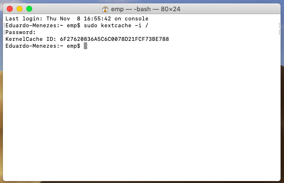

Andres ZeroCross Posted November 8, 2018 Share Posted November 8, 2018 Just now, EduardoMenezes said: Okay ... I'm reviewing the steps to see I have not forgotten anything. Excuse me. Make sure there is AppleHDA.kext at System/Library/Extensions Open terminal,,, and type "sudo kextcache -i /", enter password and press enter. After that take screenshot after end process. I am waiting Link to comment https://www.insanelymac.com/forum/topic/336114-acer-aspire-intel-hd-graphics-5500-with-mojave-solved-resolvido/page/4/#findComment-2646416 Share on other sites More sharing options...

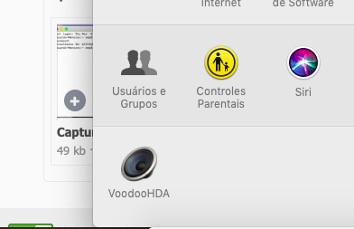

EduardoMenezes Posted November 8, 2018 Author Share Posted November 8, 2018 2 minutes ago, Andres ZeroCross said: Make sure there is AppleHDA.kext at System/Library/Extensions Open terminal,,, and type "sudo kextcache -i /", enter password and press enter. After that take screenshot after end process. I am waiting maybe VoodooHDA is disturbing Link to comment https://www.insanelymac.com/forum/topic/336114-acer-aspire-intel-hd-graphics-5500-with-mojave-solved-resolvido/page/4/#findComment-2646419 Share on other sites More sharing options...

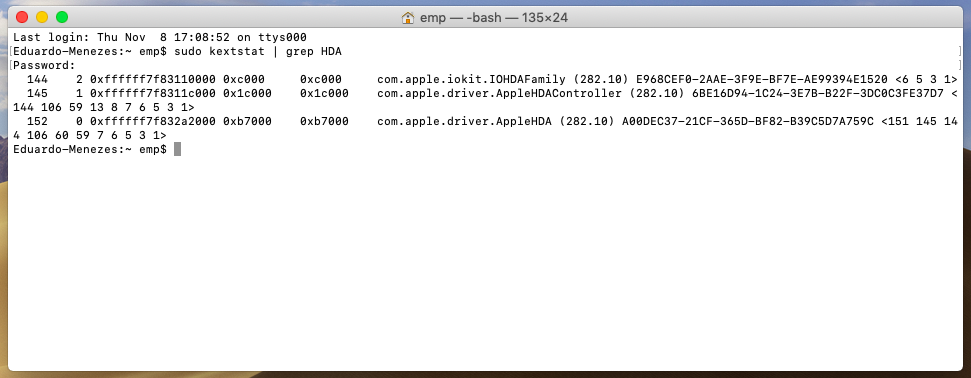

Andres ZeroCross Posted November 8, 2018 Share Posted November 8, 2018 Just now, EduardoMenezes said: maybe VoodooHDA is disturbing Preference app shouldn't make any trouble,, it's just app,, without kext it won't function. Now open terminal and type "sudo kextstat | grep HDA", and take screenshot Link to comment https://www.insanelymac.com/forum/topic/336114-acer-aspire-intel-hd-graphics-5500-with-mojave-solved-resolvido/page/4/#findComment-2646420 Share on other sites More sharing options...
EduardoMenezes Posted November 8, 2018 Author Share Posted November 8, 2018 2 minutes ago, Andres ZeroCross said: Preference app shouldn't make any trouble,, it's just app,, without kext it won't function. Now open terminal and type "sudo kextstat | grep HDA", and take screenshot Link to comment https://www.insanelymac.com/forum/topic/336114-acer-aspire-intel-hd-graphics-5500-with-mojave-solved-resolvido/page/4/#findComment-2646422 Share on other sites More sharing options...

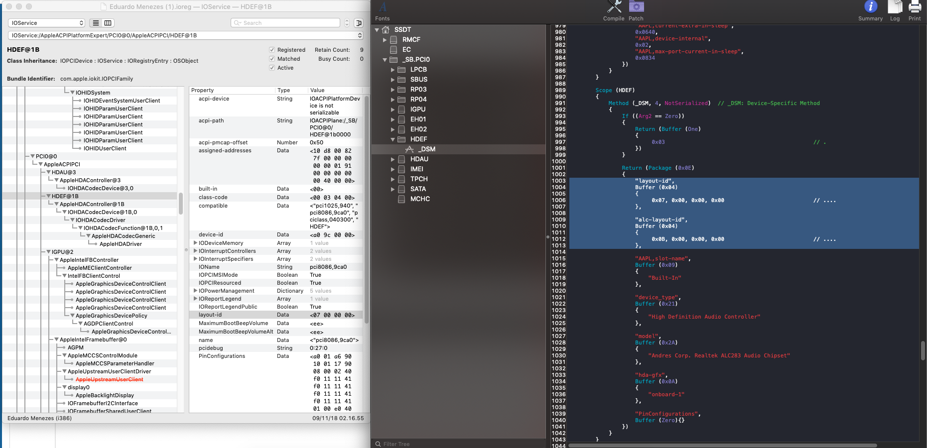

Andres ZeroCross Posted November 8, 2018 Share Posted November 8, 2018 Now send me the IOREG output again Link to comment https://www.insanelymac.com/forum/topic/336114-acer-aspire-intel-hd-graphics-5500-with-mojave-solved-resolvido/page/4/#findComment-2646423 Share on other sites More sharing options...
EduardoMenezes Posted November 8, 2018 Author Share Posted November 8, 2018 1 minute ago, Andres ZeroCross said: Now send me the IOREG output again Eduardo Menezes.ioreg Link to comment https://www.insanelymac.com/forum/topic/336114-acer-aspire-intel-hd-graphics-5500-with-mojave-solved-resolvido/page/4/#findComment-2646424 Share on other sites More sharing options...
Andres ZeroCross Posted November 8, 2018 Share Posted November 8, 2018 2 minutes ago, EduardoMenezes said: Eduardo Menezes.ioreg Did you really use my latest CLOVER folder??? Make sure of it. My patch is not shown at IOREG,, it's look you use previous CLOVER Folder. Be carefull I inject "alc-layout-id" at at SSDT-0.aml, but it's not shown at IROEG. You must double check of it. Use my latest CLOVER Folder. Link to comment https://www.insanelymac.com/forum/topic/336114-acer-aspire-intel-hd-graphics-5500-with-mojave-solved-resolvido/page/4/#findComment-2646425 Share on other sites More sharing options...
EduardoMenezes Posted November 8, 2018 Author Share Posted November 8, 2018 1 minute ago, Andres ZeroCross said: Did you really use my latest CLOVER folder??? Make sure of it. My patch is not shown at IOREG,, it's look you use previous CLOVER Folder. Be carefull I can download again and put in the EFI folder and reiciar the notebook ... can you wait? Link to comment https://www.insanelymac.com/forum/topic/336114-acer-aspire-intel-hd-graphics-5500-with-mojave-solved-resolvido/page/4/#findComment-2646427 Share on other sites More sharing options...
Andres ZeroCross Posted November 8, 2018 Share Posted November 8, 2018 Just now, EduardoMenezes said: I can download again and put in the EFI folder and reiciar the notebook ... can you wait? I am waiting,,, but i am sleepy right now. It's 2.24 AM at my country. So make it fast,, after reboot upload IOREG Output again. Be carefull, don't careless or it will be hard to find the solution Link to comment https://www.insanelymac.com/forum/topic/336114-acer-aspire-intel-hd-graphics-5500-with-mojave-solved-resolvido/page/4/#findComment-2646429 Share on other sites More sharing options...
EduardoMenezes Posted November 8, 2018 Author Share Posted November 8, 2018 6 minutes ago, Andres ZeroCross said: I am waiting,,, but i am sleepy right now. It's 2.24 AM at my country. So make it fast,, after reboot upload IOREG Output again. Be carefull, don't careless or it will be hard to find the solution Funcionou.... Works.. Alleluia Link to comment https://www.insanelymac.com/forum/topic/336114-acer-aspire-intel-hd-graphics-5500-with-mojave-solved-resolvido/page/4/#findComment-2646435 Share on other sites More sharing options...
