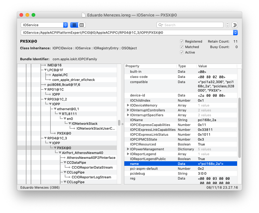

Andres ZeroCross Posted November 8, 2018 Share Posted November 8, 2018 Just now, EduardoMenezes said: Now, open IOREGistry Explorer app versi 2.1,,, save the output and upload here Link to comment Share on other sites More sharing options...
EduardoMenezes Posted November 8, 2018 Author Share Posted November 8, 2018 1 minute ago, Andres ZeroCross said: Now, open IOREGistry Explorer app versi 2.1,,, save the output and upload here just a moment, I will do it 2 minutes ago, EduardoMenezes said: just a moment, I will do it I can't find this app Link to comment Share on other sites More sharing options...
EduardoMenezes Posted November 8, 2018 Author Share Posted November 8, 2018 5 minutes ago, EduardoMenezes said: just a moment, I will do it I can't find this app I'm downloading app Link to comment Share on other sites More sharing options...
Andres ZeroCross Posted November 8, 2018 Share Posted November 8, 2018 Remember to use "IORegistryExplorer 2.1" not the new ones. Link to comment Share on other sites More sharing options...
EduardoMenezes Posted November 8, 2018 Author Share Posted November 8, 2018 3 minutes ago, Andres ZeroCross said: Remember to use "IORegistryExplorer 2.1" not the new ones. I download 3.0.2 version... I'll looking for this 2.1 4 minutes ago, EduardoMenezes said: I download 3.0.2 version... I'll looking for this 2.1 Eduardo Menezes.ioreg Link to comment Share on other sites More sharing options...
Andres ZeroCross Posted November 8, 2018 Share Posted November 8, 2018 Not related but i want to ask, how can you activate this AR9285???? I don't set any fakeID of AR9285 at my clover folder. And to activate this card you need to put Atheros40.kext at IONetworkingFamiliy.kext. Tell me,, just need to make right configurations Link to comment Share on other sites More sharing options...
EduardoMenezes Posted November 8, 2018 Author Share Posted November 8, 2018 2 minutes ago, Andres ZeroCross said: Not related but i want to ask, how can you activate this AR9285???? I don't set any fakeID of AR9285 at my clover folder. And to activate this card you need to put Atheros40.kext at IONetworkingFamiliy.kext. Tell me,, just need to make right configurations is because this is my wifi network card. I'm on a wireless network. Link to comment Share on other sites More sharing options...
Andres ZeroCross Posted November 8, 2018 Share Posted November 8, 2018 1 minute ago, EduardoMenezes said: is because this is my wifi network card. I'm on a wireless network. It's not my question,, my questions is AR9285 need patch to make it work at hackintosh. What did you do??? Did you use any kext??? I need to know. Becaus your latest LOG of Kextcache don't show any modified kext??? Tell me Link to comment Share on other sites More sharing options...
EduardoMenezes Posted November 8, 2018 Author Share Posted November 8, 2018 Just now, Andres ZeroCross said: It's not my question,, my questions is AR9285 need patch to make it work at hackintosh. What did you do??? Did you use any kext??? I need to know. Becaus your latest LOG of Kextcache don't show any modified kext??? Tell me I used an app for this. Manually I could not do it. 1 minute ago, EduardoMenezes said: I used an app for this. Manually I could not do it. If you want, I can attach it here. Link to comment Share on other sites More sharing options...
Andres ZeroCross Posted November 8, 2018 Share Posted November 8, 2018 (edited) 2 minutes ago, EduardoMenezes said: I used an app for this. Manually I could not do it. 1. What app did you use???? 2. Where are you put the kexts??? 3. Why can't i see the modified kext, wifi configuration or acpi patch to your Wifi???? 4. Did you use another kext and mix it with my lates clover folder?? Please answer Edited November 8, 2018 by Andres ZeroCross Link to comment Share on other sites More sharing options...
Andres ZeroCross Posted November 8, 2018 Share Posted November 8, 2018 (edited) 3 minutes ago, Hervé said: 168c,2a is AR9283 Atheros chipset. Works OOB. If the card fitted to this Hack is based on AR9285 chipset, then a simple DSDT patch to declare it compatible with a natively supported model will do. See here for details: https://osxlatitude.com/forums/topic/2120-inventory-of-supported-and-unsupported-wireless-cards/ Yes,, but i think he used AR9285 (168c,2b) So i just need to make sure,, it's really 168c,2b with patch, or original 168c,2a. Because i will make full configuration. And at mojave Atheros40.kext is no more at IONetworkingFamily.kext. SO i need detail, for next step configurations. I am just curios,, he use my latest clover without 168c,2b's patch but can activate the 168c,2a. How,,, ???? Edited November 8, 2018 by Andres ZeroCross Link to comment Share on other sites More sharing options...

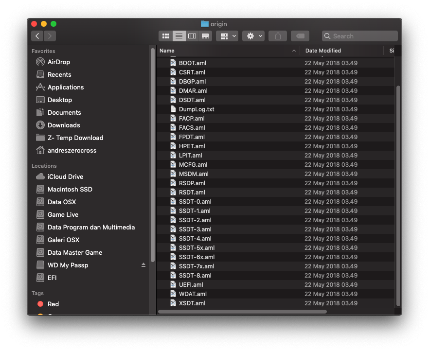

Andres ZeroCross Posted November 8, 2018 Share Posted November 8, 2018 (edited) If problem still persist, then i need newest OEM ACPI Table dumping. Because your oem table at ORIGIN is outdate. But i still use it,, i assume there is no many change at bios configurations and you don't update your BIOS yet. Edited November 8, 2018 by Andres ZeroCross Link to comment Share on other sites More sharing options...
