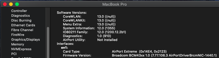

maxb2000 Posted November 13, 2020 Share Posted November 13, 2020 (edited) Thanks, understood. I tried different methods with or without kexts but it's hopeless. I tried with Properties injection different IDs with and without AirportBcrmFix I tried without both of them but kernel panic at boot with some 32 Khz oscillator not running. I have attached a full debug report including OpenCore, Lilu and Airport debug version used. If you have other suggested device id, please tell me. The Device Path was found out first using AirportBcrmFixup: PciRoot(0x0)/Pci(0x1C,0x3)/Pci(0x0,0x0) then used these device properties: Device = PciRoot(0x0)/Pci(0x1c,0x02)/Pci(0x0,0x0) Key = compatible | Value = pci14e4,4353 | Type = STRING Key = pci-aspm-default | Value = 0 | Type = NUMBER Key = AAPL,slot-name | Value = WLAN | Type = STRING (optional) Key = device_type | Value = Airport Extreme | Type = STRING (optional) Key = name | Value = Airport | Type = STRING (optional) Key = model | Value = Dell DW1820 (BCM4350) 802.11ac wireless | Type = STRING (optional) EliteBook840G2_DEBUG_WIFI.zip Edited November 13, 2020 by maxb2000 Link to comment Share on other sites More sharing options...
