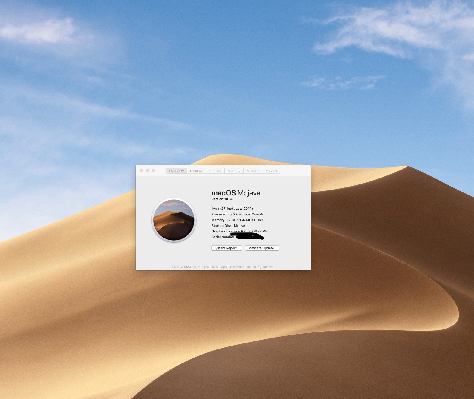

bigben1 Posted October 2, 2018 Share Posted October 2, 2018 (edited) I had success in installing os Mojave,!!!System Version: macOS 10.14 (18A391)specs; Gaz77xud3hcore i5 ( ivy bridge)RX 580 8gb Gpu12 gb ram Intel ssdmy usb installer could not boot in Hdmi mode, so I used DP for installation and then booted with Hdmi.another quirky stuff was that my usb installer could not see Mojave SSD after successful install, so I booted to HSierra ssd and installed Clover BL, and kexts without any problem.to get sound I used VoodooHDA latest version. 2.8.9....so far too good.pic below Edited October 2, 2018 by bigben1 Link to comment Share on other sites More sharing options...
rendercat Posted October 2, 2018 Share Posted October 2, 2018 Congraculations bigben1 !! The RX 580, is a pulse version, or nitro ? Link to comment Share on other sites More sharing options...
sandokan71 Posted October 5, 2018 Share Posted October 5, 2018 (edited) Very nice! RX 580 8gb Gpu.. Is this working OOB or you need some patch to have full acceleration and metal 2 support? Anyone else know if Sapphire RX 570 4GB will work fine on Mojave? Edited October 5, 2018 by sandokan71 Link to comment Share on other sites More sharing options...
bigben1 Posted October 6, 2018 Author Share Posted October 6, 2018 rx580 8gb works oobb, no patching. rx580 pulse version.thank you Link to comment Share on other sites More sharing options...
