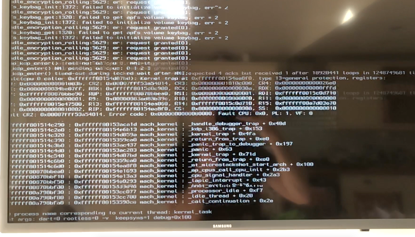

mickeyd453 Posted September 29, 2018 Share Posted September 29, 2018 I have this old board running a media server that has run 10.13 and everything previously without issue. I installed the latest clover and did an in place upgrade and everything seemed to go fine. On first reboot after install it panicked and rebooted and i could not see the error. I selected dont reboot after panic in clover and managed to get the following screen shot out of a video as the error scrolls past too quickly. I installed a clean 10.13 onto a different disk and this was succesful and so with the same clover and kexts i installed a clean 10.14 and exactly the same error occured. I have 2 other machines on 10.14 without issue so can anyone help out understanding the cause of this panic? The install of 10.14 runs fine its just on first boot after install that the machine panics and reboots. thanks for any help! 1 Link to comment https://www.insanelymac.com/forum/topic/335715-p5kpl-am-quad-xeon-panic-on-first-boot-after-install/ Share on other sites More sharing options...
crazybirdy Posted September 29, 2018 Share Posted September 29, 2018 Mojave need SSE4.2, LGA775 CPU support only SSE4.1, not support SSE4.2. Need to patch com.apple.telemetry.plugin via Q5-mojave2core/mojave2core 1 Link to comment https://www.insanelymac.com/forum/topic/335715-p5kpl-am-quad-xeon-panic-on-first-boot-after-install/#findComment-2637700 Share on other sites More sharing options...

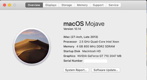

mickeyd453 Posted November 22, 2018 Author Share Posted November 22, 2018 The GT 710 is a 'cheap' card that works well in 10.14 Link to comment https://www.insanelymac.com/forum/topic/335715-p5kpl-am-quad-xeon-panic-on-first-boot-after-install/#findComment-2649120 Share on other sites More sharing options...
