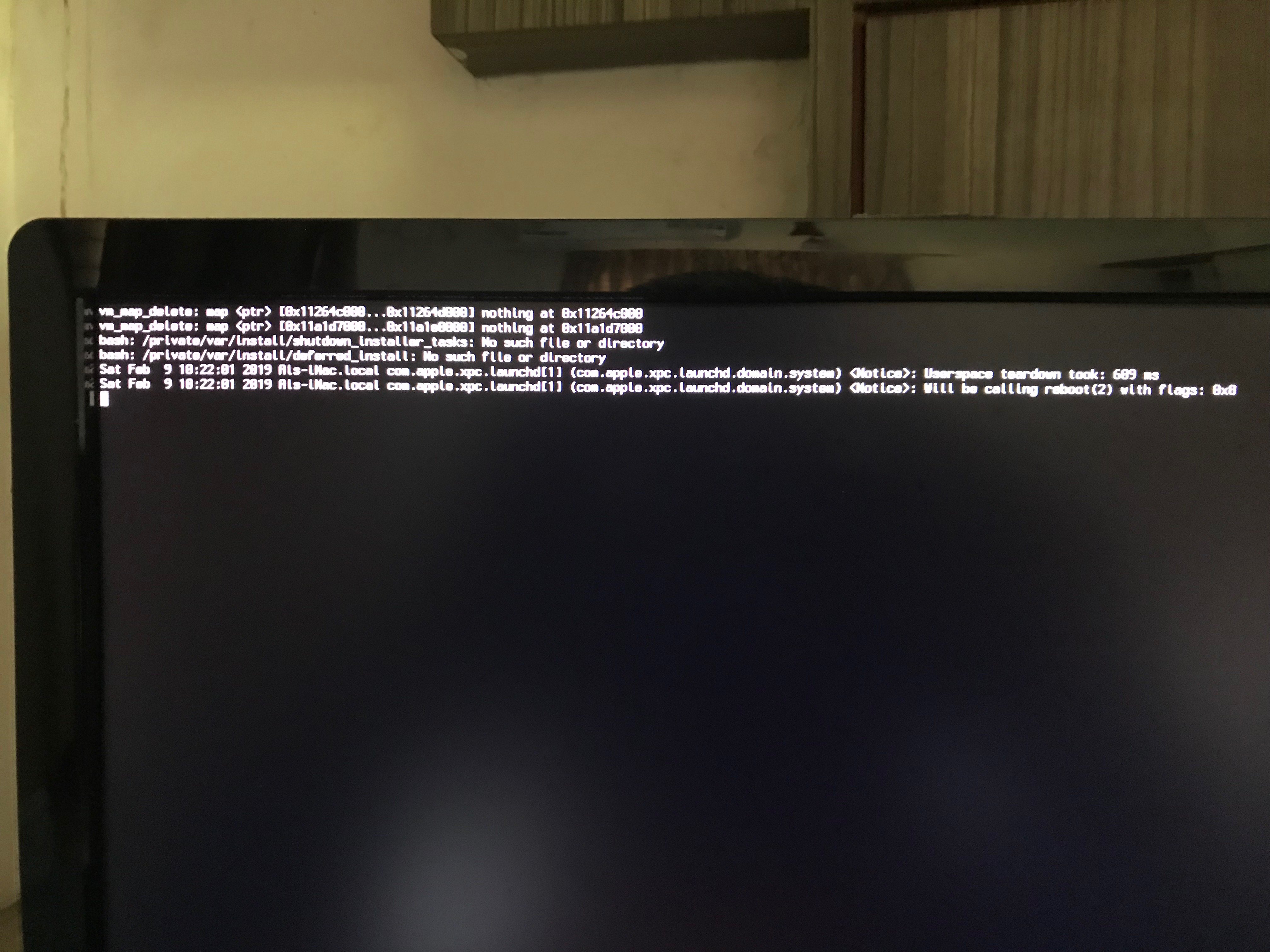

Apple Hunter Posted February 9, 2019 Share Posted February 9, 2019 Here i have same issues click shutdown gets restart SYSTEM: Mojave 10.4.3 i3 8100 H310M S2H 8+8GB ram Gigabyte RX 560 500GB SSD EFI.zip Link to comment Share on other sites More sharing options...

ndungu6678 Posted February 22, 2019 Share Posted February 22, 2019 He guys -i had the same problem for ages with a similar board- Gigayte Z77-DS3H and Xeon Sandy core i7 2700K 3.5MHZ processor. I solved the problem by removing just one kext-the ALXEthernet or something from clover folder and system extension folder. Apparently it causes a panic during shutdown and you get a reboot instead. If it still persist remove all generic ethernet kexts (eg AtherosE2200Ethernet.kext etc.) and see if shutdown works! if it does then you will have to find alternative kexts that work without a reboot. This worked for me but do not guarantee it will for you. Good luck Link to comment Share on other sites More sharing options...
