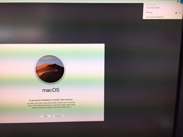

fusion71au Posted September 5, 2018 Share Posted September 5, 2018 (edited) @SpiderCab To get Atheros wifi working for your installer, you need to replace its prelinked kernel with one that includes IO80211Family.kext from High Sierra eg attached to this post is prelinked kernel from Mojave10.14_18A391 that has this kext inside. To generate your own prelinked kernel, see post#1 in this thread. Follow instructions for "Custom Prelinkedkernel Generator Tool", running the PLK.tool in Mojave (after adding Mojave BaseSystem.dmg and IO80211Family.kext to "ExtraKexts" folder). @XLNC's post in that same thread is useful if you make an installer with createinstallmedia. Mojave prelinkedkernel with Atheros Wifi.zip 8 hours ago, oldman20 said: hi, i used your attach file, but still cant get wifi work with ínstaller Mojave. Please explain, bro? I assume your Atheros wifi card worked properly before in 10.13.6? What method did you use to make the Mojave installer and where did you copy the prelinkedkenel to? The wifi icon in the installer may be "invisible" at first before you click the title bar of the Mojave installer on the top RHS (Right Hand Side)... Edited October 17, 2018 by fusion71au Updated prelinkedkernel from 10.14_18A391 and answer @oldman's question 2 Link to comment https://www.insanelymac.com/forum/topic/335405-mojave-and-airportatheros40kext/#findComment-2633365 Share on other sites More sharing options...
oldman20 Posted October 16, 2018 Share Posted October 16, 2018 (edited) On 9/5/2018 at 3:42 AM, fusion71au said: @SpiderCab To get Atheros wifi working for your installer, you need to replace its prelinked kernel with one that includes IO80211Family.kext from High Sierra eg attached to this post is prelinked kernel from Developer Beta 10 that has this kext inside. To generate your own prelinked kernel, see post#1 in this thread. Follow instructions for "Custom Prelinkedkernel Generator Tool", running the PLK.tool in Mojave (after adding Mojave BaseSystem.dmg and IO80211Family.kext to "ExtraKexts" folder). @XLNC's post in that same thread is useful if you make an installer with createinstallmedia. Mojave prelinkedkernel with Atheros Wifi.zip hi, i used your attach file, but still cant get wifi work with ínstaller Mojave. Please explain, bro? Edited October 16, 2018 by oldman20 Link to comment https://www.insanelymac.com/forum/topic/335405-mojave-and-airportatheros40kext/#findComment-2641222 Share on other sites More sharing options...
oldman20 Posted October 17, 2018 Share Posted October 17, 2018 On 9/5/2018 at 5:42 PM, fusion71au said: I assume your Atheros wifi card worked properly before in 10.13.6? What method did you use to make the Mojave installer and where did you copy the prelinkedkenel to? thanks your attention, yep, my wifi card work well before version. I created mojave installer by createinstallmedia method. I copied the prelinkedkernel replace orginal file in S/L/PrelinkedKernels The wifi icon in the installer may be "invisible" at first before you click the titlebar on the top RHS... and how to make it visible, or how to choose wifi to connect if that true? Link to comment https://www.insanelymac.com/forum/topic/335405-mojave-and-airportatheros40kext/#findComment-2641322 Share on other sites More sharing options...
fusion71au Posted October 17, 2018 Share Posted October 17, 2018 8 minutes ago, oldman20 said: thanks your attention, yep, my wifi card work well before version. I created mojave installer by createinstallmedia method. I copied the prelinkedkernel replace orginal file in S/L/PrelinkedKernels The wifi icon in the installer may be "invisible" at first before you click the titlebar on the top RHS... and how to make it visible, or how to choose wifi to connect if that true? Click title bar of the Mojave installer window on top RHS to enable wifi and enter wifi password... Link to comment https://www.insanelymac.com/forum/topic/335405-mojave-and-airportatheros40kext/#findComment-2641325 Share on other sites More sharing options...
