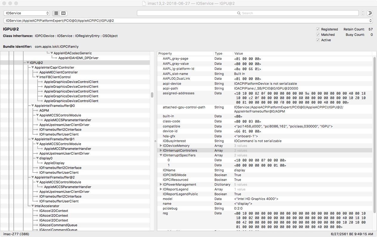

VCH888 Posted June 27, 2018 Share Posted June 27, 2018 My Intel HD4000 is working fine, also HDMI audio is working with patching kext. Spoiler Intel HD Graphics 4000: Chipset Model: Intel HD Graphics 4000 Type: GPU Bus: Built-In Slot: Built In VRAM (Dynamic, Max): 1536 MB Vendor: Intel Device ID: 0x0166 Revision ID: 0x0009 Metal: spdisplays_metalfeaturesetfamily13 Displays: SA300/SA350: Resolution: 1920 x 1080 @ 60 Hz Pixel Depth: 32-Bit Color (ARGB8888) Display Serial Number: HMAB###### Mirror: Off Online: Yes Rotation: Supported Automatically Adjust Brightness: No spdisplays_pixelresolution: 1920 x 1080 @ 60Hz (1080p) Spoiler I think we have the same devices, and you may try my dsdt.aml and ssdt-#.aml in /ACPI/patched/ folder. ssdt.aml is for my Intel CPU i3770K. For audio id, you may need to edit layout-id of HDEF to 0x01, 0x00, 0x00, 0x00 in ssdt-1.dsl and then compile it to ssdt-1.aml. Editing config.plist to match your requirement. Link to comment https://www.insanelymac.com/forum/topic/334688-z77x-up5-th-intel-hd-4000-issue/#findComment-2622549 Share on other sites More sharing options...
