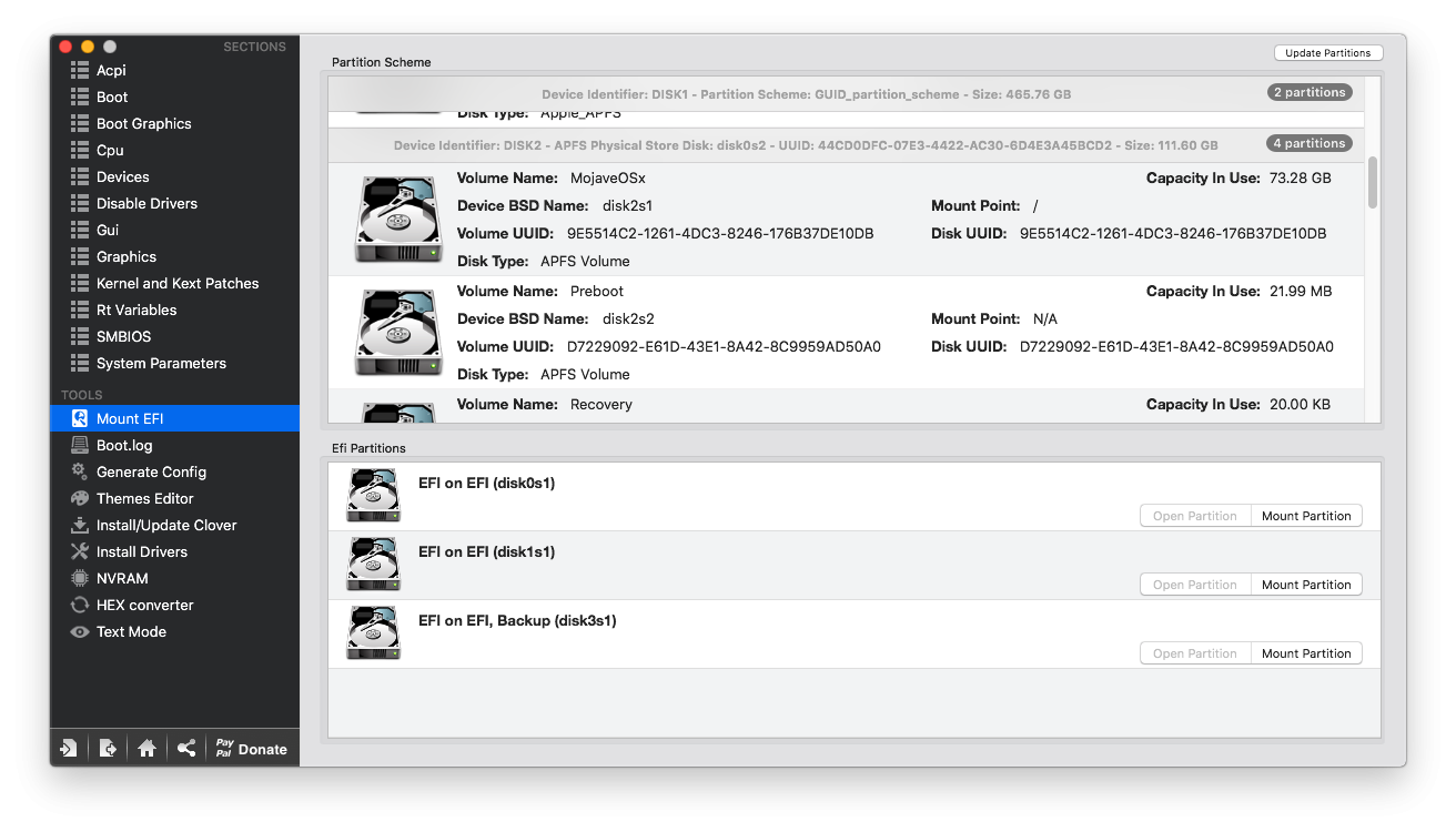

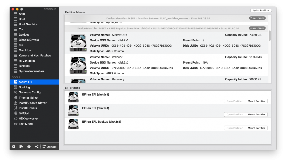

demos41 Posted June 11, 2018 Author Share Posted June 11, 2018 as you can see I cannot mount mojaveosx ssd no option, have a preeboot partition that does not show when pc is turned on, I think the would help Link to comment Share on other sites More sharing options...
Pavo Posted June 11, 2018 Share Posted June 11, 2018 16 minutes ago, demos41 said: as you can see I cannot mount mojaveosx ssd no option, have a preeboot partition that does not show when pc is turned on, I think the would help Oh...... this is probably because there were no ESP built on disk2 it looks like. More than likely its a result of installing the OS while other HDDs were connected and the ESP was created on a different drive. This is not a booting issue, this is simply a mounting issue correct? Link to comment Share on other sites More sharing options...
demos41 Posted June 11, 2018 Author Share Posted June 11, 2018 (edited) thanks, seems correct to me, don't know much but that is how I installed Mojave over high Sierra, all apps office photoshop etc all is there with the install. all disks where present even backup disk, full acceleration for hd530 too Edited June 11, 2018 by demos41 Link to comment Share on other sites More sharing options...
Pavo Posted June 11, 2018 Share Posted June 11, 2018 6 minutes ago, demos41 said: thanks, seems correct to me, don't know much but that is how I installed Mojave over high Sierra, all apps office photoshop etc all is there with the install. all disks where present even backup disk, full acceleration for hd530 too Yeah you need too just figure out what drive to use to boot from, that is where your EFI folder will go. You don't have to install Clover on every drive, just the drive you select as boot drive in bios settings. Link to comment Share on other sites More sharing options...

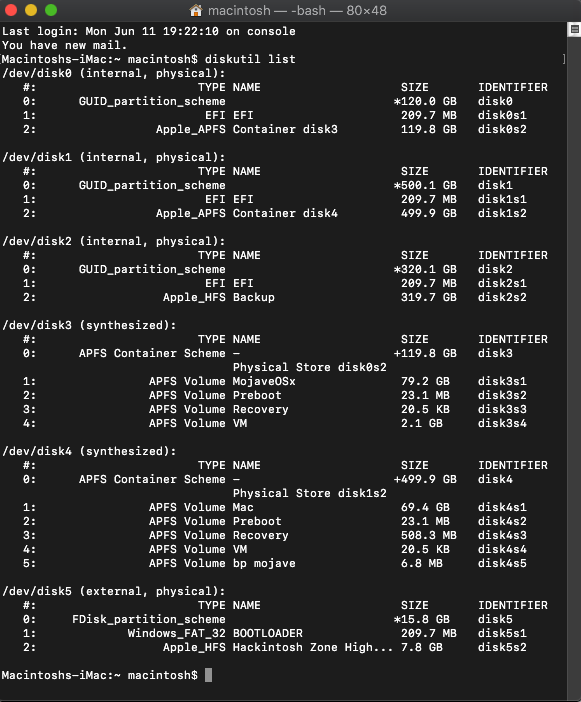

demos41 Posted June 11, 2018 Author Share Posted June 11, 2018 (edited) 4 minutes ago, Pavo said: Yeah you need too just figure out what drive to use to boot from, that is where your EFI folder will go. You don't have to install Clover on every drive, just the drive you select as boot drive in bios settings. when I press boot option and boot from the ssd nothing happens, all dark, with high Sierra had it was as boot disk when I selected the ssd it would boot, now installed latest clover to that drive ssd and nothing, did not want to take the pc apart to disconnect disks if I could make the ssd to boot would add second monitor, did it for high Sierra, lol did it all but now it seem more puzzled Edited June 11, 2018 by demos41 Link to comment Share on other sites More sharing options...
demos41 Posted June 11, 2018 Author Share Posted June 11, 2018 (edited) what can I do? disk0 and disk3 are the same one Edited June 11, 2018 by demos41 Link to comment Share on other sites More sharing options...

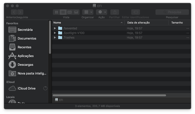

Gigamaxx Posted June 11, 2018 Share Posted June 11, 2018 3 hours ago, demos41 said: when I press boot option and boot from the ssd nothing happens, all dark, with high Sierra had it was as boot disk when I selected the ssd it would boot, now installed latest clover to that drive ssd and nothing, did not want to take the pc apart to disconnect disks if I could make the ssd to boot would add second monitor, did it for high Sierra, lol did it all but now it seem more puzzled I had the same issue with a disk with CC I was able to use EFIMoiunter to access the EFI folder. Google it and see if you can find it. I was able to boot with the disk I just could not mount using CC but it works with EFImounter. Link to comment Share on other sites More sharing options...
demos41 Posted June 11, 2018 Author Share Posted June 11, 2018 4 minutes ago, Gigamaxx said: I had the same issue with a disk with CC I was able to use EFIMoiunter to access the EFI folder. Google it and see if you can find it. I was able to boot with the disk I just could not mount using CC but it works with EFImounter. yes the efi I mounted is empty what do I do? Link to comment Share on other sites More sharing options...
Gigamaxx Posted June 11, 2018 Share Posted June 11, 2018 8 minutes ago, demos41 said: yes the efi I mounted is empty what do I do? You can drag and drop (copy) your USB EFI folder to it. Link to comment Share on other sites More sharing options...

demos41 Posted June 11, 2018 Author Share Posted June 11, 2018 2 hours ago, Gigamaxx said: I had the same issue with a disk with CC I was able to use EFIMoiunter to access the EFI folder. Google it and see if you can find it. I was able to boot with the disk I just could not mount using CC but it works with EFImounter. Thanks a lot, this idea and access made me be able to get it working. EFImounter saved the situation, now all I need is dual display and Mojave complete 1 Link to comment Share on other sites More sharing options...
