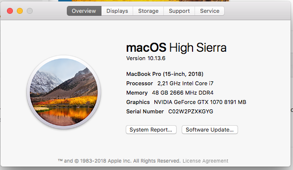

styrian Posted November 13, 2018 Share Posted November 13, 2018 Do you get the desktop at internal screen without webrivers? How is your gtx in system Profiler recognized? Link to comment https://www.insanelymac.com/forum/topic/334026-nvidia-backlight-control-on-hp-omen-ce003na/page/2/#findComment-2647406 Share on other sites More sharing options...

styrian Posted November 13, 2018 Share Posted November 13, 2018 Nice, some steps forward, GTX seems to be fully working, black screen issue passed, backliight is working. I suggest, that I try, to make a correct efistring for your card, espaccally, there si no port mapped to the internal screen iin your last ioreg (00 00 00 00). It shuld be: 02 00 00 00 with an connector config 00 03 01 03 (have to look for it) to get the AppleBacklightDisplay an the Brightness slider working (keys are a acpi thing). For this I would need some days. Meanwhile you could try to patch an all in one DSDT.aml, but with no gfx-related DSM methods. for the USBports you could follow this method: https://www.insanelymac.com/forum/topic/335018-intel-fb-patcher-v163/ No need for using USBinjet.... or SSDT anymore. If your internal screnn is brighter as the sun you can search for a release of this app: https://github.com/KAMIKAZEUA/NativeDisplayBrightness For creating an Efi-String for your NVDA GTX I would need a report of Darwin Dumper: https://bitbucket.org/blackosx/darwindumper/downloads/ How do you think about it? Link to comment https://www.insanelymac.com/forum/topic/334026-nvidia-backlight-control-on-hp-omen-ce003na/page/2/#findComment-2647434 Share on other sites More sharing options...
vanadium Posted November 13, 2018 Share Posted November 13, 2018 (edited) Black screen has never been an issue without ACPI patching. Once ACPI patched to fix brightness, then I have black screen issues. GTX is indeed fully working with Nvidia Web drivers The internal display seems to be connected via a Display Port on port #2 (Display-C). My external Display port screen is mapped to port #3 (Display-D) in IOReg. Glad you can spend some time on this, the Helios 500 is really a beast I would love to be able to run on macOS. And i'm sure other people who already enjoy this powerful laptop will love it even more. I'm going to follow the links you provided and keep you informed about any progress I may have made on my side. EDIT: Darwin Dump report removed. if you need it, PM me. Edited November 13, 2018 by vanadium Link to comment https://www.insanelymac.com/forum/topic/334026-nvidia-backlight-control-on-hp-omen-ce003na/page/2/#findComment-2647442 Share on other sites More sharing options...

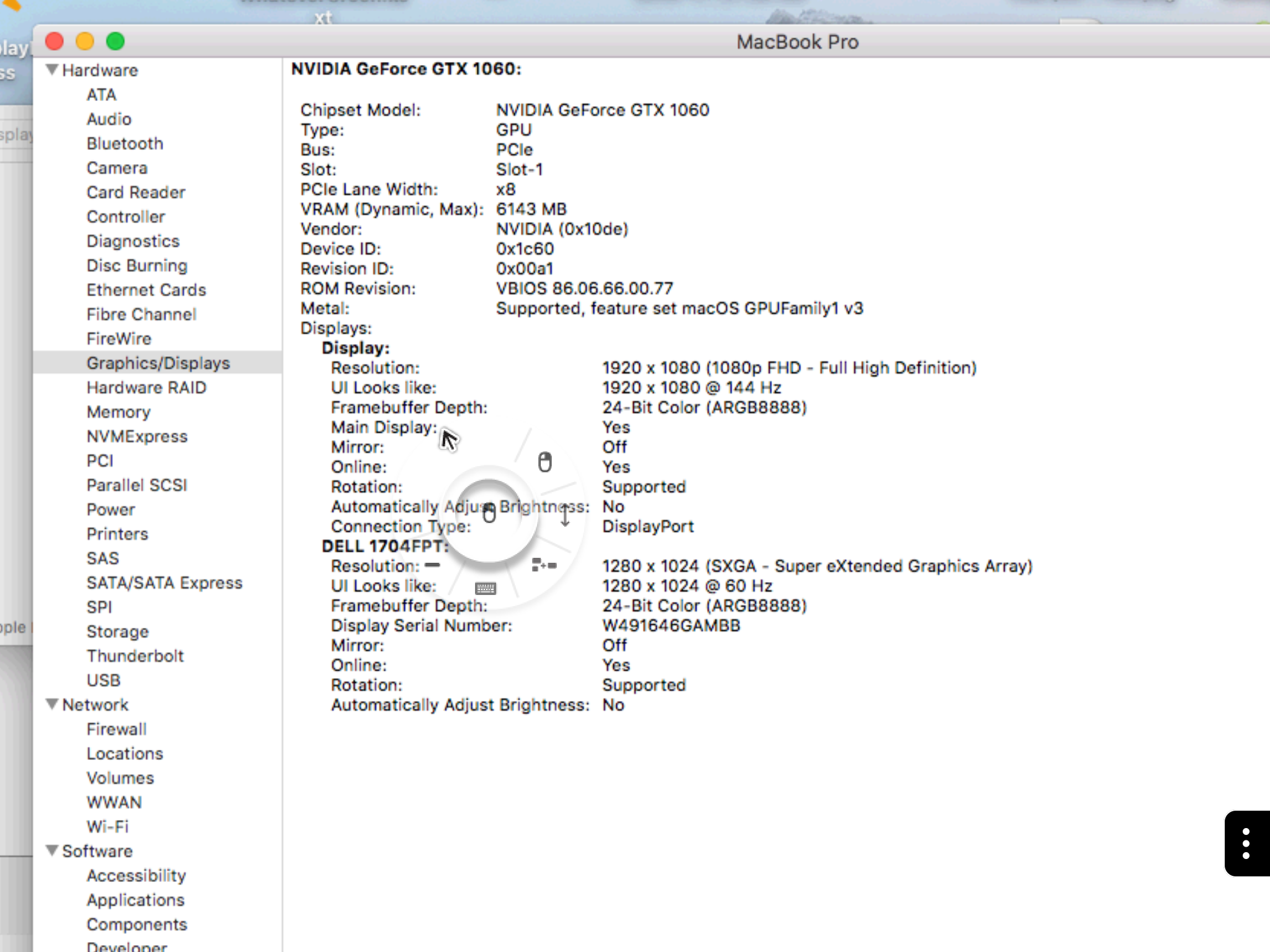

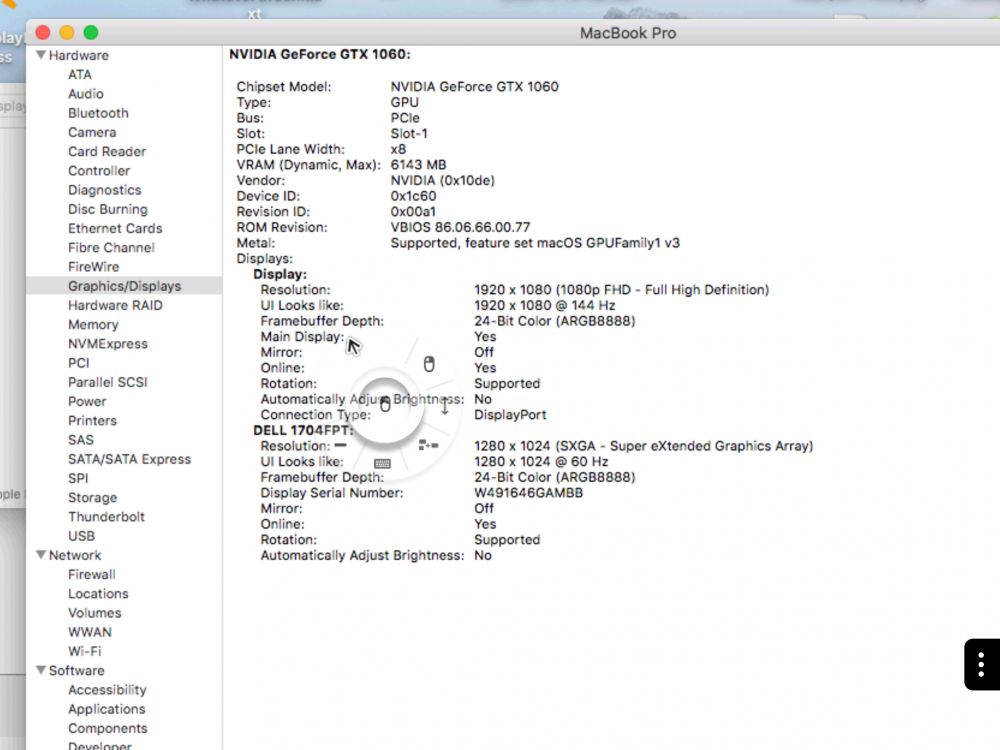

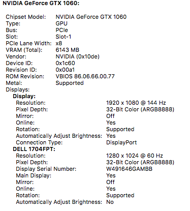

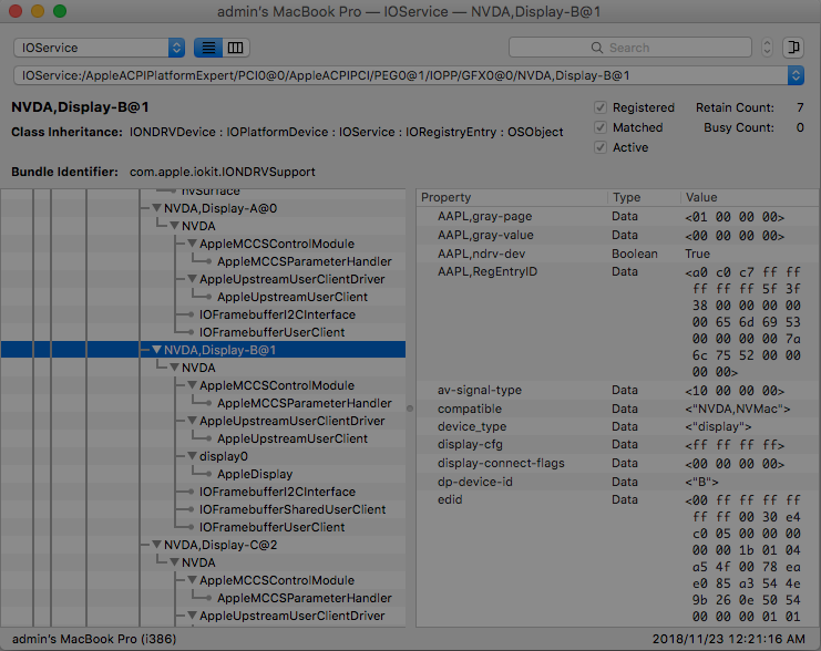

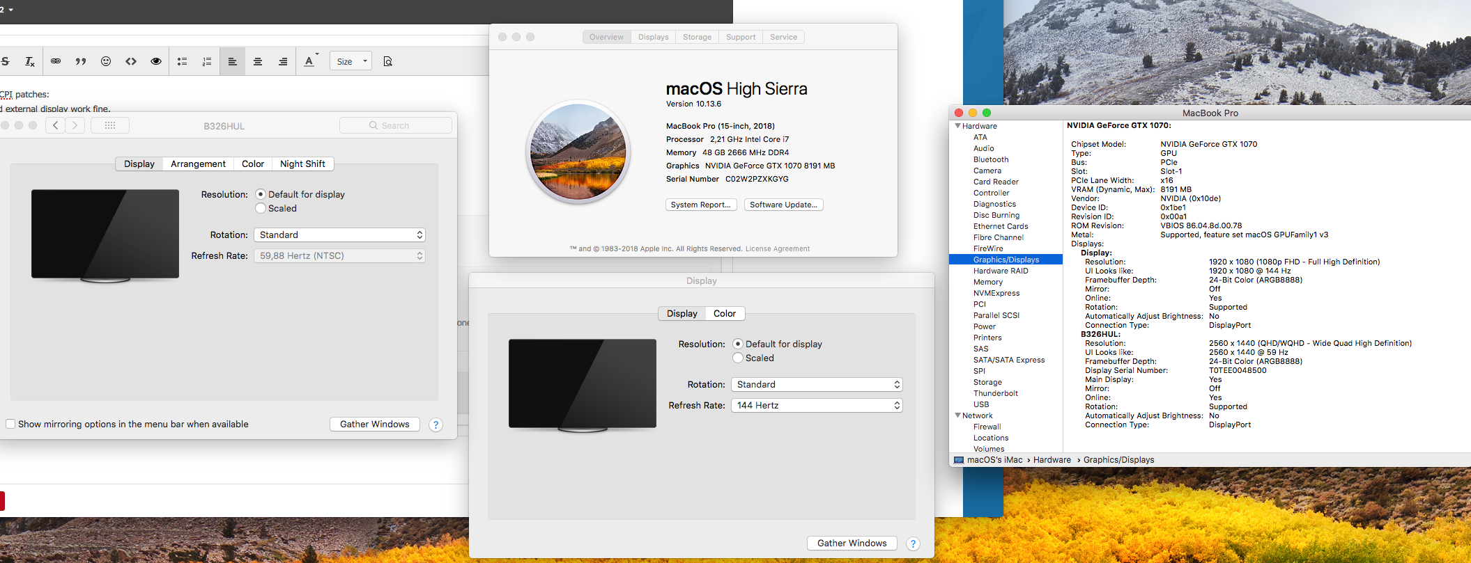

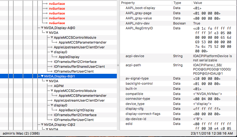

mail_hxm Posted November 22, 2018 Share Posted November 22, 2018 (edited) Hello all, I have an HP OMEN 15-dc0124tx,GTX1060, It's running macOS High Sierra and Sierra 10.12.6 dual OS on same hard disk. CLOVER boot loader with patch ACPI ("@1,built-in") 10.12.6: brightness controls effect, the screen flicker random, the external display is the main display! 10.13.6: internal display stuck on Apple logo, mouse can be moved on it, the main display is laptop! CLOVER boot loader without patch ACPI 10.12.6: web driver working, Brightness controls no effect, no flicker 10.13.6: web driver working, Brightness controls no effect, no flicker Edited November 23, 2018 by mail_hxm Link to comment https://www.insanelymac.com/forum/topic/334026-nvidia-backlight-control-on-hp-omen-ce003na/page/2/#findComment-2649141 Share on other sites More sharing options...
