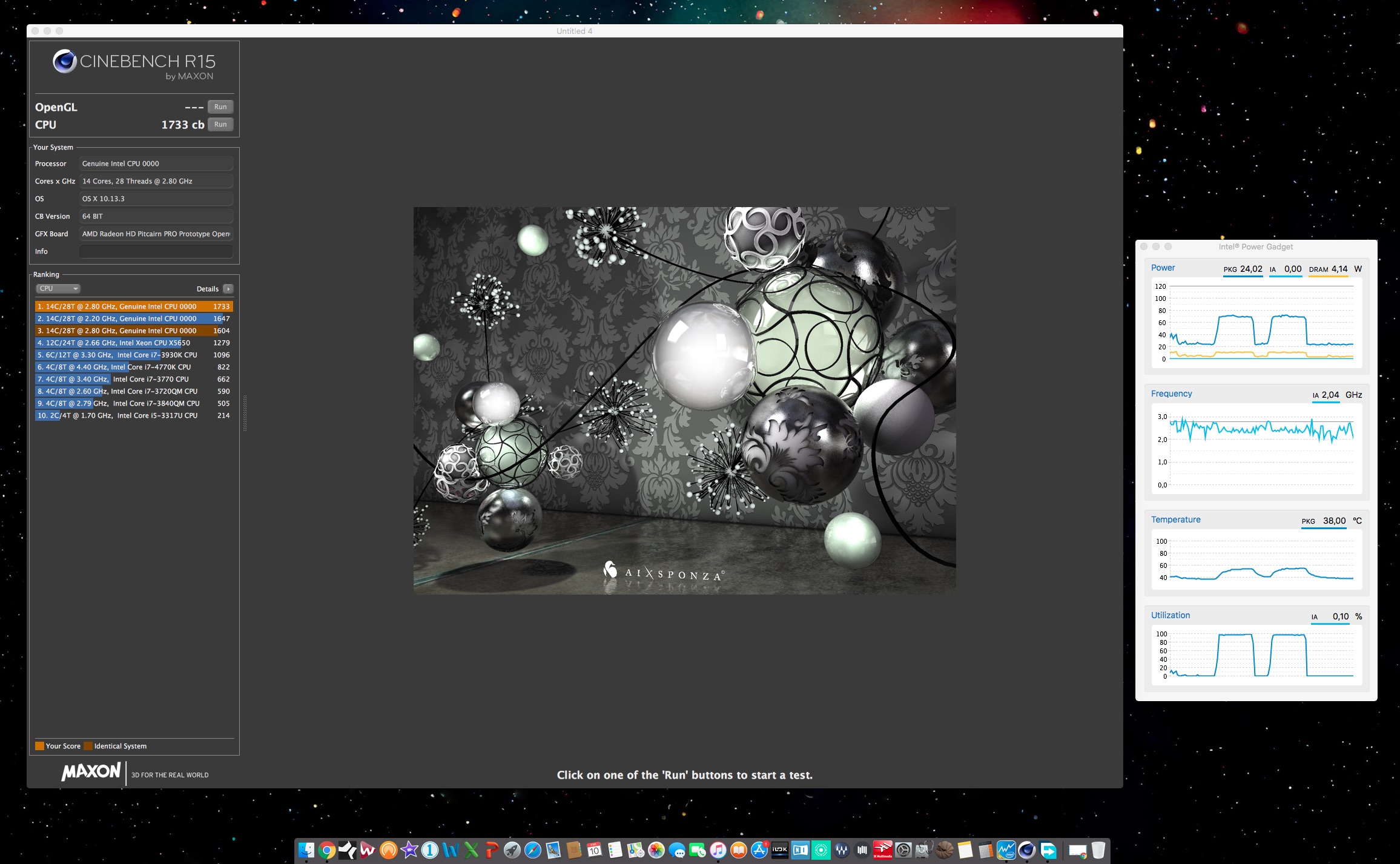

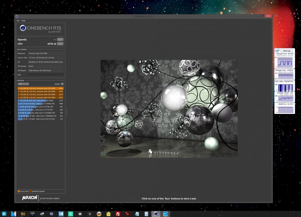

dEaK Posted April 10, 2018 Share Posted April 10, 2018 So, my CPU in OSX86 is 20% slower than in Windows in Cinebench. I've tried different BIOSes... My CPU is Intel Xeon E5-2680v4. Please help... Link to comment https://www.insanelymac.com/forum/topic/333764-my-osx86-is-20-slower-than-windows-in-cinebench/ Share on other sites More sharing options...

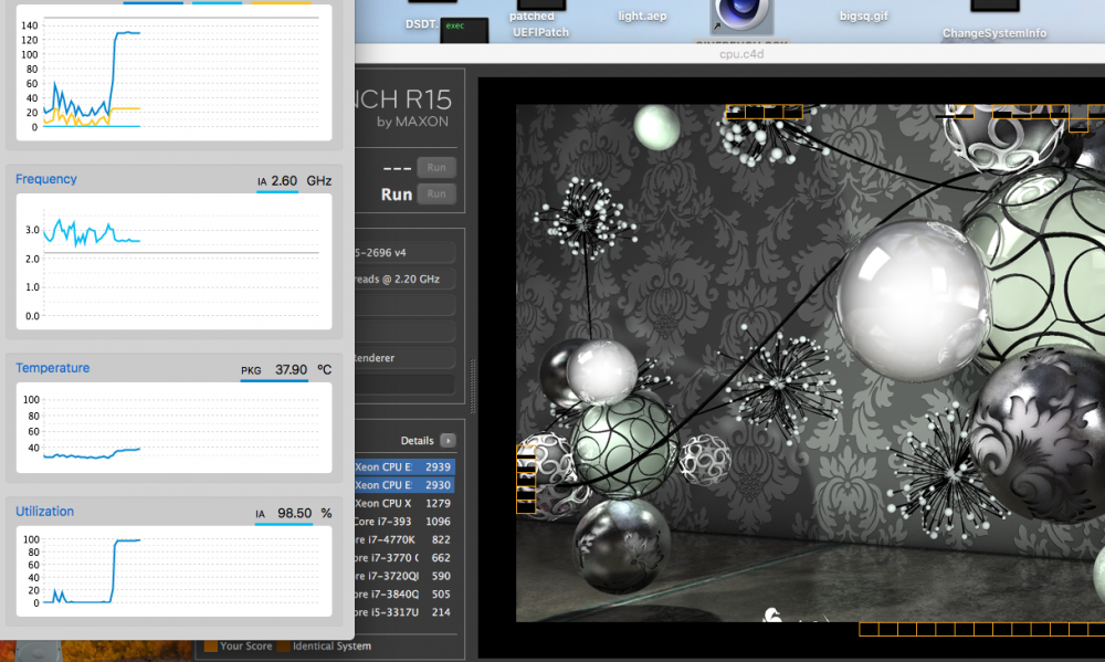

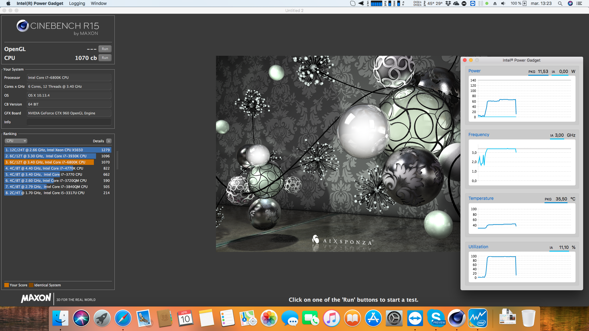

Guest Posted April 10, 2018 Share Posted April 10, 2018 try to install on both system intel power gadget and see if in multicore conditon you reach turboost on your cpu for all cores In my case Cinebench on Windows reaches 2.8 Ghz in bechmarking instead OSX cinebench r15 reaches 2.6Ghz so i have 3.250/2940 (about 10% worst on osx) Link to comment https://www.insanelymac.com/forum/topic/333764-my-osx86-is-20-slower-than-windows-in-cinebench/#findComment-2608858 Share on other sites More sharing options...
dEaK Posted April 10, 2018 Author Share Posted April 10, 2018 What a huge difference in performance. I'm getting 2100/1700 (20% worst in OSX) Link to comment https://www.insanelymac.com/forum/topic/333764-my-osx86-is-20-slower-than-windows-in-cinebench/#findComment-2608860 Share on other sites More sharing options...
Guest Posted April 10, 2018 Share Posted April 10, 2018 check cpu frequency during test..maybe you have to tweak a little your config.plist Link to comment https://www.insanelymac.com/forum/topic/333764-my-osx86-is-20-slower-than-windows-in-cinebench/#findComment-2608861 Share on other sites More sharing options...

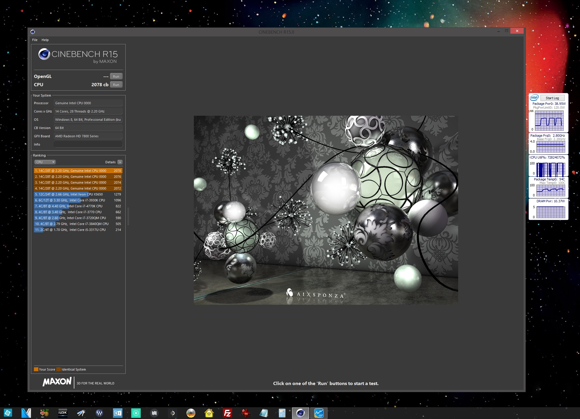

Guest Posted April 10, 2018 Share Posted April 10, 2018 (edited) in my case this is Windows (see packaging freq and flat line for it during benchmark) Edited April 10, 2018 by Guest osx bench added Link to comment https://www.insanelymac.com/forum/topic/333764-my-osx86-is-20-slower-than-windows-in-cinebench/#findComment-2608863 Share on other sites More sharing options...

MICKHAEL Posted April 10, 2018 Share Posted April 10, 2018 os x don't reach turbo 3.5 but performance is still better) interesting and lower temperature also Link to comment https://www.insanelymac.com/forum/topic/333764-my-osx86-is-20-slower-than-windows-in-cinebench/#findComment-2608872 Share on other sites More sharing options...
Guest Posted April 10, 2018 Share Posted April 10, 2018 @MICKHAEL maybe is CPU throttling in windows? Link to comment https://www.insanelymac.com/forum/topic/333764-my-osx86-is-20-slower-than-windows-in-cinebench/#findComment-2608874 Share on other sites More sharing options...
MICKHAEL Posted April 10, 2018 Share Posted April 10, 2018 1 hour ago, fabiosun said: @MICKHAEL maybe is CPU throttling in windows? i don't know... just tested Corona Standalone render in OS X and frequency jumped to 3.5... strange that Cinebench don't reach Link to comment https://www.insanelymac.com/forum/topic/333764-my-osx86-is-20-slower-than-windows-in-cinebench/#findComment-2608893 Share on other sites More sharing options...
Guest Posted April 10, 2018 Share Posted April 10, 2018 Yep cinebench does not push all cores in OS X at its Full speed Link to comment https://www.insanelymac.com/forum/topic/333764-my-osx86-is-20-slower-than-windows-in-cinebench/#findComment-2608895 Share on other sites More sharing options...
dEaK Posted April 10, 2018 Author Share Posted April 10, 2018 Is there any way to enable turbo on all cores in OSX? Link to comment https://www.insanelymac.com/forum/topic/333764-my-osx86-is-20-slower-than-windows-in-cinebench/#findComment-2608896 Share on other sites More sharing options...
Guest Posted April 10, 2018 Share Posted April 10, 2018 (edited) post IPG graphic or see by yourself if benchmarrck line is flat at your all cores frequency if not you may have need to use performance fix (kernel patch) Post your efi and your OSX detail version Edited April 10, 2018 by Guest Link to comment https://www.insanelymac.com/forum/topic/333764-my-osx86-is-20-slower-than-windows-in-cinebench/#findComment-2608915 Share on other sites More sharing options...
dEaK Posted April 10, 2018 Author Share Posted April 10, 2018 Link to comment https://www.insanelymac.com/forum/topic/333764-my-osx86-is-20-slower-than-windows-in-cinebench/#findComment-2608946 Share on other sites More sharing options...

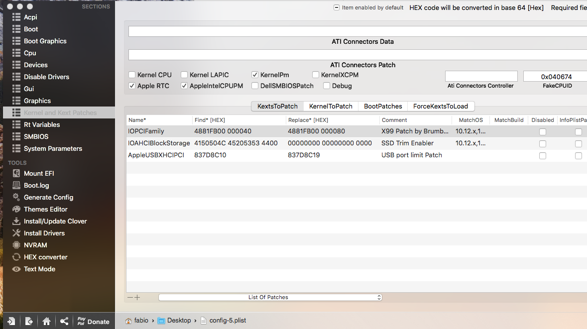

Guest Posted April 10, 2018 Share Posted April 10, 2018 if you are in 10.13.3 try this you have a weird config.plist..if it is working to boost your rig I would like to try to refine better Put also your motherboard if you want config-5.plist Link to comment https://www.insanelymac.com/forum/topic/333764-my-osx86-is-20-slower-than-windows-in-cinebench/#findComment-2608954 Share on other sites More sharing options...

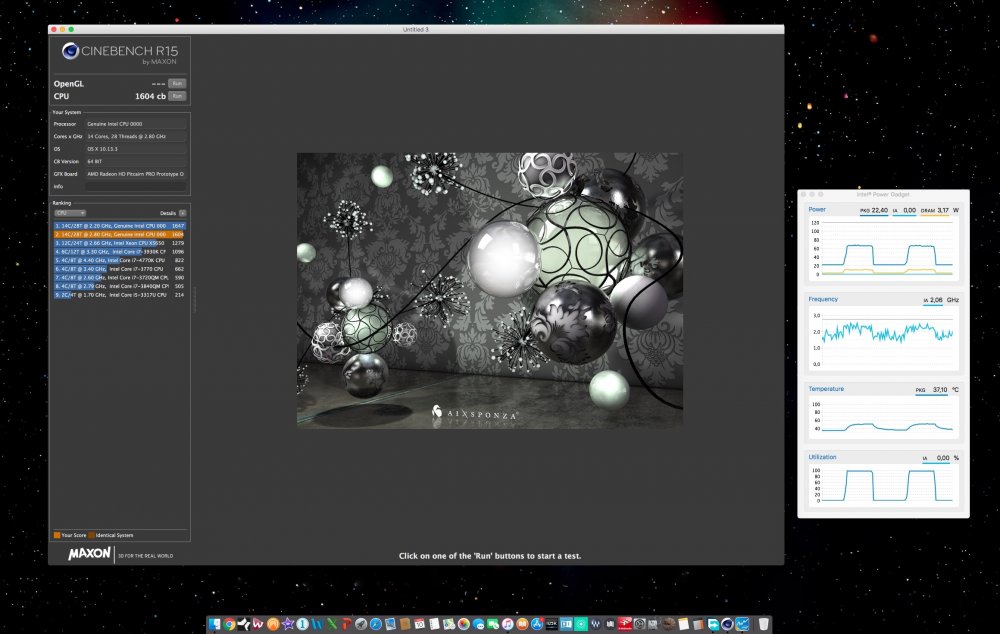

dEaK Posted April 10, 2018 Author Share Posted April 10, 2018 Test with your config.plist. There's a progression! Link to comment https://www.insanelymac.com/forum/topic/333764-my-osx86-is-20-slower-than-windows-in-cinebench/#findComment-2608960 Share on other sites More sharing options...
Guest Posted April 10, 2018 Share Posted April 10, 2018 too low about 5% better then previous maybe you have to tweak also some bios parameters if you want try also I will try another config with less patches..in my case with a V4 CPU I am using only to patches for kernel you should not have the need to flag that kernel things Link to comment https://www.insanelymac.com/forum/topic/333764-my-osx86-is-20-slower-than-windows-in-cinebench/#findComment-2608962 Share on other sites More sharing options...

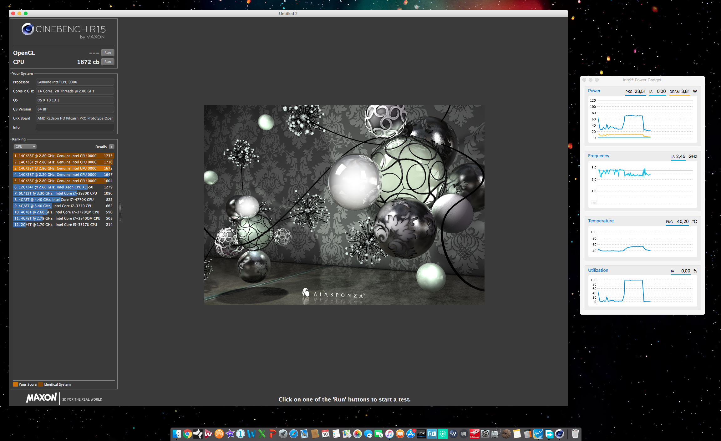

Guest Posted April 10, 2018 Share Posted April 10, 2018 if you want try this config and see 1) if your system boots with it 2) performance here I have used same your 15.1 smbios but you have to use other in my opinion config.plist Link to comment https://www.insanelymac.com/forum/topic/333764-my-osx86-is-20-slower-than-windows-in-cinebench/#findComment-2608966 Share on other sites More sharing options...
dEaK Posted April 10, 2018 Author Share Posted April 10, 2018 Now it's a bit slower. What's interesting, when I'm starting a test CPU clocks lower ie. 2,4 Ghz, earlier it's 2,8 Ghz. Link to comment https://www.insanelymac.com/forum/topic/333764-my-osx86-is-20-slower-than-windows-in-cinebench/#findComment-2608968 Share on other sites More sharing options...
