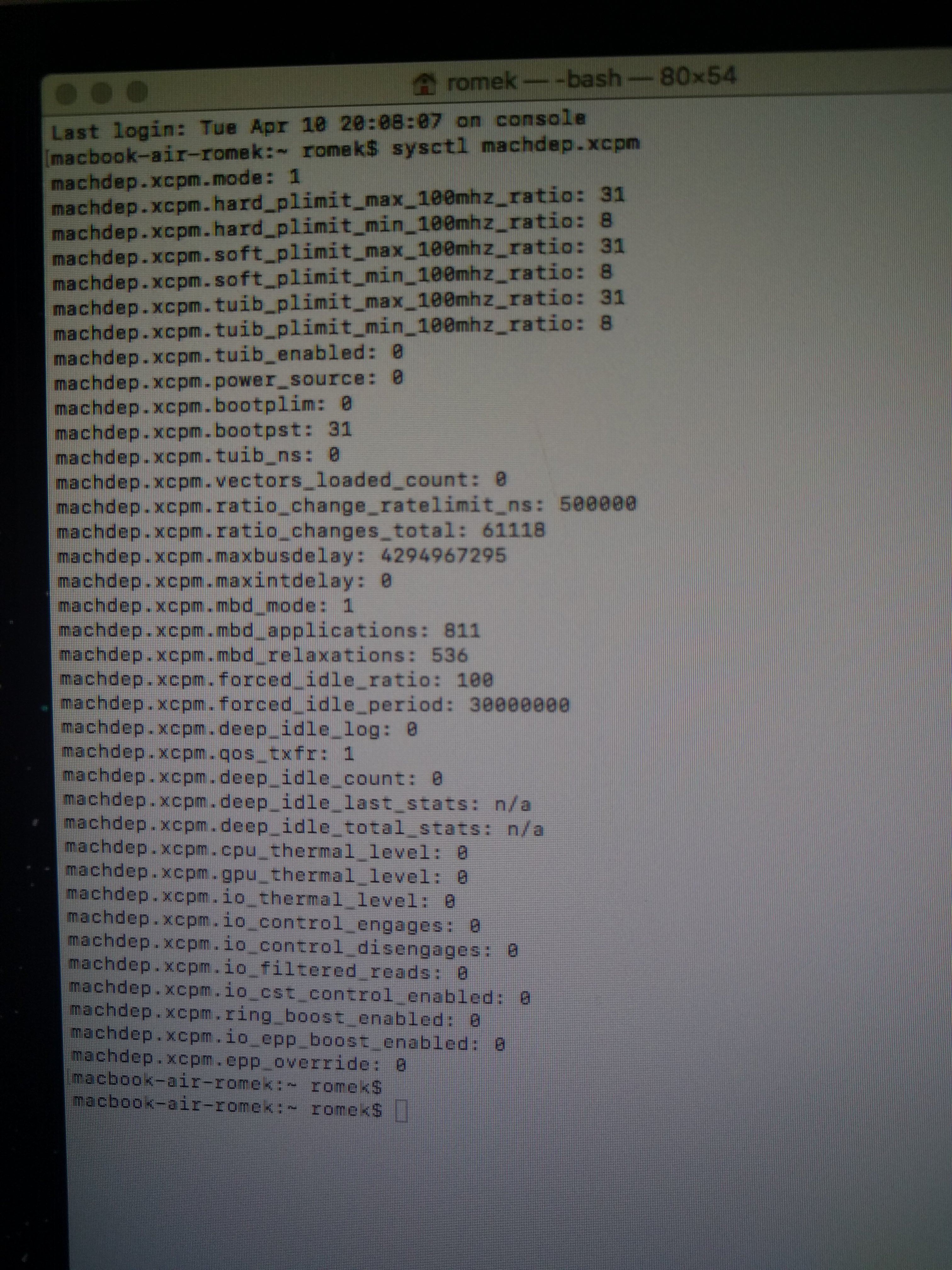

dEaK Posted April 10, 2018 Author Share Posted April 10, 2018 With imacPro1.1 smbios does not boot. Link to comment https://www.insanelymac.com/forum/topic/333764-my-osx86-is-20-slower-than-windows-in-cinebench/page/2/#findComment-2608977 Share on other sites More sharing options...
Guest Posted April 10, 2018 Share Posted April 10, 2018 mmh sorry for this..it is strange could you test Mac Pro 6.1? in a working and booting condition try to run from terminal this sysctl machdep.xcpm and put here result Link to comment https://www.insanelymac.com/forum/topic/333764-my-osx86-is-20-slower-than-windows-in-cinebench/page/2/#findComment-2608979 Share on other sites More sharing options...
dEaK Posted April 10, 2018 Author Share Posted April 10, 2018 Link to comment https://www.insanelymac.com/forum/topic/333764-my-osx86-is-20-slower-than-windows-in-cinebench/page/2/#findComment-2608986 Share on other sites More sharing options...
Guest Posted April 11, 2018 Share Posted April 11, 2018 Frequency vectors_loaded count should be set to 1 You could try to use frequency vectors.sh by piker alpha and choose a 14.1 Smbios frequency vectors injection or try to understand why iMac Pro 1.1 Smbios do not work for you Link to comment https://www.insanelymac.com/forum/topic/333764-my-osx86-is-20-slower-than-windows-in-cinebench/page/2/#findComment-2609094 Share on other sites More sharing options...
