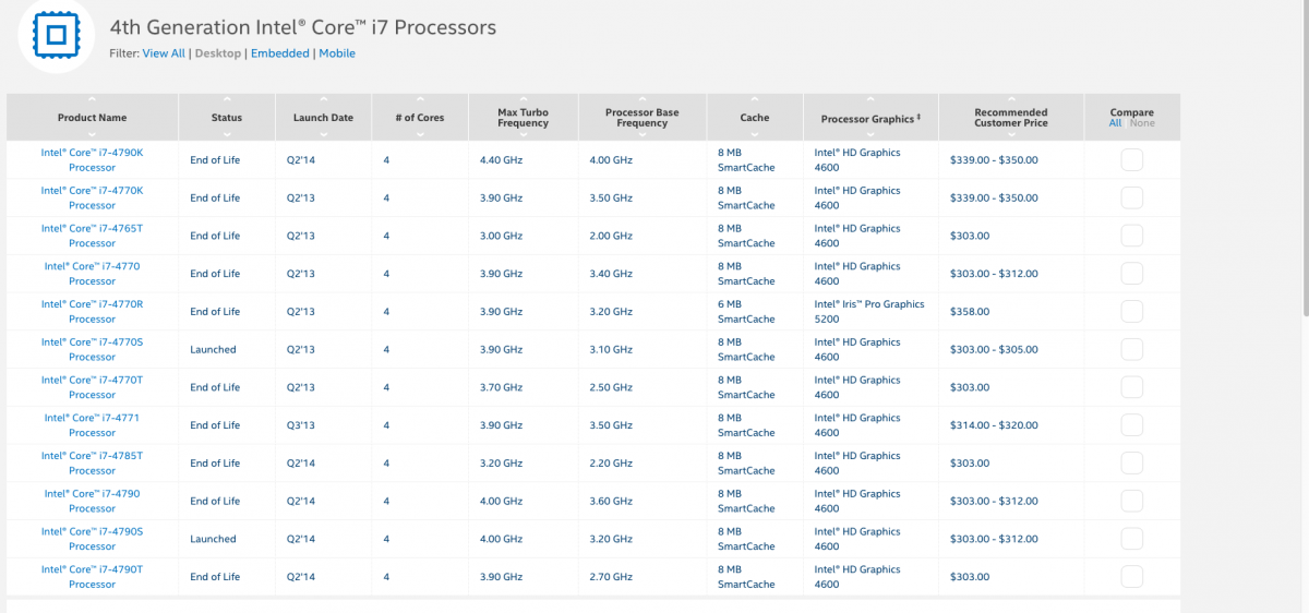

Jolly Posted February 4, 2018 Share Posted February 4, 2018 i7-4875t è un processore Laptop non desktop Come non detto Link to comment https://www.insanelymac.com/forum/topic/331340-lenovo-g510/page/7/#findComment-2584391 Share on other sites More sharing options...
cocciolone Posted February 4, 2018 Author Share Posted February 4, 2018 i7-4875t è un processore Laptop non desktop Scusa jolly ma è un desktop Link to comment https://www.insanelymac.com/forum/topic/331340-lenovo-g510/page/7/#findComment-2584613 Share on other sites More sharing options...
