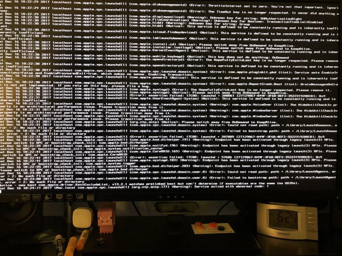

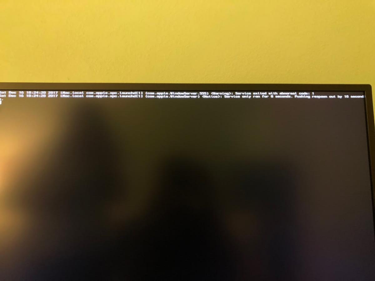

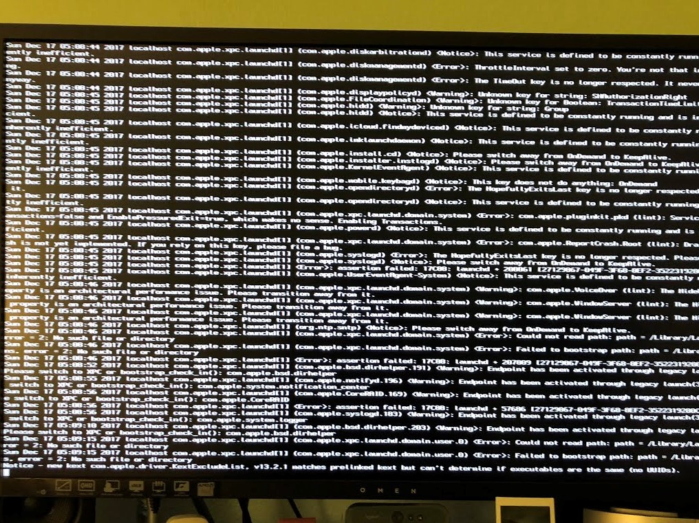

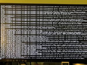

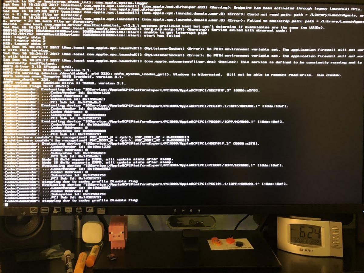

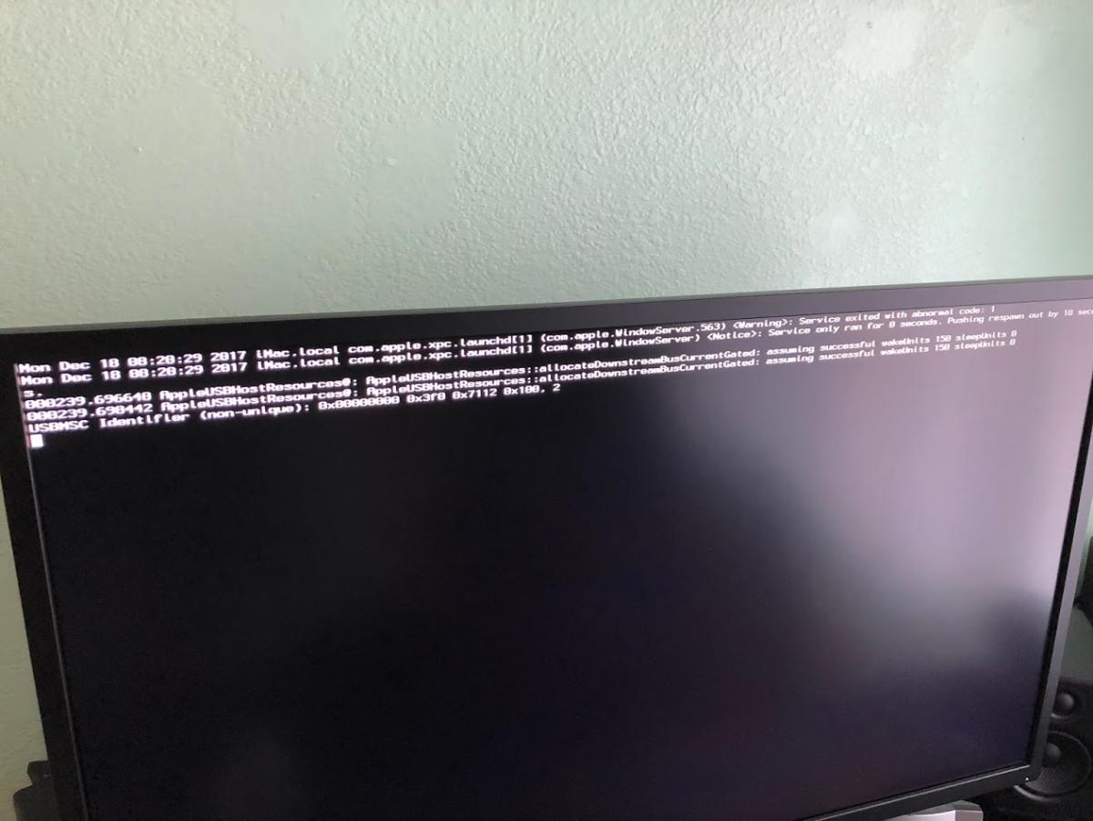

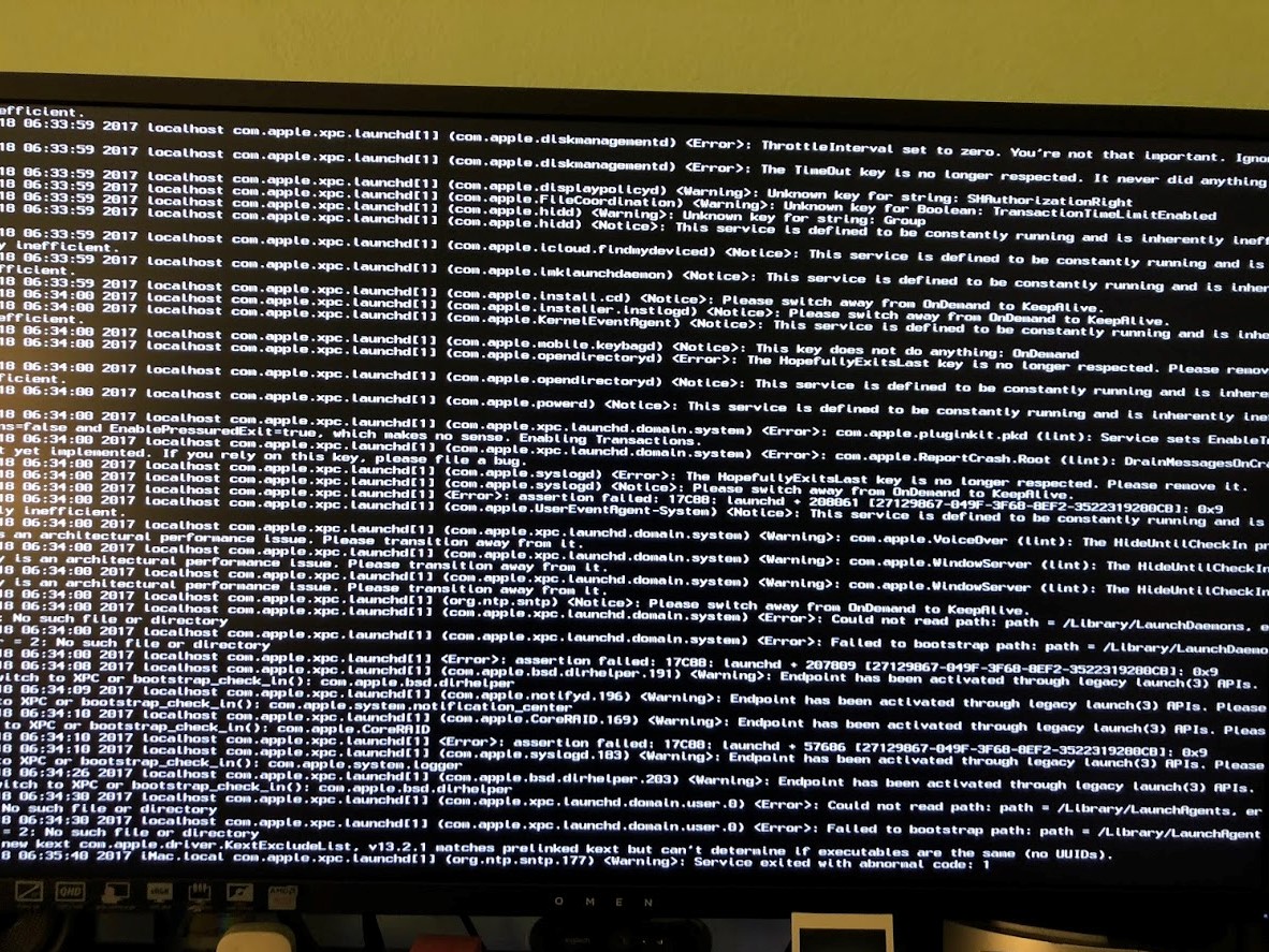

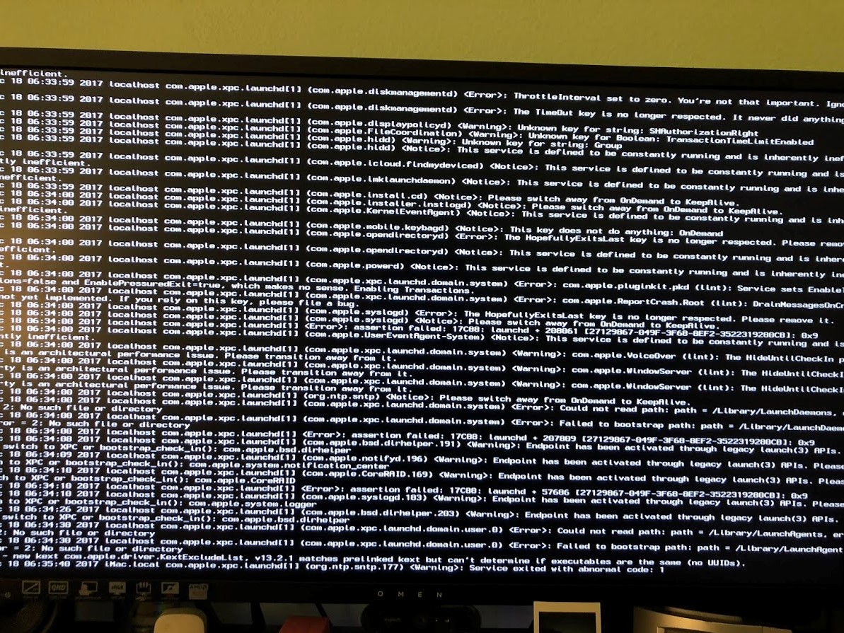

Friendlyx Posted December 18, 2017 Share Posted December 18, 2017 Hello everyone! I'm trying to get my hackintosh running, but i haven't been able to sadly. I'm basically trying to install high sierra onto my computer which is the following specs: Intel i7 8700k Gigabyte Z370 AORUS Gaming 7 Gigabyte 1080 Ti AORUS Xtreme Edition 11GB I had high sierra installed, but i messed up the software somehow, and then i thought i could just reinstall it (since it was really easy the first time, no issues) but was i wrong. I haven't been able to reinstall it even after wiping the drive completely clean. I am running windows 10, so i will be doing a dual boot. I started following the following guide and it worked for the first time, but even after using their EFI it isn't working still: http://hackintosher.com/builds/gigabyte-z370-aorus-gaming-7-hackintosh-build-guide/ I'd appreciate any help i could get, i'm really at a loss. Thanks in advanced! Link to comment Share on other sites More sharing options...

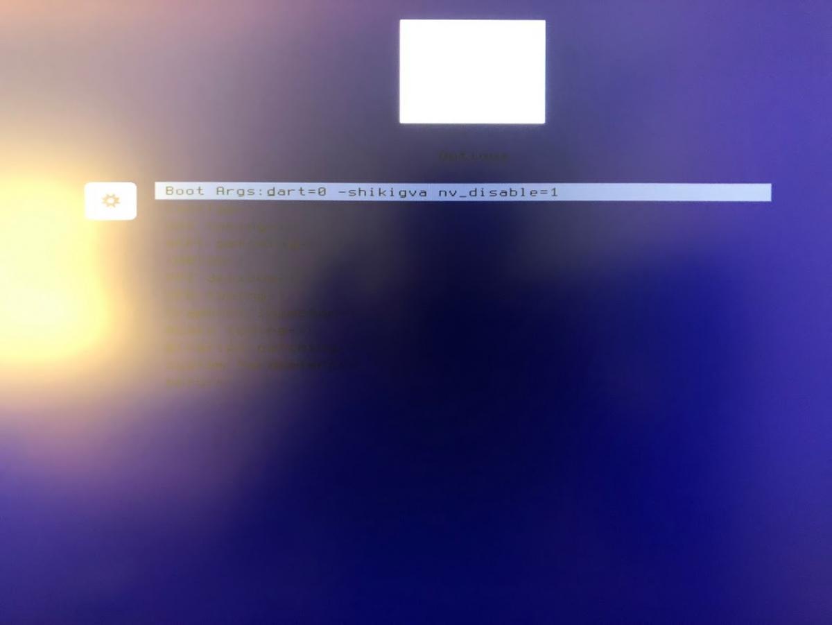

Gigamaxx Posted December 18, 2017 Share Posted December 18, 2017 Disconnect the windows drive while installing. Use clover boot argument nv_disable=1. Once installed install Nvidia web drivers. Link to comment Share on other sites More sharing options...

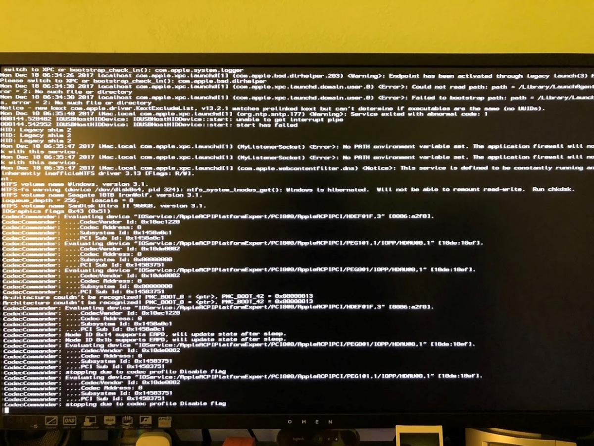

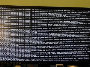

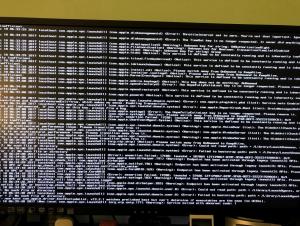

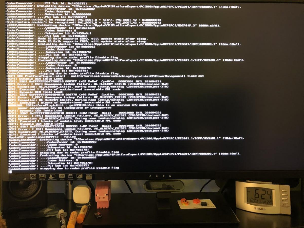

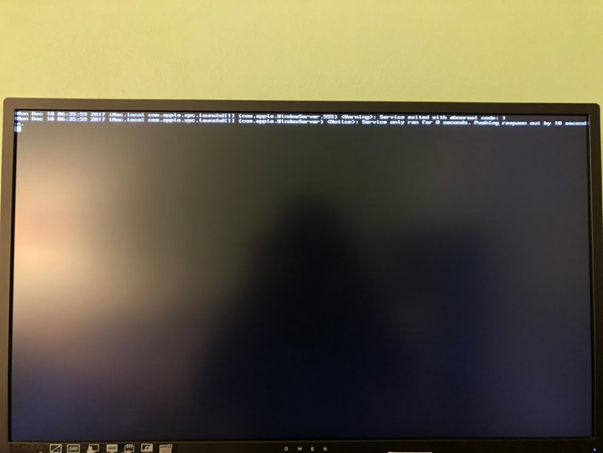

Friendlyx Posted December 18, 2017 Author Share Posted December 18, 2017 Disconnect the windows drive while installing. Use clover boot argument nv_disable=1. Once installed install Nvidia web drivers. Hi there! Thank you for attempting to help me, however i did go ahead and set the argument and it still ends at the same issue. I've included more pictures and what i put in there. I've attached the new pictures to the original post after the blueish looking one, don't know why but my clover looks weird when i go to it. Hopefully you can help. Thank you! EDIT: I even doing the guide all over again, same issue, i waited long enough and got another thing after the abnormal code:1 thing. I've attached it in the pictures in the original post. EDIT: I tried using a different usb and different USB port, same issue. Link to comment Share on other sites More sharing options...
