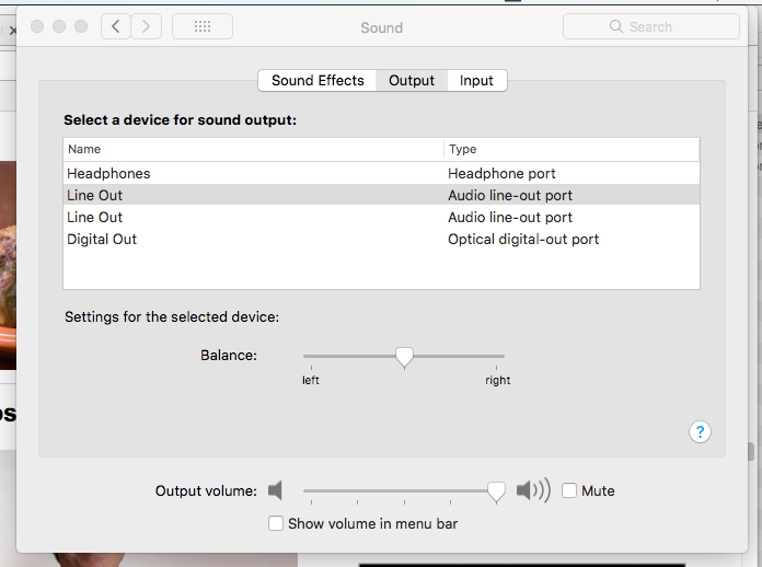

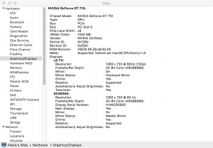

cadash Posted December 4, 2017 Author Share Posted December 4, 2017 Thanks for the info Shanee, I used cloverconfigurator and check nvda_drv=1 but it doesn't matter whether I use OSX default drivers or web drivers, the HDMI sound is not listed under Preferences/Sound/Output I am attaching the system display info in case it might help. (The display is scaled to 720p because I have it connected to a TV as well. Turn it back to 1080p when using the monitor alone) Link to comment https://www.insanelymac.com/forum/topic/330215-no-hdmi-sound-on-nvidia-gt710/#findComment-2544254 Share on other sites More sharing options...
Shaneee Posted December 5, 2017 Share Posted December 5, 2017 nvda_drv doesn't work on 10.13 If you have the web drivers installed check NvidiaWeb in the config. It's under System Parameters in Clover Configurator. If they weren't actually enabled that may sort it. The only difference I can see between our cards is I have the Gigabyte 2GB model. Link to comment https://www.insanelymac.com/forum/topic/330215-no-hdmi-sound-on-nvidia-gt710/#findComment-2544485 Share on other sites More sharing options...

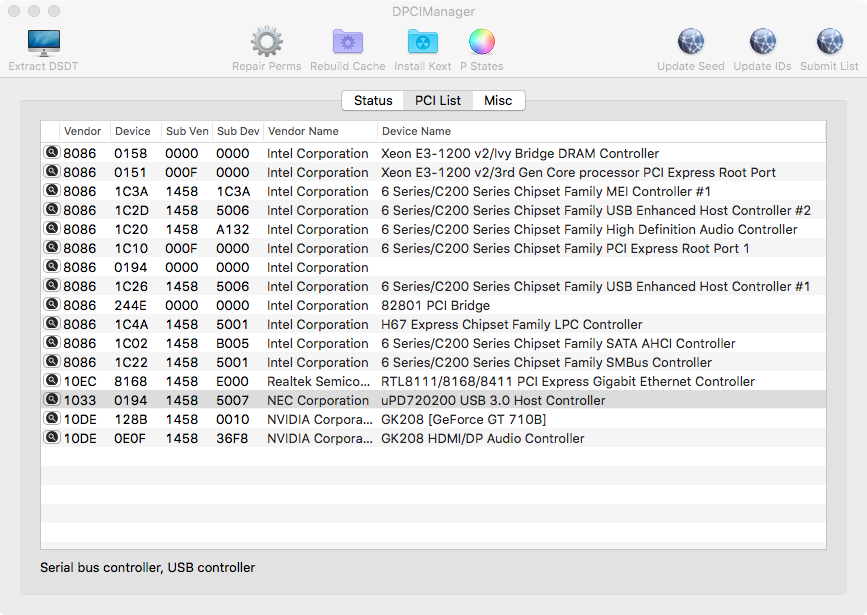

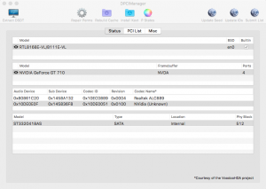

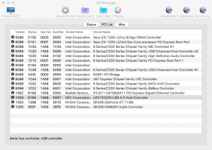

cadash Posted December 7, 2017 Author Share Posted December 7, 2017 cloverALC is onboard Realtek audio only. See AppleHDA HDMI Audio - HDMI Audio, try cloverHDMI I tried clover HDMI, it creates a patch under ACPI but it still won't load the HDMI sound. I am attaching some screenshots about the device information in case it helps. Link to comment https://www.insanelymac.com/forum/topic/330215-no-hdmi-sound-on-nvidia-gt710/#findComment-2545427 Share on other sites More sharing options...
toleda Posted December 8, 2017 Share Posted December 8, 2017 I tried clover HDMI, it creates a patch under ACPI but it still won't load the HDMI sound. See AppleHDA HDMI Audio - HDMI Audio/Post #1/IV. Problem Reporting; post to thread linked with requested files attached. 1 Link to comment https://www.insanelymac.com/forum/topic/330215-no-hdmi-sound-on-nvidia-gt710/#findComment-2546744 Share on other sites More sharing options...
