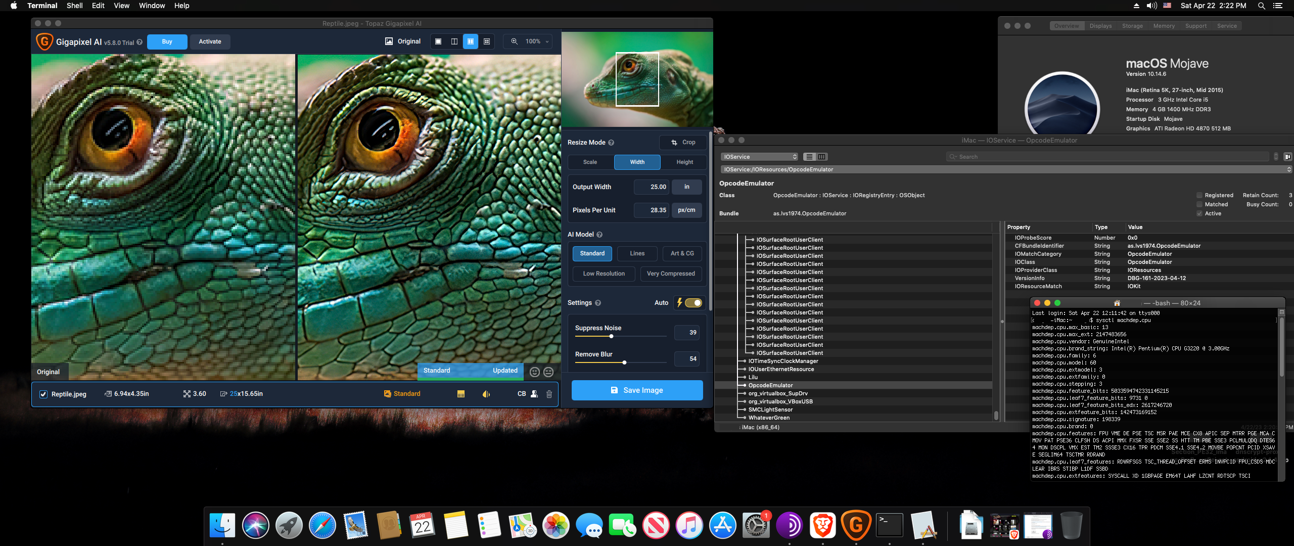

hardcorehenry Posted April 22, 2023 Share Posted April 22, 2023 (edited) On 4/22/2023 at 6:11 AM, Slice said: sysctl machdep.cpu will show you CPU capabilities calculated from CPUID response. It will not show emulated instructions. The correct check will be an application that compiled with tested instructions like AVX2. The application will crash without AVX2 support. Is there anybody have such a test? Many years ago I had a CPU without SSE3 instructions and I had a kernel (MacOSX 10.4 Tiger) with an emulator for such instruction so I really saw how it works. Now I see no any test for this emulator. Gigapixel AI (installed for test only) requires presence of AVX2 and theoretically should crash, but it doesn’t, would that mean OpcodeEmulator.kext works? I guess indeed better to wait till someone suggests a proper/better test. Spoiler Edited April 23, 2023 by hardcorehenry 1 Link to comment https://www.insanelymac.com/forum/topic/329704-opcode-emulator-opemu-plug-in-project/page/3/#findComment-2803933 Share on other sites More sharing options...
