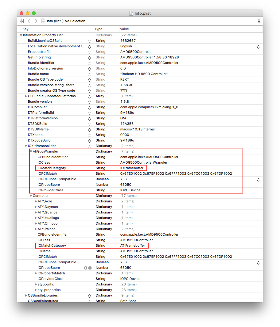

rioredstone Posted November 13, 2017 Share Posted November 13, 2017 I've been trying to have my RX460 work. in vanilla state, it worked only in safe mode. I found some kexts, AMD95**, which have the same device id as my rx460, 0x67EF1002. so I removed 9510, 9515 and 9520, then it works without no acceleration. so I compared High Sierra's AMD9500 with Sierra's. High Sierra's AMD9500 contains "AtiGpuWrangler" in IOKitPersonalities. and the os loads AMD9500ControllerWrangler, and does not load AMDRadeonX4*** framebuffer. on Sierra, AMDRadeonX4200 is loaded. I think, in order to have my RX460 work, AMDRadeonX4*** need to be loaded. so now I have a question. what is AtiGpuWrangler? what is AMD9500ControllerWrangler? and also, in IOKitPersonalities in AMD9500, there are 2 IOMatchCategory, IOFramebuffer in AtiGpuWrangler and ATIFramebuffer in Controller. what does this means?? Link to comment https://www.insanelymac.com/forum/topic/329602-no-acceleration-for-radeon-rx460/ Share on other sites More sharing options...
