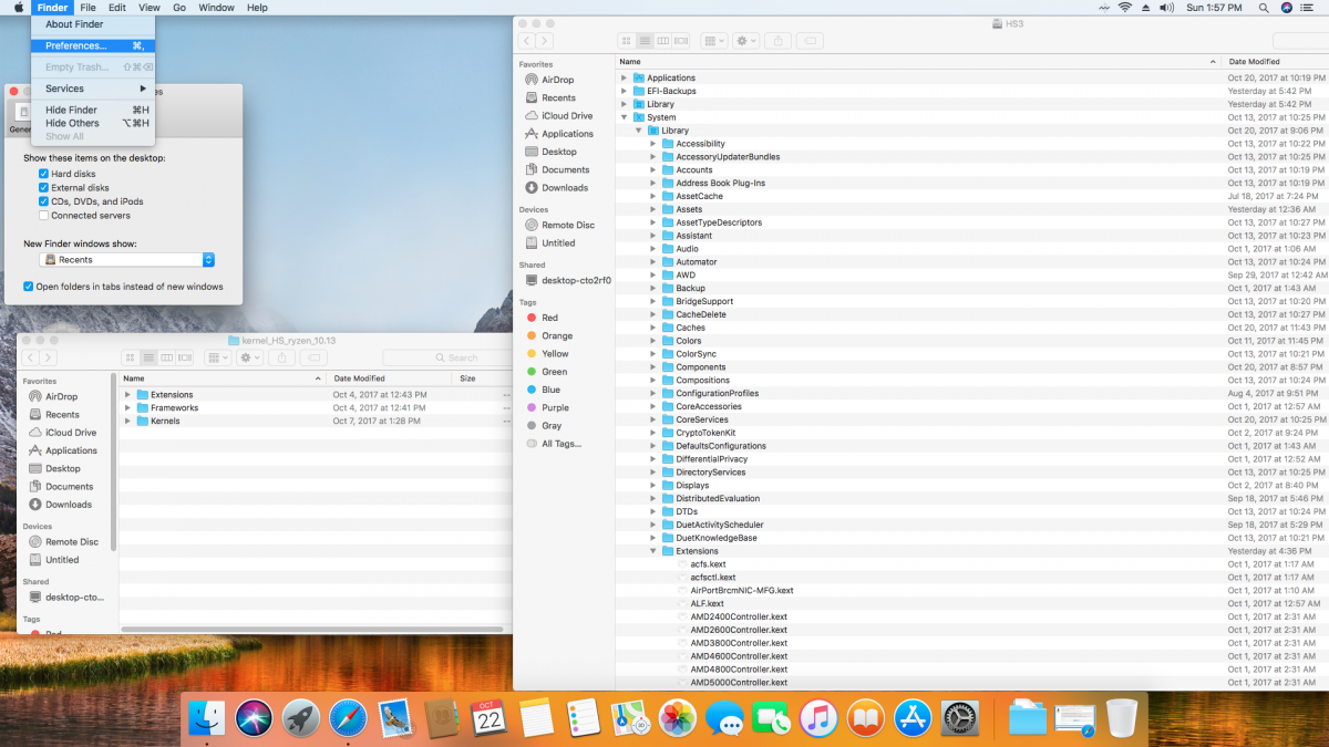

Gigamaxx Posted October 22, 2017 Share Posted October 22, 2017 This is a basic guide to get AMD Ryzen systems working in High Sierra. You can create a USB installer following the link below or use the Kernel link to manually edit a cloned or copied disk with High Sierra already installed. 1). To create a USB installer follow the link here and then add/replace the Ryzen pre and post install folders after installer is finished and follow the guide for post instal using the kernel_ext_install_only terminal command option. http://www.insanelymac.com/forum/topic/325514-amd-high-sierra-kernel-release-and-testing/page-24?do=findComment&comment=2519914 2). To use the disk edit method download the link materials and follow these basic instructions to add kernel and system kext. First you will need a HDD or SSD with High Sierra installed. it can be copied using carbon copy cloner or Super Duper, pulled form a working Hackintosh ( intel) or a fresh install. You will need a way to connect your test disk to a working Mac or Hack like a USB to Sata or if you have a Sata connection available use it. Step 1). Open system used to edit the disk and go to top tool bar and select "Finder" scroll to "Preferences" click it. Check the Hard Disk box, this will show all drives on the desktop along with EFI partitions during the edit. Name your test disk something like Ryzen so that it doesn't get mistaken for your working system drive. Be especially careful when loading clover to the drive check the Change Install Disk option and make sure you only load it to the Ryzen drive. Step 2). Open the kernels folder from the link in downloads and drag it to the desktop. Next open the risen disk now showing on desktop. Click on the System folder, then Library folder. Now scroll down to "Extensions" folder and click on side arrow to open. Leave this folder open but move the window to one side of the screen or the other so you can access it during edits. You will be going from the Kernels folder to Ryzen disk folder so its best to set them side by side for the edits (see pic). Open the Kernels folder on desktop and open the Extensions folder. Drag the "System Kext" to the "Extensions" folder on the Ryzen drive. You will get "Authenticate" and a "replace" set of options do both. If you don't get the "replace" option then hit cancel and repeat until you have the replace option before using password. Step 3). Close the "Extensions" folder tab arrow and scroll down to Kernels folder and click on arrow tab. Next go to Kernels folder on Desktop and drag the kernel to the Ryzen drive kernel folder. You should get the "Authenticate" and "replace" prompts again. Step 4). Close the Kernels folder and scroll to PrelinkedKernels folder and hit arrow tab. Drag the prelnked kernel from the desktop kernel folder to the relinked kernels folder and replace it. Follow the usual prompts. Optional, you can remove the "immutable kernel" or leave it there. If you cannot boot after several attempts you may need to remove nit to help load the new kernel. Step 5). Now the post important part is to run Kext wizard or equivalent Kext repair tool. We need to rebuild caches and repair permissions. Make sure to select the risen disk as the target disk for this. Kext wizard allows you to select a target disk other utilities may not. Step 6). Open Clover boot loader and load onto the Ryzen disk. Be especially careful when loading clover to the drive check the Change Install Disk option and make sure you only load it to the Ryzen drive. After clover is installed open the EFi icon on desktop (disk) and then open the Clover folder. Replace the config.plist and kext folder Other. Check your Drivers64Efi folder for the apfsEFi driver in case you need it. Place it there if needed. Ryzen High sierra Kernels and Kext.zip 3 Link to comment https://www.insanelymac.com/forum/topic/328795-amd-ryzen-high-sierra-install-guide/ Share on other sites More sharing options...

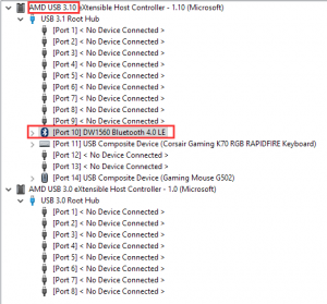

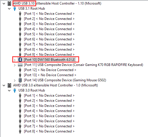

nvflash Posted October 28, 2017 Share Posted October 28, 2017 AMD doesn't seem to expose USB 2.0 on the PCI Bus on 300 Series Chipsets. It seem we only see two Serial bus controller's: USB controller [0c03]: Advanced Micro Devices, Inc. [AMD] 300 Series Chipset USB 3.1 xHCI Controller [1022:43bb] (rev 02) USB controller [0c03]: Advanced Micro Devices, Inc. [AMD] Family 17h (Models 00h-0fh) USB 3.0 Host Controller [1022:145c] [0c] Serial bus controller [03] USB controller Program interfaces Id Name Note 00 UHCI 10 OHCI 20 EHCI 30 XHCI 80 Unspecified fe USB Device What we are missing is 0c032000, no EHCI, as 0x0c032000 is what Apple's EHCI kext file looks for, we have no USB 2.0 ports or drivers. As for USB 3.1, the Apple XHCI driver loads, but fails to create ports for USB 3.1 devices. I think a DSDT edit could fix USB 3.1, it's likely the ports are not properly laid out in ACPI. However, I don't have any clue what to do about USB 2.0. In linux, the USB 2.0 ports work, and lsusb sees the 2.0 Hubs and devices, so whatever the linux usb kernel drivers do for AMD 300 chipsets seems to work, if we could figure out how, we should be able to fix this? Bus 004 Device 001: ID 1d6b:0003 Linux Foundation 3.0 root hub Bus 003 Device 004: ID 04e8:6860 Samsung Electronics Co., Ltd Galaxy (MTP) Bus 003 Device 001: ID 1d6b:0002 Linux Foundation 2.0 root hub Bus 002 Device 001: ID 1d6b:0003 Linux Foundation 3.0 root hub Bus 001 Device 006: ID 05ac:828d Apple, Inc. Bus 001 Device 003: ID 0a5c:4500 Broadcom Corp. BCM2046B1 USB 2.0 Hub (part of BCM2046 Bluetooth) Bus 001 Device 007: ID 413c:3016 Dell Computer Corp. Optical 5-Button Wheel Mouse Bus 001 Device 008: ID 413c:2113 Dell Computer Corp. Bus 001 Device 002: ID 0930:6545 Toshiba Corp. Kingston DataTraveler 102/2.0 / HEMA Flash Drive 2 GB / PNY Attache 4GB Stick Bus 001 Device 001: ID 1d6b:0002 Linux Foundation 2.0 root hub 1 Link to comment https://www.insanelymac.com/forum/topic/328795-amd-ryzen-high-sierra-install-guide/#findComment-2524031 Share on other sites More sharing options...
nvflash Posted October 28, 2017 Share Posted October 28, 2017 I think, somewhere is this code from the DTDT lies the problem: Device (PTXH) { Name (_ADR, Zero) Method (_PRW, 0, NotSerialized) { Return (GPRW (0x19, 0x04)) } Device (RHUB) { Name (_ADR, Zero) OperationRegion (PDID, PCI_Config, Zero, 0x04) Field (PDID, AnyAcc, NoLock, Preserve) { Offset (0x02), XDID, 16 } Name (PT4, Package (0x16) { One, 0x02, 0x03, 0x04, 0x05, 0x06, 0x07, 0x08, One, 0x02, 0x03, 0x04, 0x05, 0x06, 0x07, 0x08, 0x09, 0x0A, 0x0B, 0x0C, 0x0D, 0x0E }) Name (PT2, Package (0x16) { One, 0x02, 0x03, 0x04, One, 0x02, 0x03, 0x04, 0x05, 0x06, 0x07, 0x08, 0x09, 0x0A, 0x0B, 0x0C, 0x0D, 0x0E, 0x0F, 0x10, 0x11, 0x12 }) Name (PT1, Package (0x16) { One, 0x02, 0x03, One, 0x02, 0x03, 0x04, 0x05, 0x06, 0x07, 0x08, 0x09, 0x0A, 0x0B, 0x0C, 0x0D, 0x0E, 0x0F, 0x10, 0x11, 0x12, 0x13 }) Name (USBV, Package (0x16) { One, One, One, One, One, One, One, One, One, One, One, One, One, One, Zero, Zero, Zero, Zero, Zero, Zero, Zero, Zero }) Name (USBP, Package (0x16) {}) Method (UPGP, 0, Serialized) { Store (0x16, Local0) If (LEqual (XDID, 0x43B9)) { While (Local0) { Decrement (Local0) Store (DerefOf (Index (PT4, Local0)), Index (USBP, Local0)) } } Else { If (LEqual (XDID, 0x43BB)) { While (Local0) { Decrement (Local0) Store (DerefOf (Index (PT2, Local0)), Index (USBP, Local0)) } } Else { If (LEqual (XDID, 0x43BC)) { While (Local0) { Decrement (Local0) Store (DerefOf (Index (PT1, Local0)), Index (USBP, Local0)) } } } } } Link to comment https://www.insanelymac.com/forum/topic/328795-amd-ryzen-high-sierra-install-guide/#findComment-2524099 Share on other sites More sharing options...

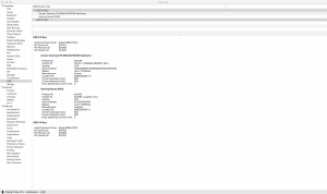

Gigamaxx Posted October 28, 2017 Author Share Posted October 28, 2017 My mainboard 2.0 ports work but they list as 3.0 ports in About this Mac. If I use GenericUSBkext all ports work but no listing, and no hot plugging. Link to comment https://www.insanelymac.com/forum/topic/328795-amd-ryzen-high-sierra-install-guide/#findComment-2524117 Share on other sites More sharing options...

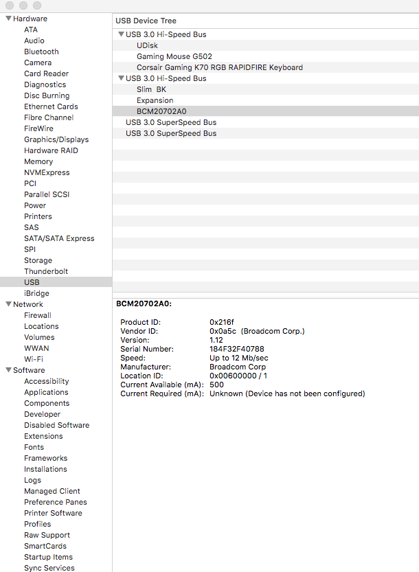

nvflash Posted October 30, 2017 Share Posted October 30, 2017 Hmmm....... As it seems, GenericUSBXHCI breaks Bluetooth support, so you must replace a few things from Yosemite, then if you want USB to show up in ASP, you need to copy SPUSBReporter.spreporter to /System/Library/SystemProfiler/. Backup IOBluetoothFamily.kext and IOBluetoothHIDDriver.kext, and remove them from /S/L/E, then put the one's I provide in your Clover Extensions folder. https://drive.google.com/open?id=0B9sU4v5iZl0pUDFUSElteW42SkU 2 Link to comment https://www.insanelymac.com/forum/topic/328795-amd-ryzen-high-sierra-install-guide/#findComment-2525045 Share on other sites More sharing options...
DPyro Posted October 31, 2017 Share Posted October 31, 2017 Is this why my bluetooth is not detected? EDIT: This is what I get with no GenericUSBXHCI and SPUSBReporter.spreporter USB 3.1 ports on back don't work and neither does the front USB. Bluetooth still not detected. Link to comment https://www.insanelymac.com/forum/topic/328795-amd-ryzen-high-sierra-install-guide/#findComment-2525630 Share on other sites More sharing options...
nvflash Posted October 31, 2017 Share Posted October 31, 2017 Is this why my bluetooth is not detected? EDIT: This is what I get with no GenericUSBXHCI and SPUSBReporter.spreporter USB 3.1 ports on back don't work and neither does the front USB. Bluetooth still not detected. Mine didn't work either, and I'm using an Apple branded bluetooth. It would show up as a Hub under USB, without GenXHCI, but not as a bluetooth device. Applying the bluetooth files I linked form Yosemite and using GenXHCI fixed the issue. 1 Link to comment https://www.insanelymac.com/forum/topic/328795-amd-ryzen-high-sierra-install-guide/#findComment-2525815 Share on other sites More sharing options...
DPyro Posted November 1, 2017 Share Posted November 1, 2017 This is as far as I got. All ports working but still no bluetooth. Link to comment https://www.insanelymac.com/forum/topic/328795-amd-ryzen-high-sierra-install-guide/#findComment-2526358 Share on other sites More sharing options...
