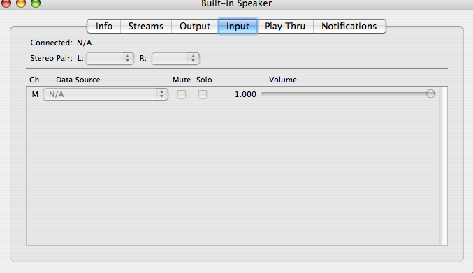

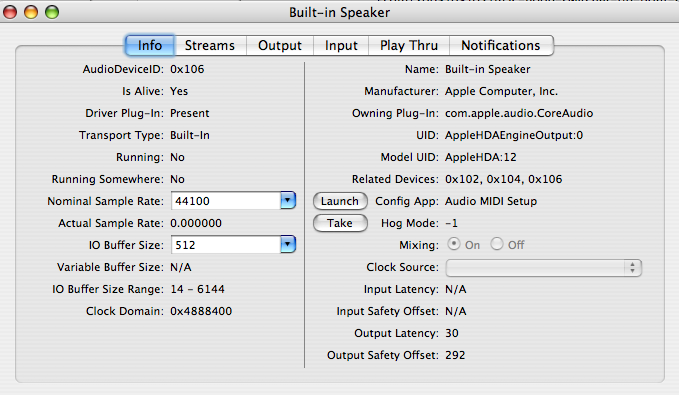

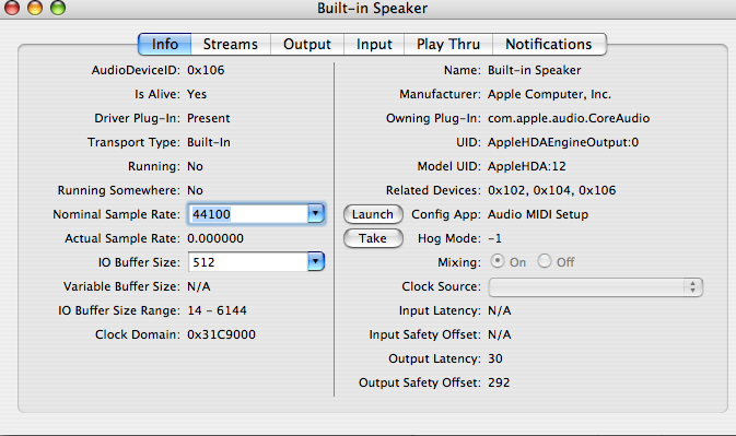

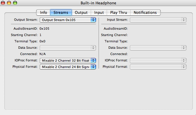

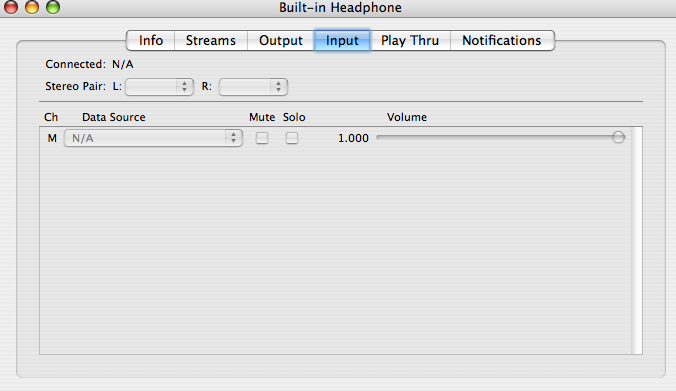

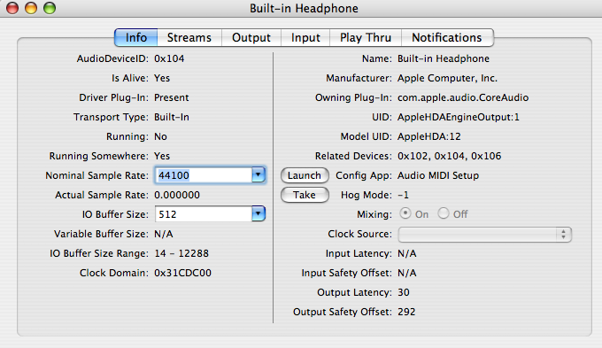

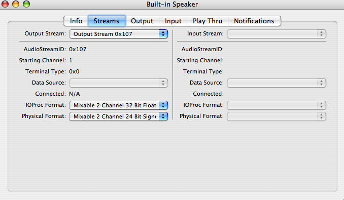

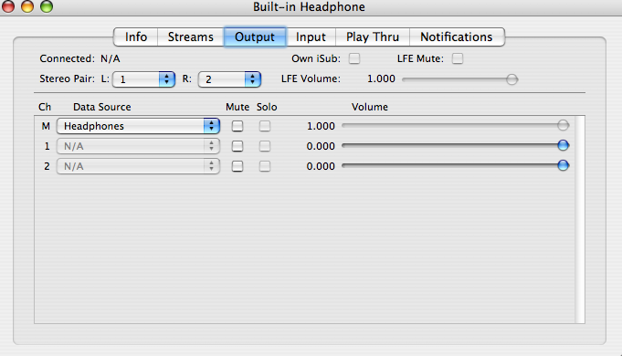

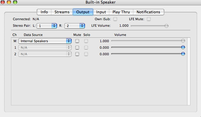

Okay I tried both other tests now even though I don't have a built in mic but no matter which one I try I can't get sound to come out of any area, neither headphones nor built-in speakers. I was using hallab2 to check if it registers when itunes is playing a song and it indeed does and if I change it from headphones to speakers or vice-versa hallab shows the running somewhere option as yes or no depending. I tried this process using no azaliaaudio, the unmodified azalia, and the azalia that is modded to make the internal speakers work, all with no success. What have others done to get sound on their 262's?
EDIT:
I've attached some of the screens that Hallab shows for headphones and speakers, could the be that (in reference to picture 3) Channel M is mostly grayed out?

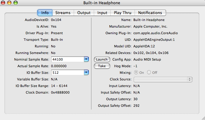

Like ghostparty, I tried both the alc262test2 and 3 and although it's now showing the same as others in hallab, I get no sound out of headphones or speakers. Also I get zero input on my mic port, where I was getting some before on archive.zip. With test 2 and 3, there hallab does indeed show that something is coming through when i start and stop mp3s in itunes.
Here's some screens from the test2 kexts.

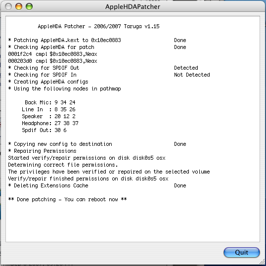

This is what I get for Intel 82801G HD Audio
AppleHDA Patcher - 2006/2007 Taruga v1.16
_______________________________________________________
Codec : Generic 14f1 ID 5045
Vendor Id : 0x14f15045
Subsystem Id : 0x103c30b2
* Detected unsupported Generic Codec
Attached is the codec dump
intel8280.txt
Try v1.16 it´s the most recent....
