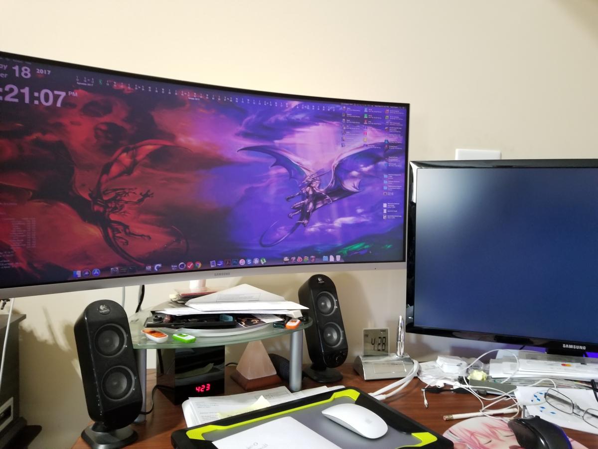

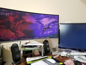

Gogeta5026 Posted September 18, 2017 Author Share Posted September 18, 2017 Have you tried disabling free Sync on the monitors? Freesync may only work in Windows and or Linux, Apple may not use it in their drivers. Clover Configurator app has a dual link option set to 1, it may work to get both functional. The 2 pictures attached are what happens. Boots with 1 monitor on. As soon as the 2nd monitor is turned on or plugged in... The working monitor goes black and everything stops responding. Link to comment https://www.insanelymac.com/forum/topic/327194-34-widescreen-monitor-not-working-with-high-sierra/#findComment-2496749 Share on other sites More sharing options...
Gigamaxx Posted September 18, 2017 Share Posted September 18, 2017 Are they both on DisplayPort? There is a Framebuffer/port assignment thread for assigning the order of your graphics ports. The apple graphics cards used in their machines are usually different from consumer vcards when it comes to the display outputs. Have you tried one on hdmi and the other on Displayport?I'll try to find the thread and link it for you, it will explain the possible reason for the black screen. Baladi, Orinoco, and Berbice are the 3 main Framebuffers if you want to try those using clover. http://www.insanelymac.com/forum/topic/288601-patched-framebuffer-repository/?do=findComment&comment=1915940 Mork did one for the Sapphire RX 480 8gb, but I can't find it now. Link to comment https://www.insanelymac.com/forum/topic/327194-34-widescreen-monitor-not-working-with-high-sierra/#findComment-2496787 Share on other sites More sharing options...
