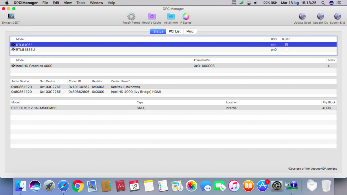

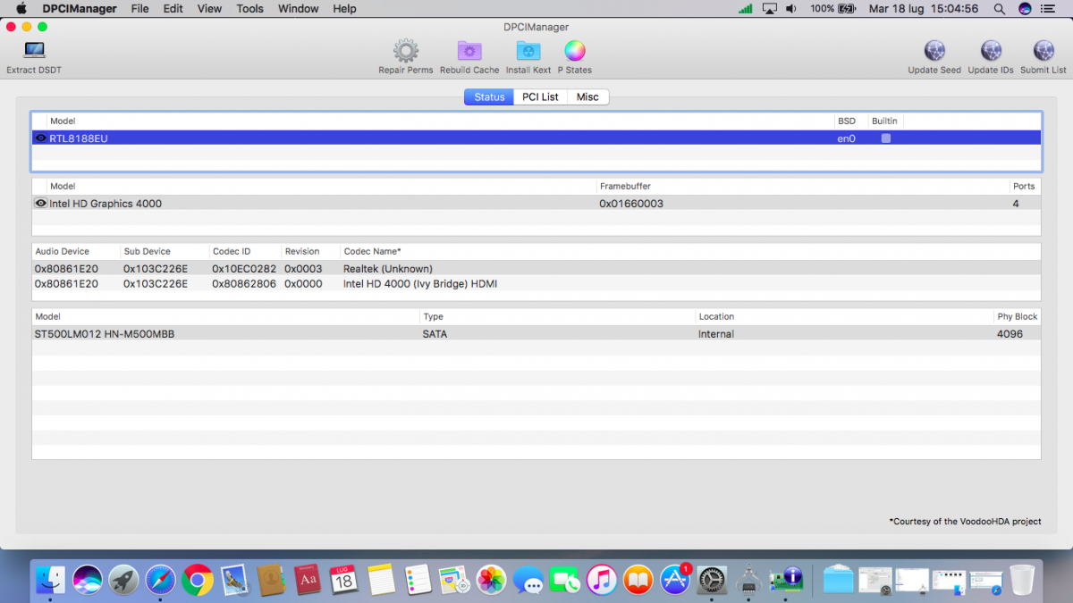

Fabio29 Posted July 18, 2017 Author Share Posted July 18, 2017 Non ho nemmeno la builtin attiva.... Sempre su Preferenze di sistema/Network la configura la ethernet? Link to comment https://www.insanelymac.com/forum/topic/325088-installazione-macos-sierra-su-notebook-hp-250-g3/page/4/#findComment-2465195 Share on other sites More sharing options...
gengik84 Posted July 18, 2017 Share Posted July 18, 2017 quello è il wifi.... Link to comment https://www.insanelymac.com/forum/topic/325088-installazione-macos-sierra-su-notebook-hp-250-g3/page/4/#findComment-2465200 Share on other sites More sharing options...
Fabio29 Posted July 18, 2017 Author Share Posted July 18, 2017 Ahhh.... Da dove la configuro?? Link to comment https://www.insanelymac.com/forum/topic/325088-installazione-macos-sierra-su-notebook-hp-250-g3/page/4/#findComment-2465201 Share on other sites More sharing options...
gengik84 Posted July 18, 2017 Share Posted July 18, 2017 Metti il kext allegato nella EFIRealtekRTL8100.kext.zip Riavvia e controlla Se hai altri kext rete, rimuovili Link to comment https://www.insanelymac.com/forum/topic/325088-installazione-macos-sierra-su-notebook-hp-250-g3/page/4/#findComment-2465204 Share on other sites More sharing options...
Fabio29 Posted July 18, 2017 Author Share Posted July 18, 2017 Solo che ora risulta en1... Elimino i Kext network e riavvio?? Link to comment https://www.insanelymac.com/forum/topic/325088-installazione-macos-sierra-su-notebook-hp-250-g3/page/4/#findComment-2465210 Share on other sites More sharing options...
gengik84 Posted July 18, 2017 Share Posted July 18, 2017 ti ho fatto uno script per semplificare Fix_en0.zip Lancialo, poi dovrai riavviare Link to comment https://www.insanelymac.com/forum/topic/325088-installazione-macos-sierra-su-notebook-hp-250-g3/page/4/#findComment-2465213 Share on other sites More sharing options...
Fabio29 Posted July 18, 2017 Author Share Posted July 18, 2017 Ok ha funzionato... accesso a App Store e Siri non da più problemi di connessione... Link to comment https://www.insanelymac.com/forum/topic/325088-installazione-macos-sierra-su-notebook-hp-250-g3/page/4/#findComment-2465222 Share on other sites More sharing options...

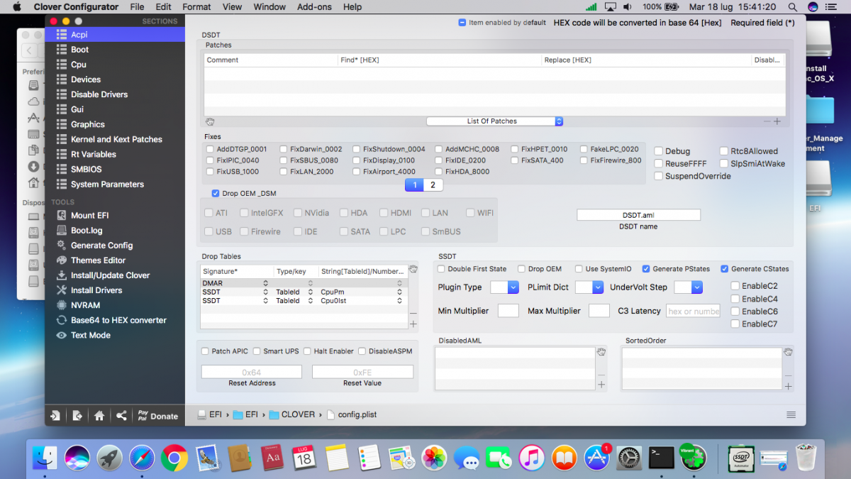

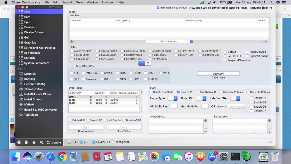

gengik84 Posted July 18, 2017 Share Posted July 18, 2017 usa SSDT_Automator segui le istruzioni fornite alla fine, oltre a quelle elencate, ne tuo caso, sul config,sezione acpi devi mettere il flag su Drop OEM Link to comment https://www.insanelymac.com/forum/topic/325088-installazione-macos-sierra-su-notebook-hp-250-g3/page/4/#findComment-2465230 Share on other sites More sharing options...

Fabio29 Posted July 18, 2017 Author Share Posted July 18, 2017 E in fine cosi deve risultare vero? Disable C & P states, if enabled, on the config.plist.. Questo che comando sarebbe?? Link to comment https://www.insanelymac.com/forum/topic/325088-installazione-macos-sierra-su-notebook-hp-250-g3/page/4/#findComment-2465246 Share on other sites More sharing options...
gengik84 Posted July 18, 2017 Share Posted July 18, 2017 non cosi.. Devi rimuovere i flag da Generate C & P states e mettere il flag su Drop OEM ma non in Drop OEM_Dsm Link to comment https://www.insanelymac.com/forum/topic/325088-installazione-macos-sierra-su-notebook-hp-250-g3/page/4/#findComment-2465248 Share on other sites More sharing options...
Fabio29 Posted July 18, 2017 Author Share Posted July 18, 2017 Ahh... cosi... Link to comment https://www.insanelymac.com/forum/topic/325088-installazione-macos-sierra-su-notebook-hp-250-g3/page/4/#findComment-2465249 Share on other sites More sharing options...
