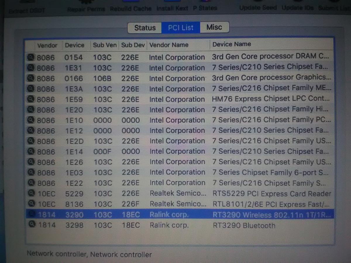

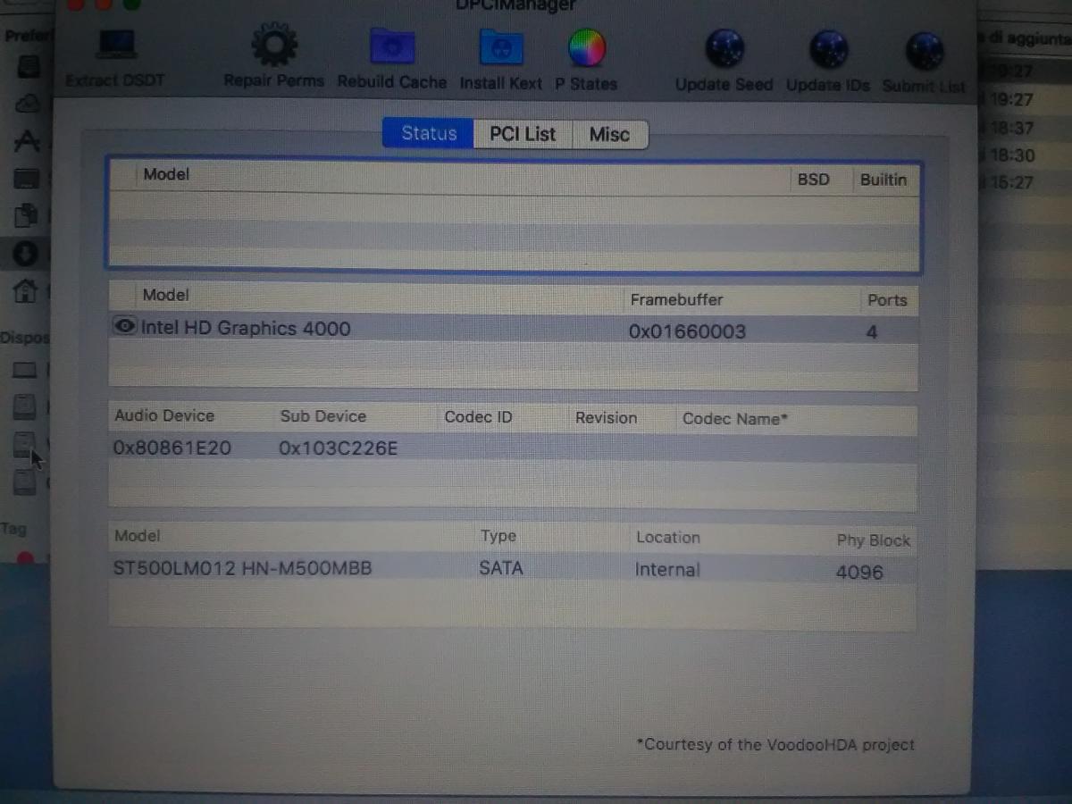

gengik84 Posted July 9, 2017 Share Posted July 9, 2017 Ri-Ciao.... Adesso alla gui di clover premi F4, attendi 15 secondi circa e poi avvia normalmente. Comprimi e posta la cartella clover del dispositivo usato per il boot Scarica DPCIManager.zip, apri l'app, fai foto alla parte Status e PCI list, postale Link to comment https://www.insanelymac.com/forum/topic/325088-installazione-macos-sierra-su-notebook-hp-250-g3/#findComment-2459411 Share on other sites More sharing options...

Fabio29 Posted July 9, 2017 Author Share Posted July 9, 2017 Link to comment https://www.insanelymac.com/forum/topic/325088-installazione-macos-sierra-su-notebook-hp-250-g3/#findComment-2459491 Share on other sites More sharing options...
gengik84 Posted July 9, 2017 Share Posted July 9, 2017 Foto di Pci list e il resto... Link to comment https://www.insanelymac.com/forum/topic/325088-installazione-macos-sierra-su-notebook-hp-250-g3/#findComment-2459492 Share on other sites More sharing options...
Fabio29 Posted July 9, 2017 Author Share Posted July 9, 2017 Il resto cosa? Per il WiFi non posso fare nulla? Link to comment https://www.insanelymac.com/forum/topic/325088-installazione-macos-sierra-su-notebook-hp-250-g3/#findComment-2459494 Share on other sites More sharing options...
gengik84 Posted July 9, 2017 Share Posted July 9, 2017 non è compatibile... il resto intendo la cartella clover dopo aver premuto F4 #2 Link to comment https://www.insanelymac.com/forum/topic/325088-installazione-macos-sierra-su-notebook-hp-250-g3/#findComment-2459495 Share on other sites More sharing options...

gengik84 Posted July 9, 2017 Share Posted July 9, 2017 puoi sostituirlo con uno compatibile oppure usarne uno usb mi sa che non è compatibile gengik sempre sul filo del rasoio Link to comment https://www.insanelymac.com/forum/topic/325088-installazione-macos-sierra-su-notebook-hp-250-g3/#findComment-2459503 Share on other sites More sharing options...
MARZILLO Posted July 9, 2017 Share Posted July 9, 2017 nulla di irreparabile....devi solo cambiare scheda wifi interna con una compatibile Link to comment https://www.insanelymac.com/forum/topic/325088-installazione-macos-sierra-su-notebook-hp-250-g3/#findComment-2459506 Share on other sites More sharing options...
Fabio29 Posted July 9, 2017 Author Share Posted July 9, 2017 Porca vacca... Una compatibile quale potrebbe essere? Link to comment https://www.insanelymac.com/forum/topic/325088-installazione-macos-sierra-su-notebook-hp-250-g3/#findComment-2459509 Share on other sites More sharing options...
MARZILLO Posted July 9, 2017 Share Posted July 9, 2017 beh....non conosco il tuo pc...se è possibile accedere facilmente all'interno tramite sportellino senza smontarlo tutto posta una foto della schedina wifi Link to comment https://www.insanelymac.com/forum/topic/325088-installazione-macos-sierra-su-notebook-hp-250-g3/#findComment-2459510 Share on other sites More sharing options...
gengik84 Posted July 9, 2017 Share Posted July 9, 2017 ti interessa con bluetooth oppure ti basta solo wifi? Link to comment https://www.insanelymac.com/forum/topic/325088-installazione-macos-sierra-su-notebook-hp-250-g3/#findComment-2459513 Share on other sites More sharing options...
MARZILLO Posted July 9, 2017 Share Posted July 9, 2017 consiglio ar5b93 se ti interessa solo il wifi Link to comment https://www.insanelymac.com/forum/topic/325088-installazione-macos-sierra-su-notebook-hp-250-g3/#findComment-2459515 Share on other sites More sharing options...
gengik84 Posted July 9, 2017 Share Posted July 9, 2017 consiglio ar5b93 se ti interessa solo il wifi Ottimo...lavora nativamente.... e va bene perché anche il suo è mini pci-e Sottolineamo che è solo wifi Link to comment https://www.insanelymac.com/forum/topic/325088-installazione-macos-sierra-su-notebook-hp-250-g3/#findComment-2459519 Share on other sites More sharing options...
