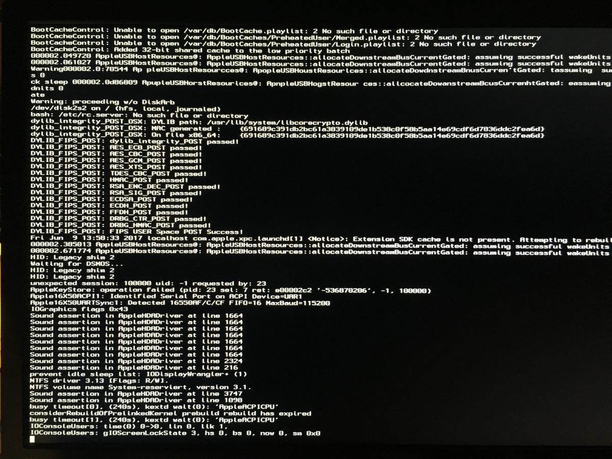

Deep_Thought Posted June 9, 2017 Share Posted June 9, 2017 Hi guys, I'm trying to do a fresh install of Sierra on my system: Z87-G43 board, i7 4770K CPU, R9 290X GPU, 32GB RAM. I had Yosemite running for some time now and wanted to upgrade. Alas, no luck. I created an UEFI USB installer from the Sierra app and added Clover to the USB drive. Clover is configured for installation on UEFI boards and I use the OsxAptioFix2Drv-64. Otherwise, the system won't even start the installation process from the USB drive. Booting the USB drive works, then the installation starts. The designated macOS drive is an SSD in GUID format. First reboot, booting from USB again but this time I tell clover to continue from the macOS SSD. Installation continues for a while. Second reboot, again booting from USB and telling clover to continue from macOS SSD. This time the system hangs after a while, complaining about a timeout at "AppleACPICPU" (see attached image). Did anybody have this problem and solve it? Is there a way to install Sierra on the Z87-G43? Any help is appreciated! Link to comment https://www.insanelymac.com/forum/topic/324332-anybody-managed-to-install-sierra-on-an-msi-z87-g43-board/ Share on other sites More sharing options...

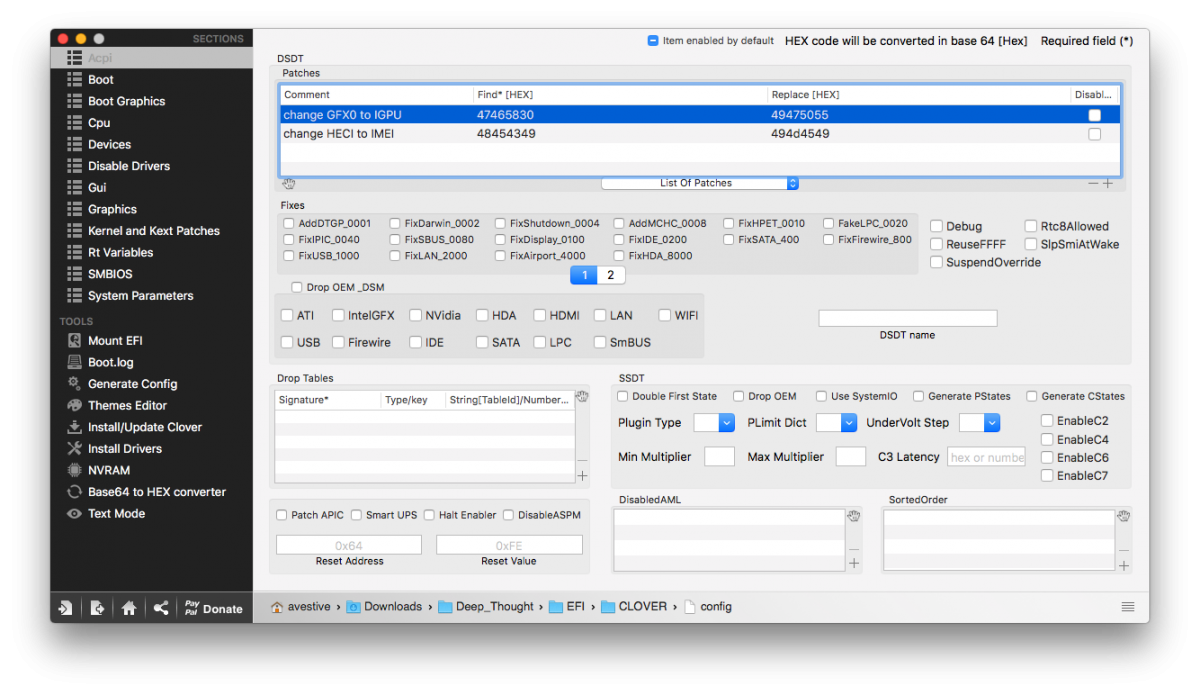

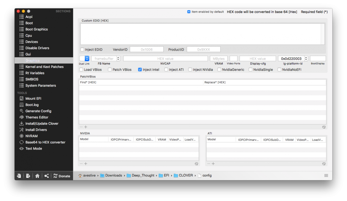

Cyberdevs Posted July 16, 2017 Share Posted July 16, 2017 I added the proper intel hd 4600 info in the config.plist I also added the ACPI patches for the iGPU Here is the revised version of your EFI folder with all the necessary kexts and settings. Enjoy EFI-Edited.zip 1 Link to comment https://www.insanelymac.com/forum/topic/324332-anybody-managed-to-install-sierra-on-an-msi-z87-g43-board/#findComment-2464078 Share on other sites More sharing options...
