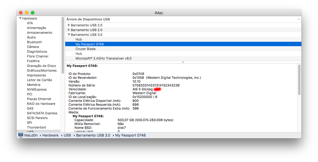

MaLd0n Posted June 5, 2017 Share Posted June 5, 2017 send me new ioreg, need check things there use device USB3 in USB3 port, and check if speed is 5gb Link to comment https://www.insanelymac.com/forum/topic/324125-asus-h87m-plus-installed-sierra-10125-but-how-do-i-know-its-successful/#findComment-2435970 Share on other sites More sharing options...

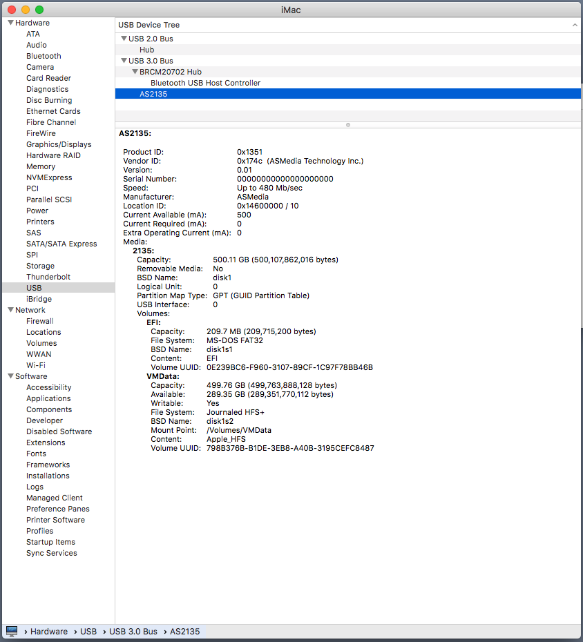

chrischuah Posted June 6, 2017 Author Share Posted June 6, 2017 Hi From the USB 3.0 hub, i can only get 480 mb/s as shown in the diagram below attached is the IOReg output. please help. thanks chris IOReg_AsusH87m_plus_3.zip 1 Link to comment https://www.insanelymac.com/forum/topic/324125-asus-h87m-plus-installed-sierra-10125-but-how-do-i-know-its-successful/#findComment-2436029 Share on other sites More sharing options...
MaLd0n Posted June 6, 2017 Share Posted June 6, 2017 ioreg is good u connect device usb3 in usb3 port? Link to comment https://www.insanelymac.com/forum/topic/324125-asus-h87m-plus-installed-sierra-10125-but-how-do-i-know-its-successful/#findComment-2436038 Share on other sites More sharing options...

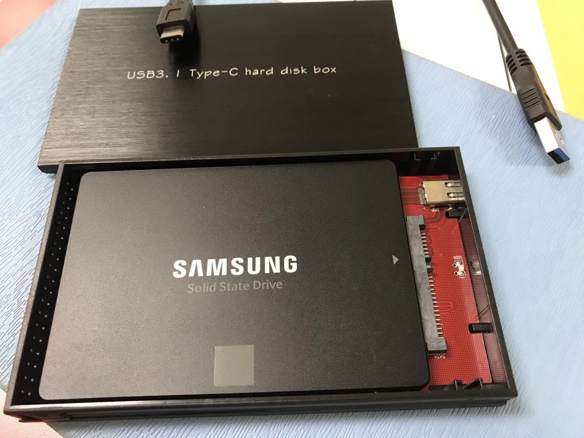

chrischuah Posted June 6, 2017 Author Share Posted June 6, 2017 Well, this is supposed to be a 3.1 Type C USB hard disk but it is only going at 48 MB per sec at the picture shown in the previous post please advise thanks chris 1 Link to comment https://www.insanelymac.com/forum/topic/324125-asus-h87m-plus-installed-sierra-10125-but-how-do-i-know-its-successful/#findComment-2436057 Share on other sites More sharing options...
