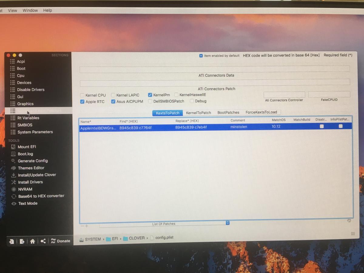

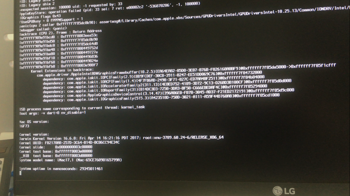

alexteste Posted May 26, 2017 Share Posted May 26, 2017 Hey Guys! I really stuck after 2 days trying to fix the Intel graphics problem. I'm an Desktop with Intel core i5 5500u + Intel Graphics HD 5500 using MacOS Sierra Instalation using [url="http://www.insanelymac.com/forum/topic/279450-why-insanelymac-does-not-support-tonymacx86/"]#####[/url]. I followed those 2 topics http://www.insanelymac.com/forum/topic/312579-patch-dvmt-allocation-intel-hd5500-broadwell-not-found-at-sierra http://www.insanelymac.com/forum/topic/315118-intel-hd-5500-bios-lock-dvmt-kernel-panic-at-sierra-gm/ Made everything and I keep getting this Kernel Panic! Attached my clover configuration and the image of kernel panic. Please, help me, I need the PC up to start work Thank you guys! Link to comment https://www.insanelymac.com/forum/topic/323969-intel-hd-5500-sierra-panic-even-after-patch/ Share on other sites More sharing options...
Allan Posted May 26, 2017 Share Posted May 26, 2017 Hi, and welcome to InsanelyMac FYI we don't give support for Tonymac tools: VERY IMPORTANT: PLEASE READ! (ABOUT TONYMACX86 AND iATKOS M / Y / EC / SR) Why InsanelyMac does not support tonymacx86 Tip for your issue: This IGPlatform value, is for Mobiles, maybe you need find a value for Desktops. In IvyBridge CPUs we have these differences, don't know if in the lines above remains the same. Link to comment https://www.insanelymac.com/forum/topic/323969-intel-hd-5500-sierra-panic-even-after-patch/#findComment-2431322 Share on other sites More sharing options...
fivos1996 Posted June 18, 2017 Share Posted June 18, 2017 You have a desktop with a laptop CPU. Your ig-platform-id is correct. Try this patch too: Kext name: com.apple.driver.AppleIntelBDWGraphicsFramebuffer Find: 00002002 00005001 Replace: 00003001 00009000 MatchOS: 10.12.x Please note that it's a better idea to change the DVMT pre-allocated memory to 96MB istead of patching the framebuffer. 1 Link to comment https://www.insanelymac.com/forum/topic/323969-intel-hd-5500-sierra-panic-even-after-patch/#findComment-2447072 Share on other sites More sharing options...
