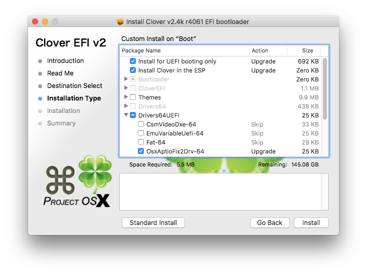

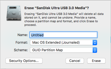

Cyberdevs Posted May 16, 2017 Share Posted May 16, 2017 Good, 1. Download the latest macOS Sierra from App Store if you already didn't download it. 2. Prepare a 16 GB Flash disk, format it using "Disk Utility" Select Mac OS X Extended (Journaled) and from Scheme select: "GUID Partition Map" and leave the Name as "Untitled" 3.Open Terminal and run the following command: sudo /Applications/Install\ macOS\ Sierra.app/Contents/Resources/createinstallmedia --volume /Volumes/Untitled --applicationpath /Applications/Install\ macOS\ Sierra.app --nointeraction 4.Download clover bootloader from: https://sourceforge.net/projects/cloverefiboot/ 5. Once your USB disk is ready it's now time to make it bootable by installing clover on it. 6. Install clover bootloader and select the following items by clicking "Customize" button and then click install. 7. After installation is done you'll need to add some extra files and settings to your /EFI/Clover folder. 8. Once you successfully installed macOS we'll continue to make the necessary adjustments. Link to comment https://www.insanelymac.com/forum/topic/323670-asus-p8z77-v-lx-intel-i5-3450-asus-gtx-460-1-go/#findComment-2424450 Share on other sites More sharing options...

Cyberdevs Posted May 16, 2017 Share Posted May 16, 2017 In order to install macOS you need to format the hard disk just like the picture I posted earlier, "Format: Mac OS X Extended (Journaled)" and "Scheme: GUID Partition Map" but remember to backup your data if you have any. If you have more than one partition on the disk make sure you backup them as well because it will ease all partitions on the disk. You also need to configure your BIOS settings to specific settings required for Mac OS to run: Load Optimized Defaults SATA Configuration must be set to AHCI VT-d must be disabledDisable Secure Boot ModeSet OS Type to Other OSDisable SerialPort or Serial IOSet XHCI Handoff to Enabled EHCI Hand-off must be enabled Set Primary Display to PCIE Disable iGPU if it's enabled Set Boot Device Control UEFI only Set Boot from Storage Devices to UEFI driver first Once you saved the new settings save and reboot and press F8 for Boot Menu and then select the UEFI USB Disk you created and let's hope you boot into macOS installer Link to comment https://www.insanelymac.com/forum/topic/323670-asus-p8z77-v-lx-intel-i5-3450-asus-gtx-460-1-go/#findComment-2424480 Share on other sites More sharing options...

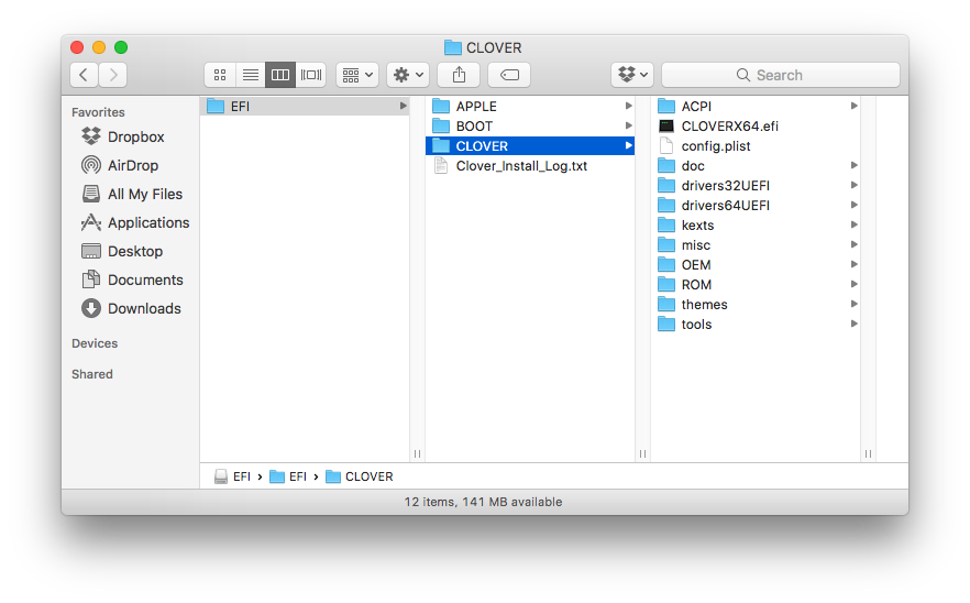

Cyberdevs Posted May 16, 2017 Share Posted May 16, 2017 When your disk is created, mount the EFI partition and copy the EFI folder I posted into the root of the EFI partition. The EFI partition must look like this: Link to comment https://www.insanelymac.com/forum/topic/323670-asus-p8z77-v-lx-intel-i5-3450-asus-gtx-460-1-go/#findComment-2424533 Share on other sites More sharing options...
