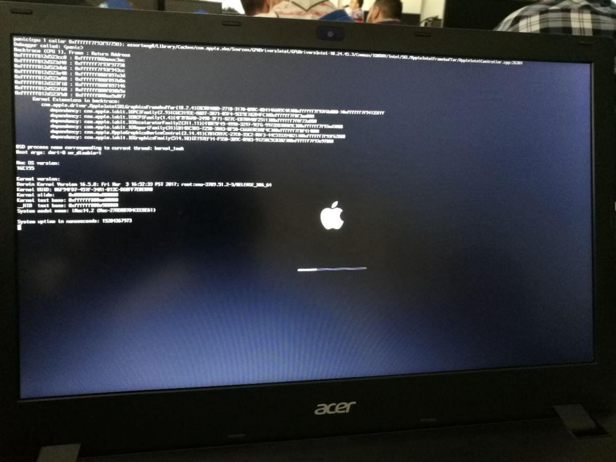

luigi.darco Posted May 3, 2017 Share Posted May 3, 2017 Salve a tutti, sto provando a installare sierra su un acer f5-572g ma ottengo errori all'avvio dell'installazione. Potete aiutarmi? Vi allego una foto dell'errore Link to comment https://www.insanelymac.com/forum/topic/323364-installazione-sierra-su-acer-f5-572g/ Share on other sites More sharing options...
gengik84 Posted May 3, 2017 Share Posted May 3, 2017 FakeID/IntelGFX metti 0x12345678 Puoi farlo anche tramite la cui di clover Link to comment https://www.insanelymac.com/forum/topic/323364-installazione-sierra-su-acer-f5-572g/#findComment-2416670 Share on other sites More sharing options...

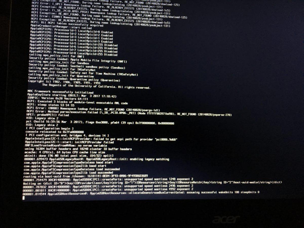

luigi.darco Posted May 8, 2017 Author Share Posted May 8, 2017 Si blocca così Link to comment https://www.insanelymac.com/forum/topic/323364-installazione-sierra-su-acer-f5-572g/#findComment-2419814 Share on other sites More sharing options...
gengik84 Posted May 8, 2017 Share Posted May 8, 2017 avvia in verbose e posta la foto Link to comment https://www.insanelymac.com/forum/topic/323364-installazione-sierra-su-acer-f5-572g/#findComment-2419817 Share on other sites More sharing options...

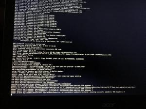

luigi.darco Posted May 8, 2017 Author Share Posted May 8, 2017 Ecco Link to comment https://www.insanelymac.com/forum/topic/323364-installazione-sierra-su-acer-f5-572g/#findComment-2419824 Share on other sites More sharing options...
gengik84 Posted May 8, 2017 Share Posted May 8, 2017 Riprova..CLOVER.zip Link to comment https://www.insanelymac.com/forum/topic/323364-installazione-sierra-su-acer-f5-572g/#findComment-2419830 Share on other sites More sharing options...

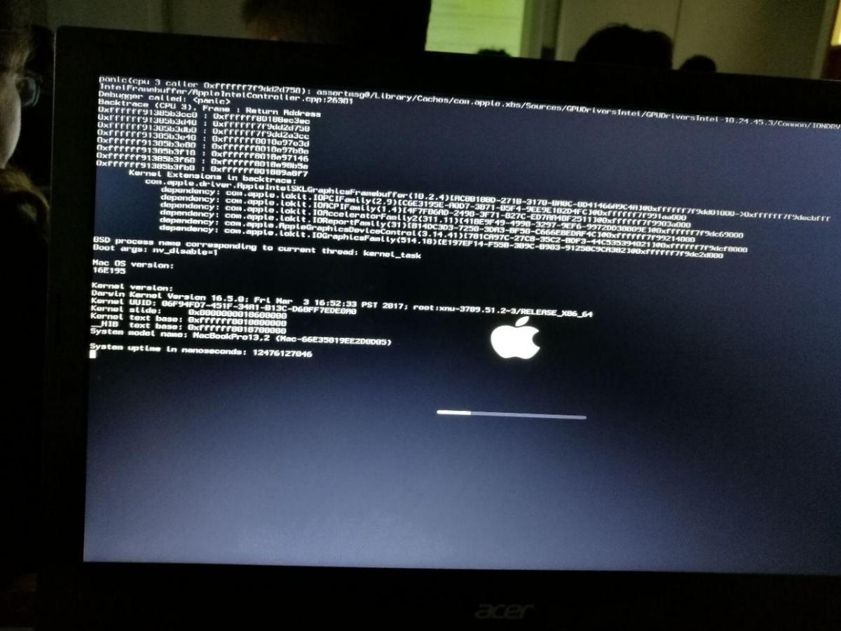

luigi.darco Posted May 8, 2017 Author Share Posted May 8, 2017 Niente ancora Link to comment https://www.insanelymac.com/forum/topic/323364-installazione-sierra-su-acer-f5-572g/#findComment-2419853 Share on other sites More sharing options...
gengik84 Posted May 8, 2017 Share Posted May 8, 2017 con questa cartella clover, fai la procedura alla gui, inserendo su Graphics/FakeID -> 0x12345678 Link to comment https://www.insanelymac.com/forum/topic/323364-installazione-sierra-su-acer-f5-572g/#findComment-2419856 Share on other sites More sharing options...
luigi.darco Posted May 8, 2017 Author Share Posted May 8, 2017 Niente Link to comment https://www.insanelymac.com/forum/topic/323364-installazione-sierra-su-acer-f5-572g/#findComment-2419862 Share on other sites More sharing options...
gengik84 Posted May 8, 2017 Share Posted May 8, 2017 Sostituisci: config.plist.zip Link to comment https://www.insanelymac.com/forum/topic/323364-installazione-sierra-su-acer-f5-572g/#findComment-2419874 Share on other sites More sharing options...

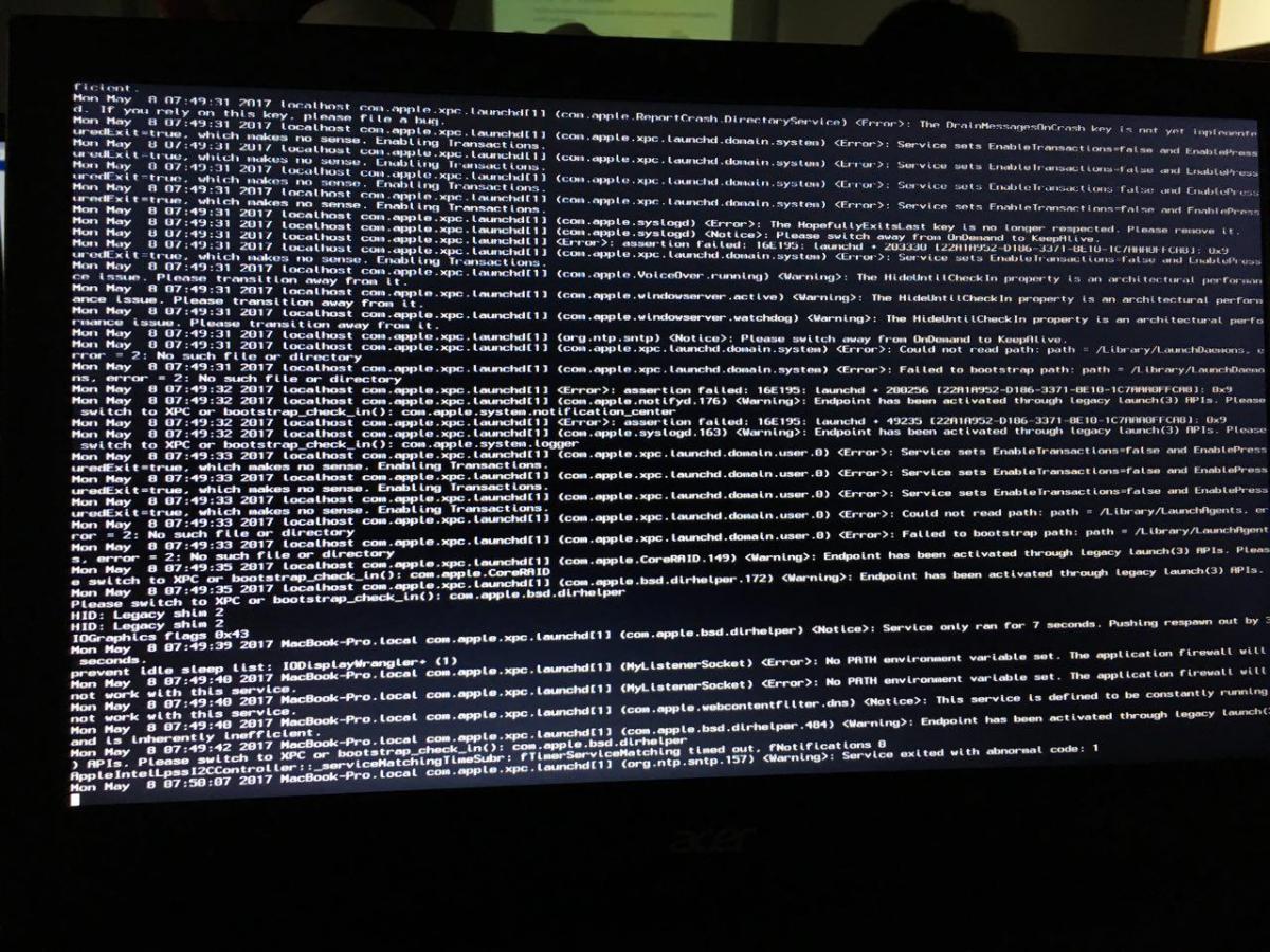

luigi.darco Posted May 9, 2017 Author Share Posted May 9, 2017 Ho aggiunto le specifiche in firma Ho provato con il config.plist postatomi da gengik ma non funziona Link to comment https://www.insanelymac.com/forum/topic/323364-installazione-sierra-su-acer-f5-572g/#findComment-2420354 Share on other sites More sharing options...
gengik84 Posted May 9, 2017 Share Posted May 9, 2017 Sostituisci la EFI con quella allegata... Nel caso, posta la foto del blocco del verbose EFI.zip Link to comment https://www.insanelymac.com/forum/topic/323364-installazione-sierra-su-acer-f5-572g/#findComment-2420369 Share on other sites More sharing options...
Jolly Posted May 9, 2017 Share Posted May 9, 2017 Ti era stato richiesto a quanto hai settato la DVMT nel bios, è importante e visto che apparentemente hai uno schermo 1920 dovrebbe essere a 128, da provare eventualmente anche 96. Utile sapere anche come hai configurato il bios nel suo complesso. Link to comment https://www.insanelymac.com/forum/topic/323364-installazione-sierra-su-acer-f5-572g/#findComment-2420468 Share on other sites More sharing options...
