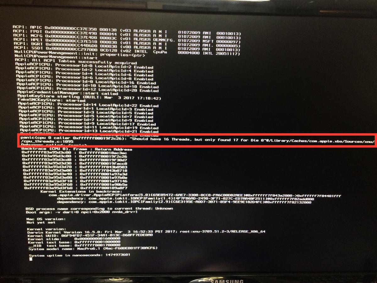

carbo178 Posted May 4, 2017 Share Posted May 4, 2017 The problem is described in the panic screen, you have to delete the excess lines relating to processors in the DSDTTry the DSDT attached (renamed DSDT.aml), i've added all the patches described in my guide.Put in Clover/ACPI/PatchedP.S. change smbios from MacPro 6.1 to MacPro 5.1 if you have graphics problemsSorry for my english DSDT-Lidiano.aml.zip 3 Link to comment https://www.insanelymac.com/forum/topic/323150-asus-p9x79-xeon-e5-2680-v2-help/page/2/#findComment-2417723 Share on other sites More sharing options...

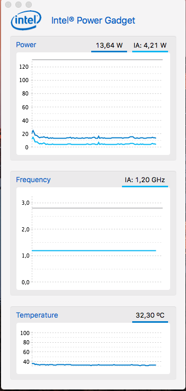

lidiano Posted May 5, 2017 Author Share Posted May 5, 2017 Thanks to the dsdt done by carbo178 I managed to start the computer, but now I have the processor frequency that stays as you see in the picture That thanks to you we are almost Link to comment https://www.insanelymac.com/forum/topic/323150-asus-p9x79-xeon-e5-2680-v2-help/page/2/#findComment-2417975 Share on other sites More sharing options...
MARZILLO Posted May 5, 2017 Share Posted May 5, 2017 did you do ssdt? hai fatto l'ssdt? Link to comment https://www.insanelymac.com/forum/topic/323150-asus-p9x79-xeon-e5-2680-v2-help/page/2/#findComment-2417979 Share on other sites More sharing options...
lidiano Posted May 5, 2017 Author Share Posted May 5, 2017 no I do not know how to do it Link to comment https://www.insanelymac.com/forum/topic/323150-asus-p9x79-xeon-e5-2680-v2-help/page/2/#findComment-2417981 Share on other sites More sharing options...

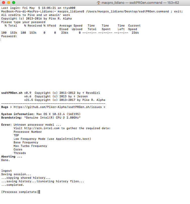

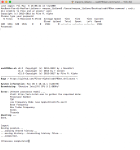

MaLd0n Posted May 5, 2017 Share Posted May 5, 2017 Only 1.2 Ghz? U generate Pike SSDT? ssdtPRGen.command.zip Audio ok? 2 Link to comment https://www.insanelymac.com/forum/topic/323150-asus-p9x79-xeon-e5-2680-v2-help/page/2/#findComment-2417982 Share on other sites More sharing options...
MARZILLO Posted May 5, 2017 Share Posted May 5, 2017 vai qui go here http://www.macos86.com/t42-come-creare-il-proprio-ssdt-per-il-power-management-script-di-piker Link to comment https://www.insanelymac.com/forum/topic/323150-asus-p9x79-xeon-e5-2680-v2-help/page/2/#findComment-2417985 Share on other sites More sharing options...
lidiano Posted May 5, 2017 Author Share Posted May 5, 2017 Only 1.2 Ghz? U generate Pike SSDT? ssdtPRGen.command.zip Audio ok? I do not know if I did it right Audio ok Link to comment https://www.insanelymac.com/forum/topic/323150-asus-p9x79-xeon-e5-2680-v2-help/page/2/#findComment-2417991 Share on other sites More sharing options...
