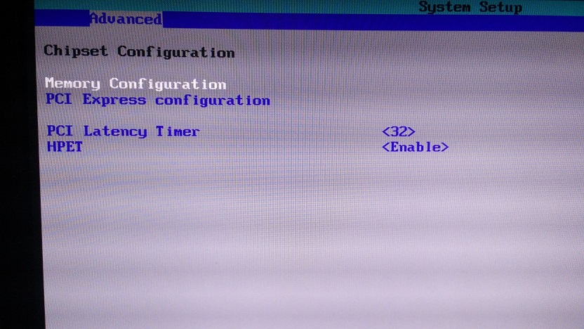

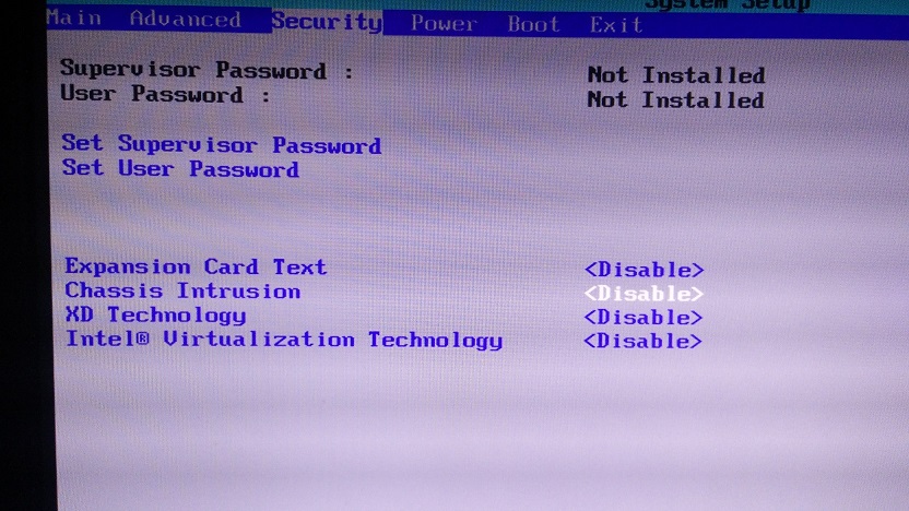

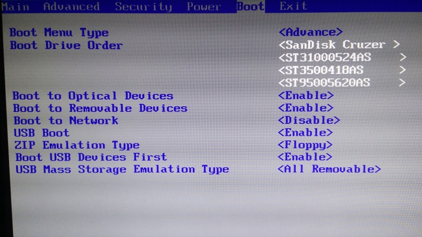

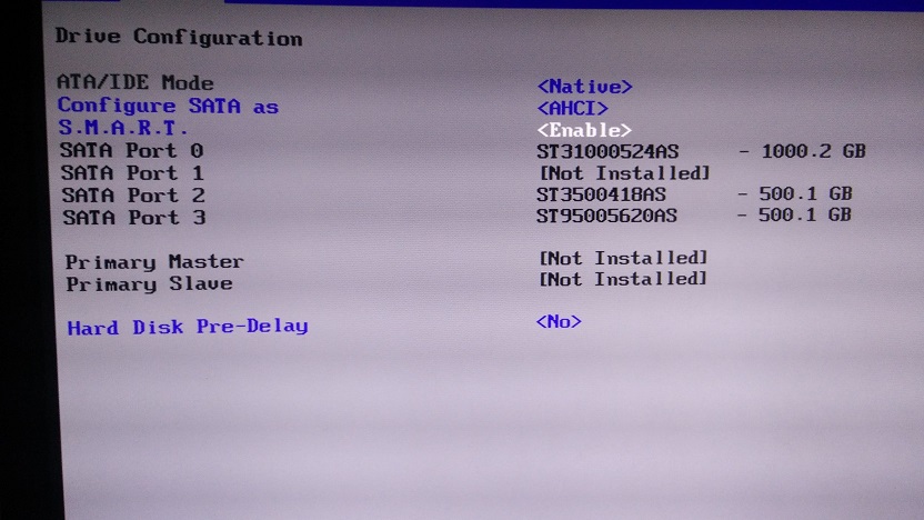

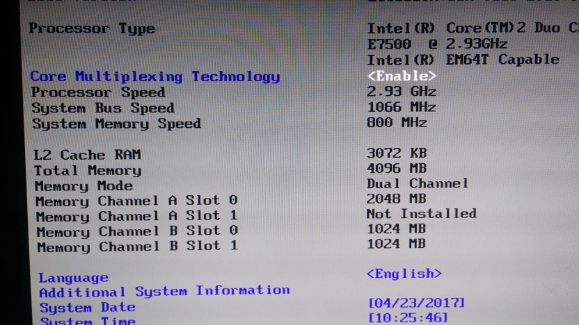

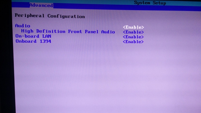

BhooshanAJ Posted April 23, 2017 Share Posted April 23, 2017 So, I have tired everything that I could. The usb doesn't boot. My computer goes straight to GRUB for my Windows/Fedora booting. My PC: Intel E7500 Intel DG35EC Mobo nVidia 9400 GT SATA Hard disks 6 GB DD2 800 Mhz RAM Tried so far: --- Transmac with : - Yosemite Disto - Vanilla Sierra - Vanilla El Capitan Pandora's Box - Using DMG - Using "Install Sierra App" downloaded from App Store. - Enoch Chamelon. Ares. Clover - All kinds of configuration for Legacy booting. boot flag -v, MacPwn Flash Driver Maker and then Clover. Restore method and then Clover. Tried the "one that cannot be named here" too. No go. Since I am running this stuff on a VMWare Sierra on Windows 8.1 Kexts I have tried. - FakeFMC.kext - NullCPUPowerManagement.kext - VoodooPS2Controller.kext(that ones for PS2 mouse. Don't ask why. I am obsessed with it.) MaLd0n's Clover folder had - USBInjectAll.kext - IntelMausiEthernet.kext - HDMIAudio.kext - AppleALC.kext Here are my BIOS settings. Any ideas people? I have seen people posting about their successful Hackintoshes on Yosemite and Lions etc on Machines similar to mine if not the same. So it can be done. It doesn't HAVE to be Sierra. I will be happy with Yose or El Cap too. Link to comment https://www.insanelymac.com/forum/topic/323118-usb-doesnt-boot/ Share on other sites More sharing options...

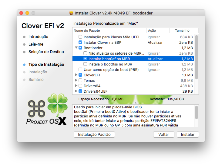

MaLd0n Posted April 23, 2017 Share Posted April 23, 2017 Create a new usb stick bootable Use it Flash Drive Maker.zip After Instal Clover in usb stick with these options https://sourceforge.net/projects/cloverefiboot/files/Installer/Clover_v2.4k_r4049.zip/download Use 4049, new version , many problems Use it CLOVER.zip Link to comment https://www.insanelymac.com/forum/topic/323118-usb-doesnt-boot/#findComment-2410772 Share on other sites More sharing options...

BhooshanAJ Posted April 30, 2017 Author Share Posted April 30, 2017 @chris1111. Oh. No. Just what I was using. But it couldn't complete. 1) My mouse is still not working even with VoodoPS2Controller. 2) When I choose the language on the setup. It says "MacOS cannot be installed on my system" and gives me a button to "Restart" Also . Apparently it wasnt just the UseKernelCache flag. Its the VT-d and XDT on my BIOS. It needs to ENABLED. Odd. All guides I have read ask me to disable VT-d but here...the USB reboots if I disable it. @chris1111. Will try your Extra and see if that changes anything. Link to comment https://www.insanelymac.com/forum/topic/323118-usb-doesnt-boot/#findComment-2414855 Share on other sites More sharing options...
