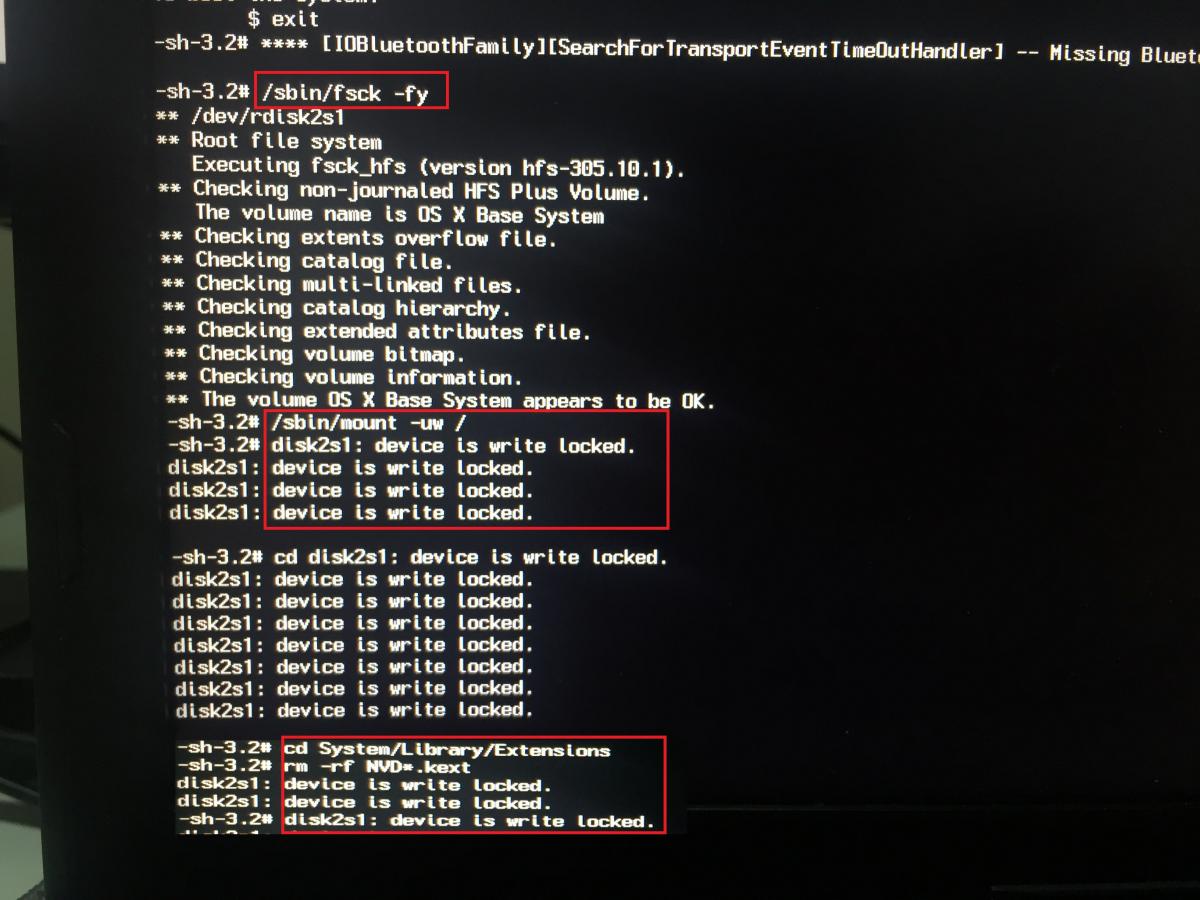

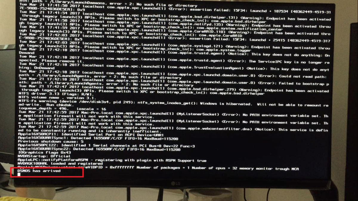

ho520726 Posted March 22, 2017 Share Posted March 22, 2017 I followed the instruction of http://www.insanelymac.com/forum/topic/314799-guide-z820-el-capitan-the-great-guide-sucess/ I use all his kext and config file. I still stuck in the "DSMOS has arrived". After this msg show up, my screen goes black... I think that may be my display card problem.. I have no IGP like HD4600. I don't how to do. I try to fix the problem with booting to -s single user mode to delete all the nvidia kext in the System/Library/Extensions folder, but after I enter the command /sbin/fsck -fy and /sbin/mount -uw / .. It prompt out the msg: device is write locked. I can't remove the nvidia kext. my computer spec: cpu: dual e5-2670 display: GTX 780TI (which is not same as the guide I follow) montherboard: Z820 MB X79 Sorry for my bad english. Link to comment https://www.insanelymac.com/forum/topic/322097-help-with-dsmos-has-arrived/ Share on other sites More sharing options...
gengik84 Posted March 22, 2017 Share Posted March 22, 2017 boot with nv_disable=1 Link to comment https://www.insanelymac.com/forum/topic/322097-help-with-dsmos-has-arrived/#findComment-2389403 Share on other sites More sharing options...
ho520726 Posted March 27, 2017 Author Share Posted March 27, 2017 thanks for help. it work. Link to comment https://www.insanelymac.com/forum/topic/322097-help-with-dsmos-has-arrived/#findComment-2392443 Share on other sites More sharing options...
