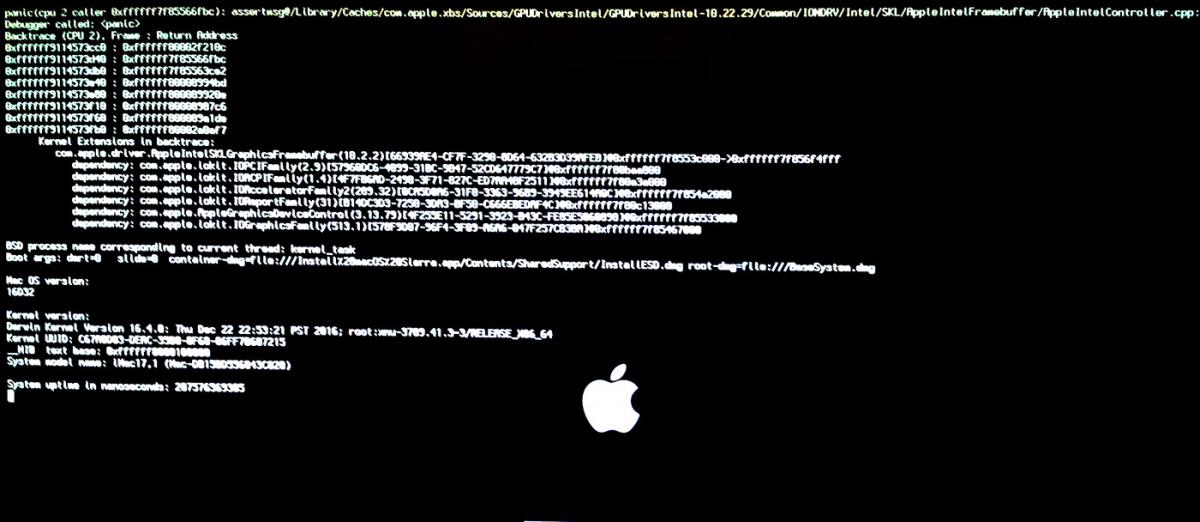

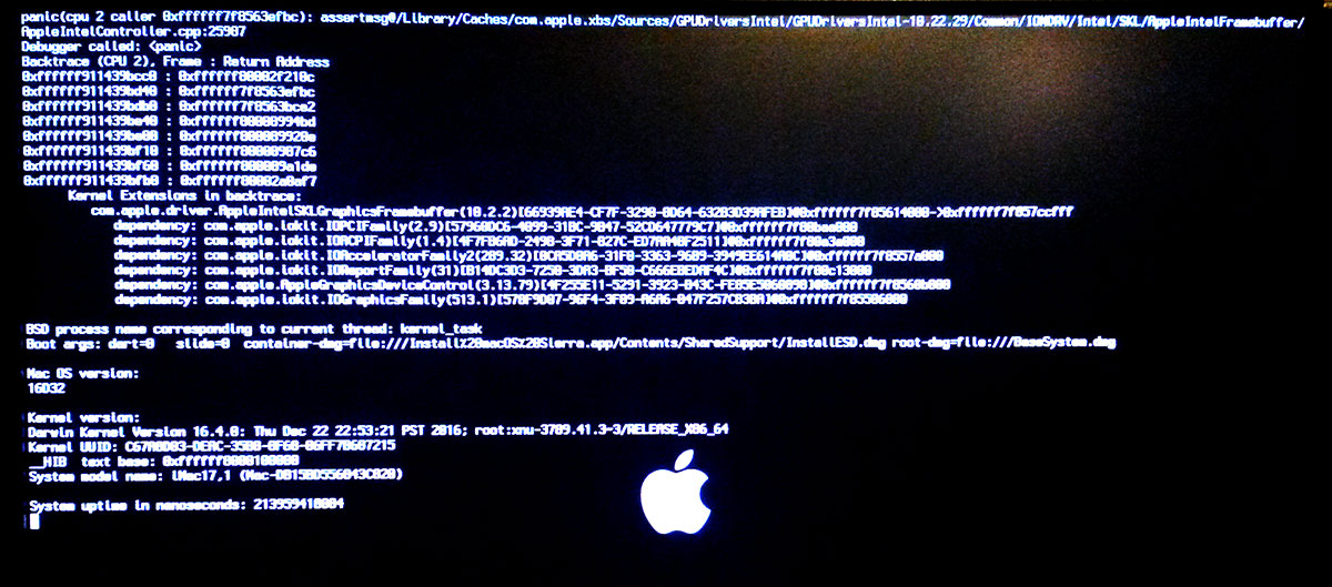

zeg66 Posted March 27, 2017 Author Share Posted March 27, 2017 after a very long time I get a kp saying: AppleIntelController.cpp:25987 com.apple.driver.AppleIntelSKLGraphicsFramebuffer(10.2.2)..... do you want the picture? :-) Quote Link to comment Share on other sites More sharing options...
MaLd0n Posted March 27, 2017 Share Posted March 27, 2017 u use onboard graphics or nvidia? Quote Link to comment Share on other sites More sharing options...
zeg66 Posted March 27, 2017 Author Share Posted March 27, 2017 I use onboard HD530 on the i3-6100 cpu and the monitor is connected to the VGA port on the motherboard (not sure if that is important) Quote Link to comment Share on other sites More sharing options...
MaLd0n Posted March 27, 2017 Share Posted March 27, 2017 vga dont work, use hdmi or dvi Quote Link to comment Share on other sites More sharing options...
zeg66 Posted March 27, 2017 Author Share Posted March 27, 2017 ok I connected a DVI monitor, but....same kp. the installer goes very slowly because there is a very long list of <Warning> and <Error> messages: com.apple.xpc.launchd[1]... is that relevant? picture: Quote Link to comment Share on other sites More sharing options...
MaLd0n Posted March 27, 2017 Share Posted March 27, 2017 try it config.plist.zip if dont work set DVMT in bios to 64 or 96 1 Quote Link to comment Share on other sites More sharing options...

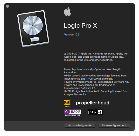

zeg66 Posted March 27, 2017 Author Share Posted March 27, 2017 Yes of course I will send you the files. WHEN it finishes, ha ha.... Wow Logic 10.3.1 !! Motherboard is Asus H110M-E D3 (about 2 minutes remaining so....about 20) Quote Link to comment Share on other sites More sharing options...
